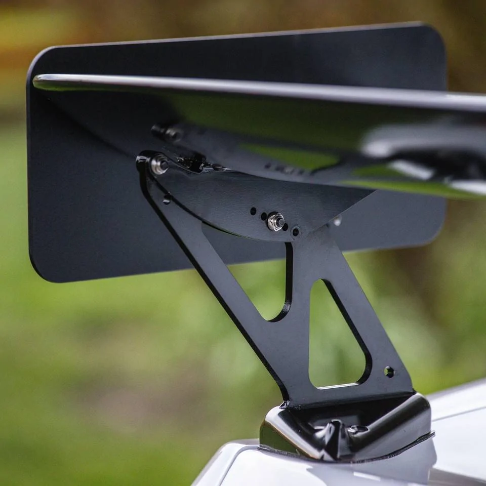

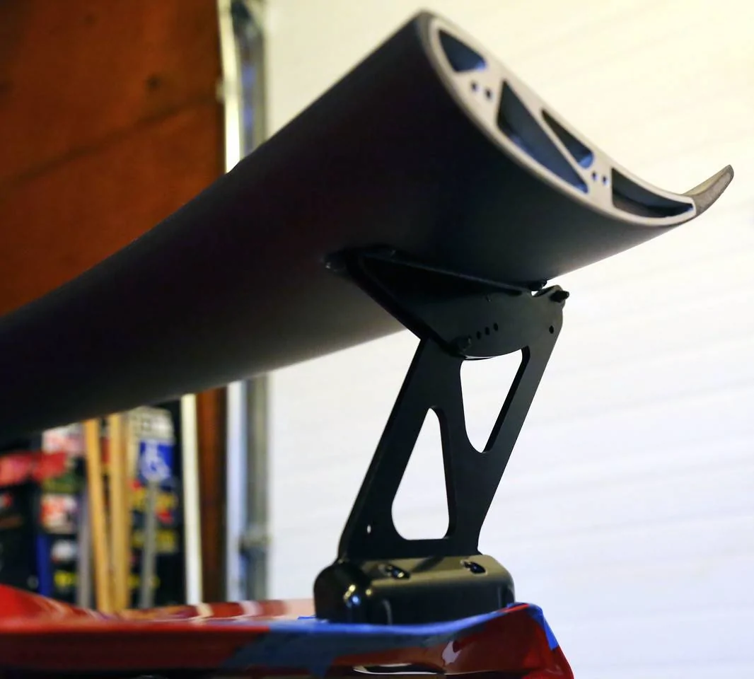

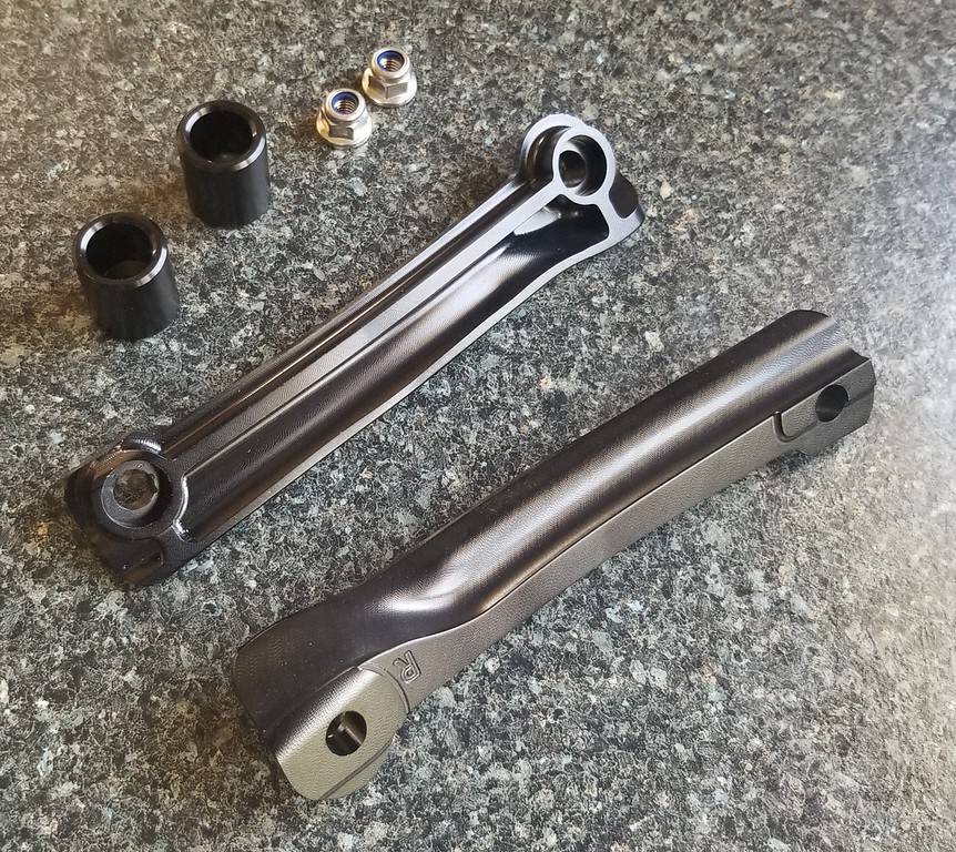

Are those knockoff aftermarket or are they a well known manufacturer?
I do have a sneaky suspicion that whoever the manufacturer of the aluminum mounts is, did so for a very good reason. I also suspect that may be the way I'd want to do a second wing if it is indeed superior.
The uprights and wing are both from the same company, the one that makes both the GT4 Mustangs as well as the Ford GT.:) No knockoffs here!
Regarding the material used for the base and upright 6061-T6 aluminum. It's what I would have chosen even if I could have had them in chopped fiber for the same price. Don't get me wrong, the CFTP mounts are gorgeous and an engineering marvel. But the cost and ability to reproduce them if I had to...not my cup of tea. At least until I hit the lottery, that is.
The upright base itself is a beautifully optimized and machined foundation from which to build upon. The upright "ladder" section is 6061-T6 as well, and it fits into a machined slot in the base and is then TIG welded along its perimeter underneath, and in a couple of small spots above.
Note the base and ladder portion...

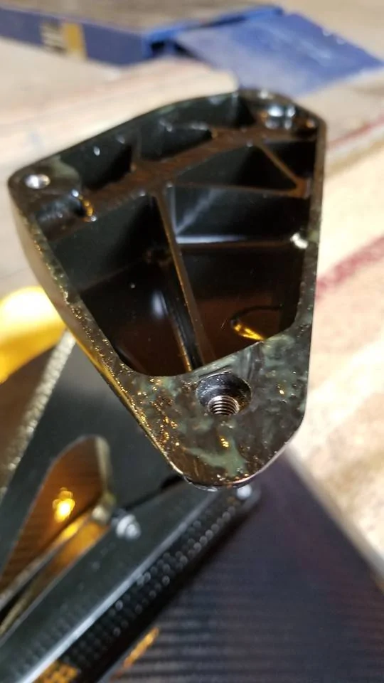

From underneath, when I was cutting up some rubber gaskets (that's actually the one for the other side, scuffed up for better adhesion). Anyway, you can see the weld stringer that fuses the two pieces together...
The portion at the top of the ladder section (that attaches to the wing itself from the underside) is actually steel - uncertain of the alloy. I prefer this to the CFTP interface at this juncture as it places the ladder section in double shear (vs single shear on the CFTP mount). Overkill? Maybe. But I'm good like that.

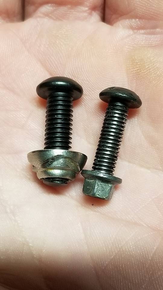

The one thing I wasn't fond of with the GT4 wing was some of the fastener sizes chosen. Calcs may show them to have been adequate but I preferred at least an M6 whereas the wing came with much smaller fasteners. I drilled (and tapped where necessary) and used "tamper-proof-ish" fasteners anywhere where they were exposed.
Regarding the gaskets I cut, again I used a reinforced rubber sheet that was or fairly high durometer so it wouldn't compress unevenly.
Two way cement worked very well in bonding the rubber to the base and the gasket will hopefully minimize the potential for any water intrusion via the holes in the decklid that I didn't close up. If any water/condensate does get in between there at least it can exit via those holes too.
All in all, I'm a huge fan of the GT4 mounts from a strength and aesthetic aspect. Tweaked to minimize airflow disruption too. It is minimalist yet very robust. To some maybe not as pretty as the shorter uprights used on the CFTP cars but I'm fine with that.
To the OP, sorry if this has gone a bit off the rails but if I may plead my case. This wing is the result of all the development work that originally went into the fixed wing on the race version of the Ford GT (the airfoil, anyway). It was then optimized for the GT4 car. The engineers that put the CFTP GT500 program together, used this wing to model a more "street friendly" version that while toned down a little, gets the job done. And with a Class A finish to boot whereas the GT4 hardware is more race-oriented (note the adjustable end plates too).
The engineers used the GT4 version you see here early on in development, albeit at a lower elevation...
I learned early on before it went public that Ford planned on using a GT4 wing variant on some version of the GT500 and spoke of it as soon as Ford let it slip (unknowingly) to others at Ford. When a development car showed up in the track parking lot at Mid-Ohio for some IMSA races it was no longer a secret that couldn't be shared.
https://www.mustang6g.com/forums/th...ood-vents-up-close.103491/page-4#post-2243728
I still can't believe they used this wing on a production Mustang.
Interesting that the dogbones used on the GT350R are the exact same pieces that are used on the GT4 race wing and are now used on the CFTP wing as well. Ford was never known for commonality when there should have been but thankfully we see it here. Too bad they are so difficult to obtain from Ford or at a reasonable price. So thanks for the aftermarket here for stepping up to the plate in this regard.
And Jaime, I've seen you mention talk from Shelby regarding the hood you have on your wide body and that they told you it was at one time in the works for the GT500. Well that again comes from the GT4 car and the desire to take advantage of the better aero (reducing hood lift was one of a number of goals). While the GT4 CF hood itself was never seriously considered (cost) the functionality was not going to be let go. That black development car sported one that showed just how beneficial it was in testing (as much as the GT4 program had already shown that)...
Sorry for some long winded explanations but a little background never hurt anybody (aside from modern sensitivities). Personally, I see potential where others may see limitation. I see the S550 as a shell and make changes to it as I see fit. I wanted the GT4 wing from the moment I saw one up close at Road Atlanta in 2017. I've had a factory rear seat delete in my last two Shelby's and added one to this one too. Others have their own druthers in this regard and I think that is great. So for you guys seeking out an OEM wing or an aftermarket version I'm excited for you and looking forward to seeing how it works out for you too.

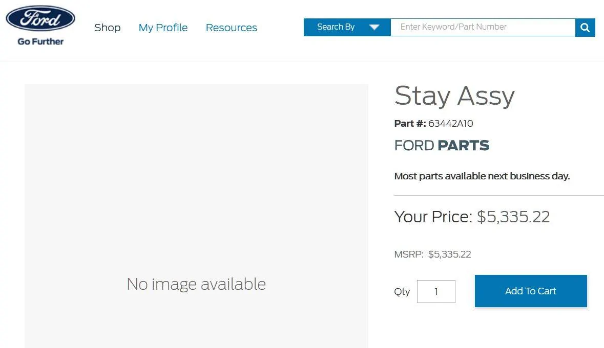

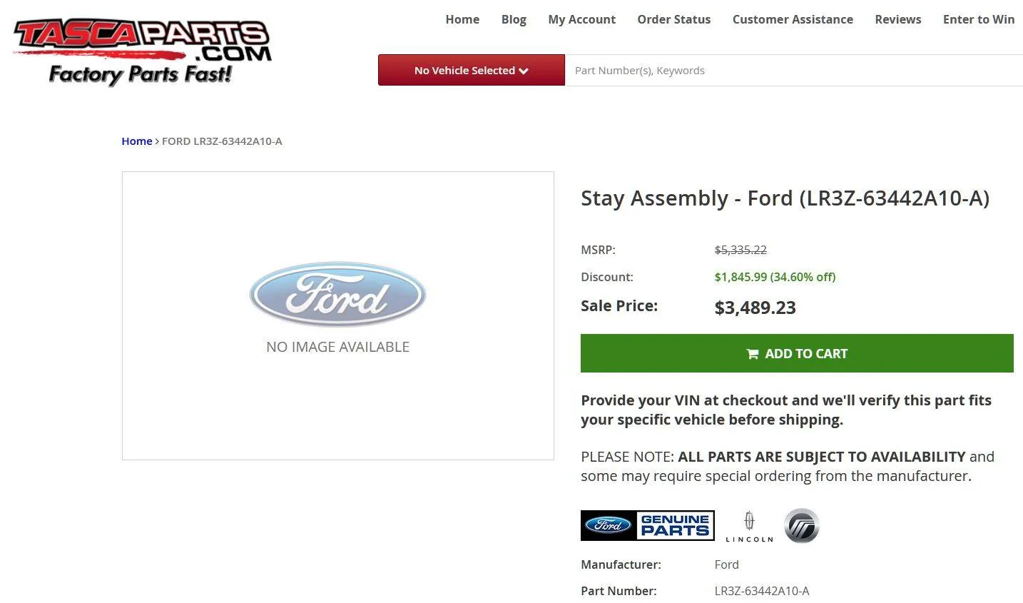

My one and only point to the OP was to point out that the ones that come the OEM wing are painted crushed carbon fiber, and unobtainable, and are one of the things that makes the factory wing different from a replica.
Interestingly enough, the chopped fiber mounts/uprights the factory uses on the CFTP wing are available. Typical of Ford Parts and Service lingo, they use terminology that doesn't help the typical parts guy or the average consumer find what they are looking for. Per SSM 49326, "2020 Mustang GT500 vehicles are equipped with rear (wing) supports that anchor the rear (wing) to the decklid. These supports are now available to be purchased separately from the rear (wing). Part number LR3Z-63442A10-A includes both (wing) supports to service one vehicle."
Ford Retail...
Tasca's price (as an example of a reasonable vendor price in comparison to retail)...
Calling the chopped carbon fiber uprights a "stay" is cringeworthy but the price being asked is much more so. Ford simply doesn't want these being sold (other than for insurance purposes), plain and simple.
