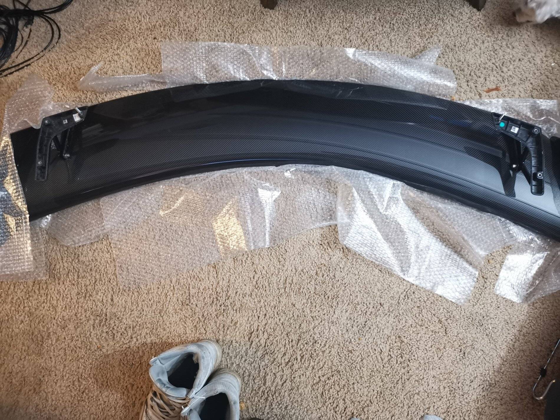

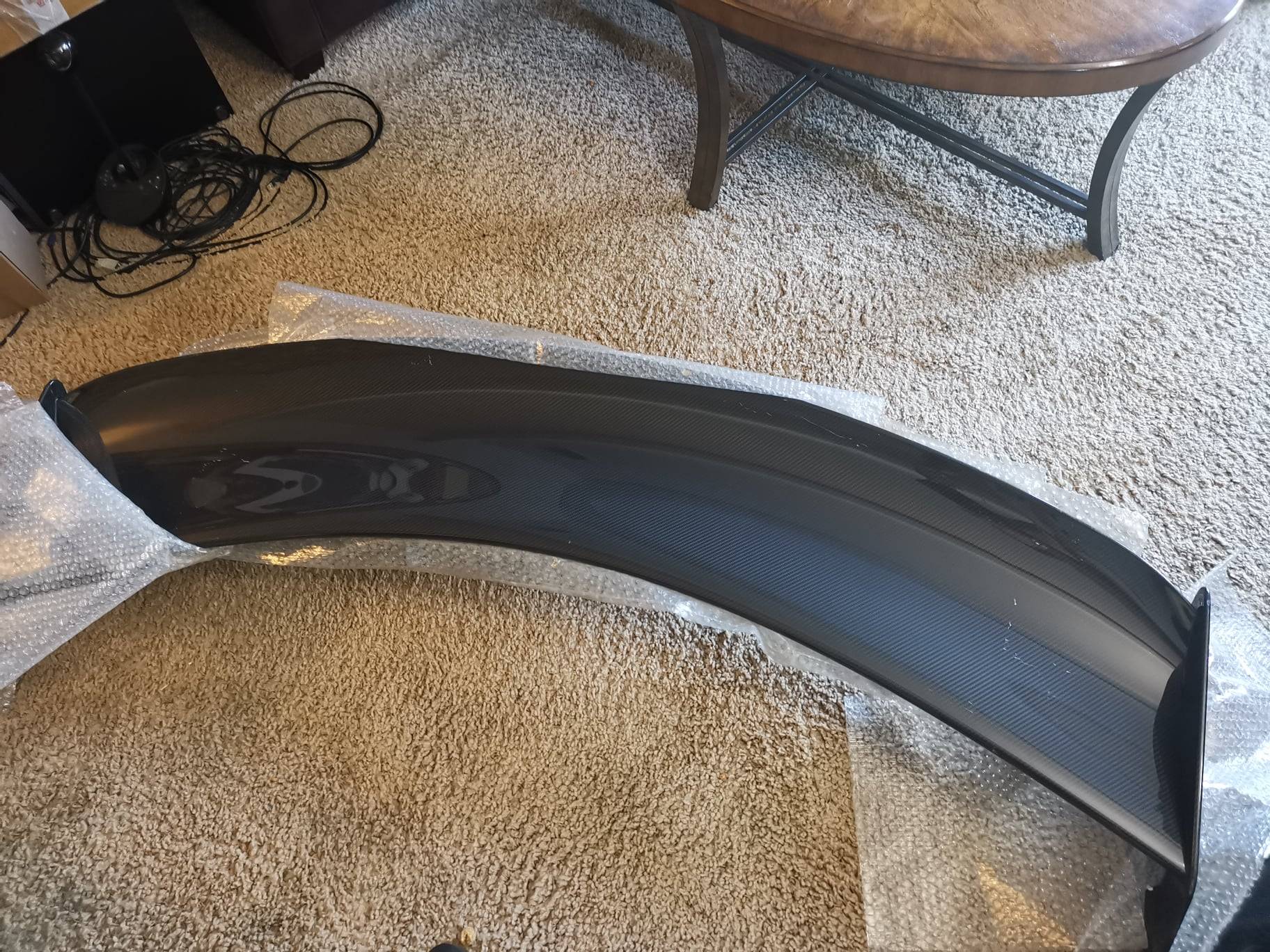

Here is mine that I got from them. Friday it goes to fix the minor issues. Ask for extra pictures, they were very accommodating when I asked.
