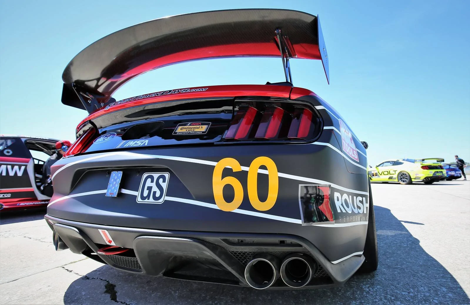

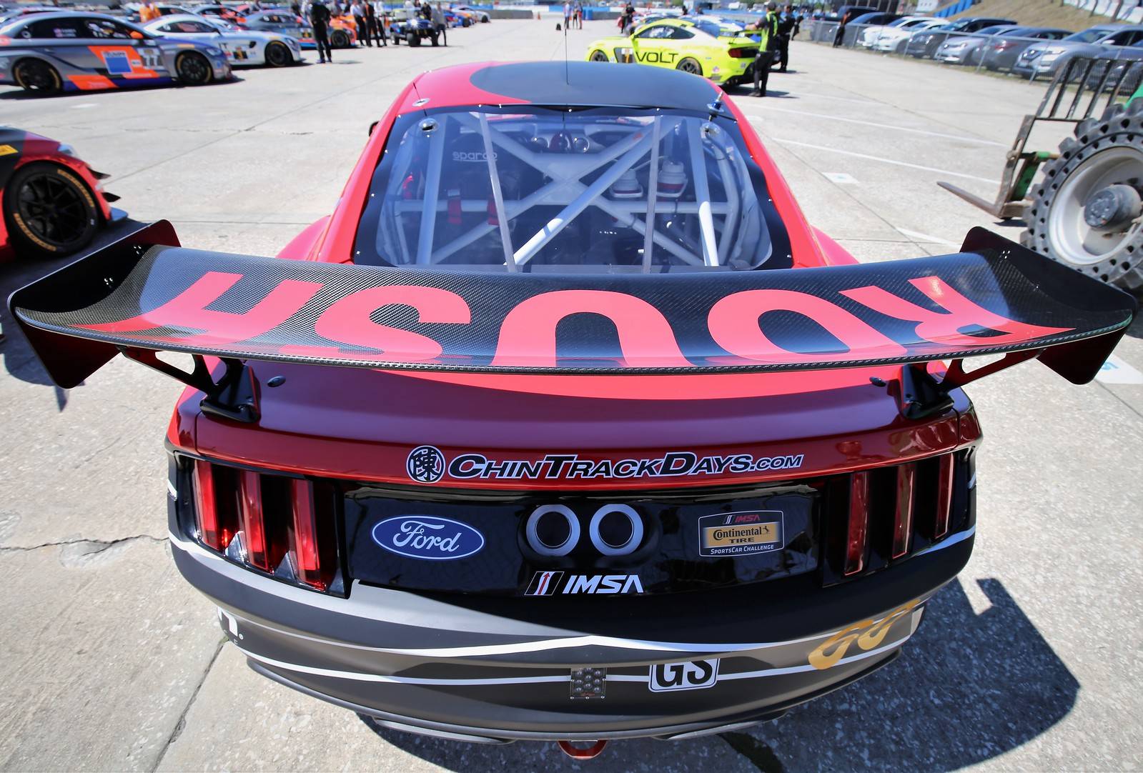

What's this chatter I hear...?
Reporting for duty, Brad...
I've been Jonesing for as long as anyone when it comes to the real deal Holyfield, jacked up and higher in the airstream, since being embedded with Kohr during the 2018 IMSA race season. Ain't been easy but I haven't given up yet...

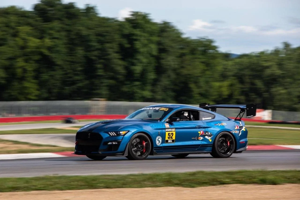

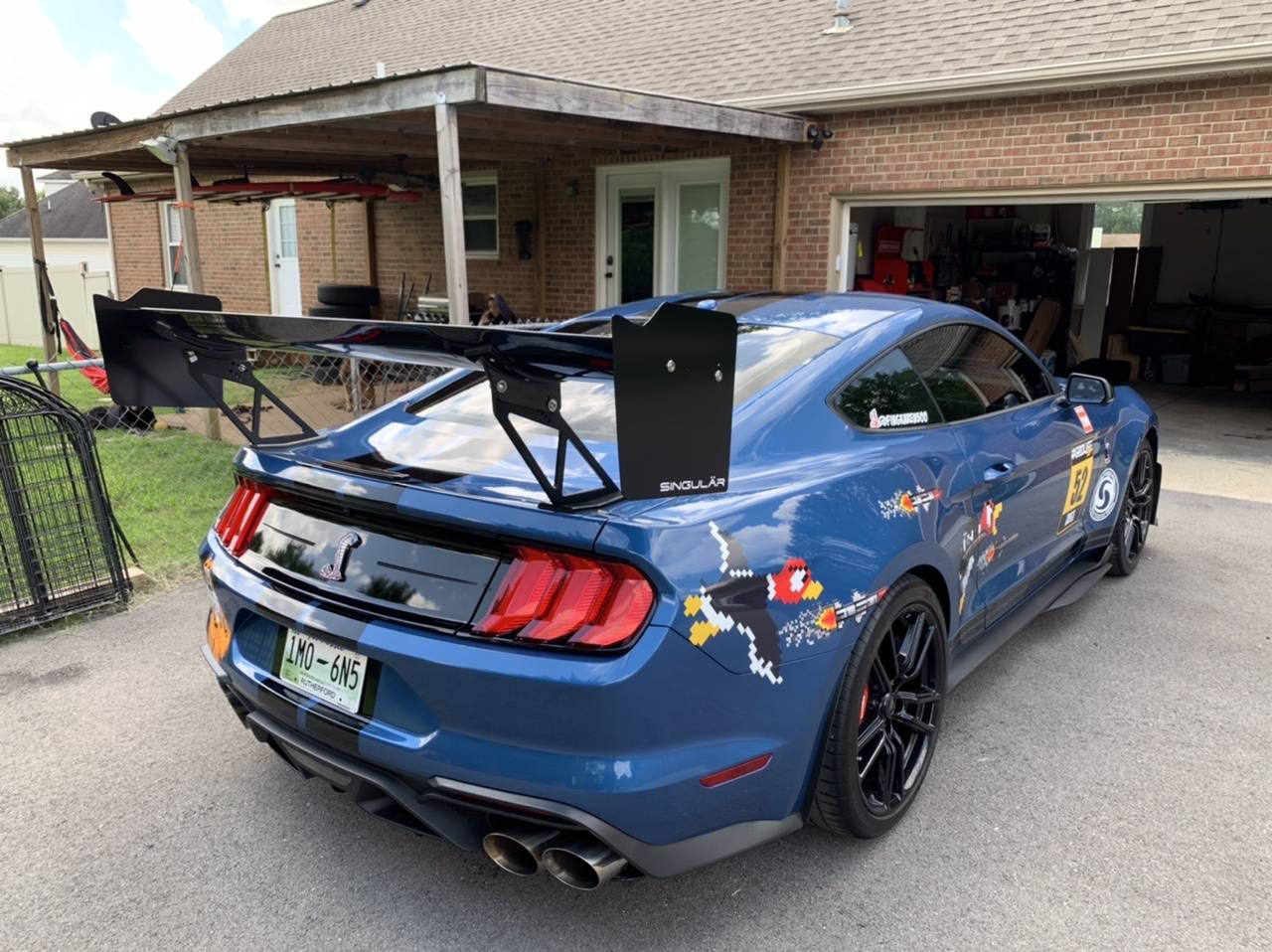

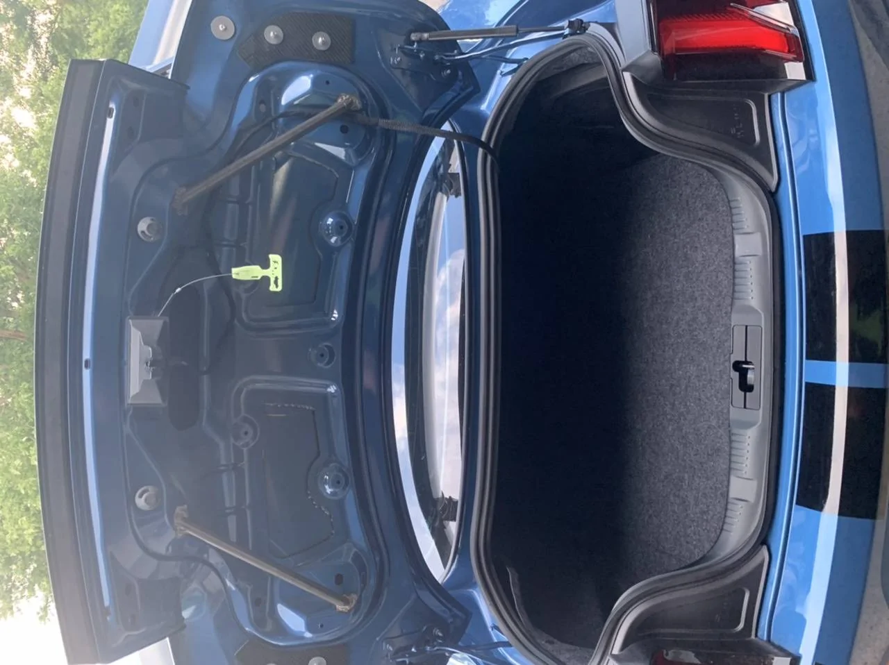

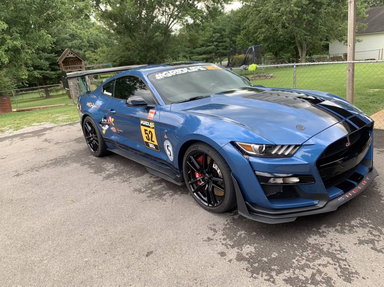

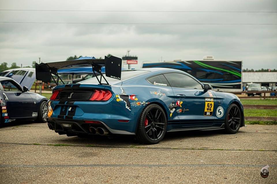

I love my wing. APR GTC 500. Btw, the end plates that screw in are there for a reason so you can adjust It if it’s adjustable or switch it out for a better one. I do need to get custom uprights made as I need more adjustability and can only get it as low as 6AOA. But it works as intended. And yes, my trunk is braced as per ford racing programs cars.

Hi there.
I am looking onto a CF hood right now and when I spoke to anderson composites, they said the CF decklid will not support a wing. A modification would be necessary to be able to handle the downforce that the wing produces. Can you share your data pertaining to your decklid reinforcement?
