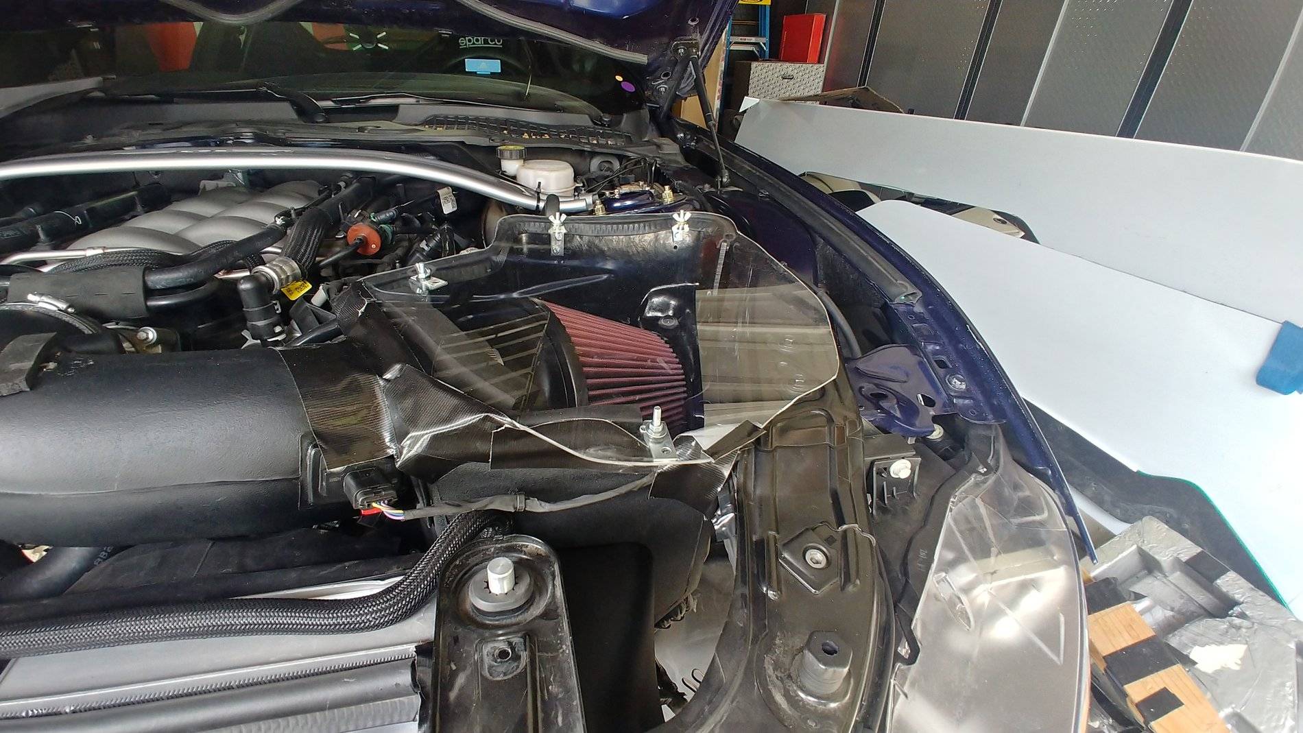

I sealed my JLT
so on top of the 22whp gain vs the oem inbox ( dyno back to back both with tune 96oct)
I have the Engine bay heat protection from soaking air directly. Wich was causing loss or power.
So best of both worlds
Sealed box with huge tune and high flow filter

Interesting, and it works? Pretty much similar concept of the Roush intake, no?
