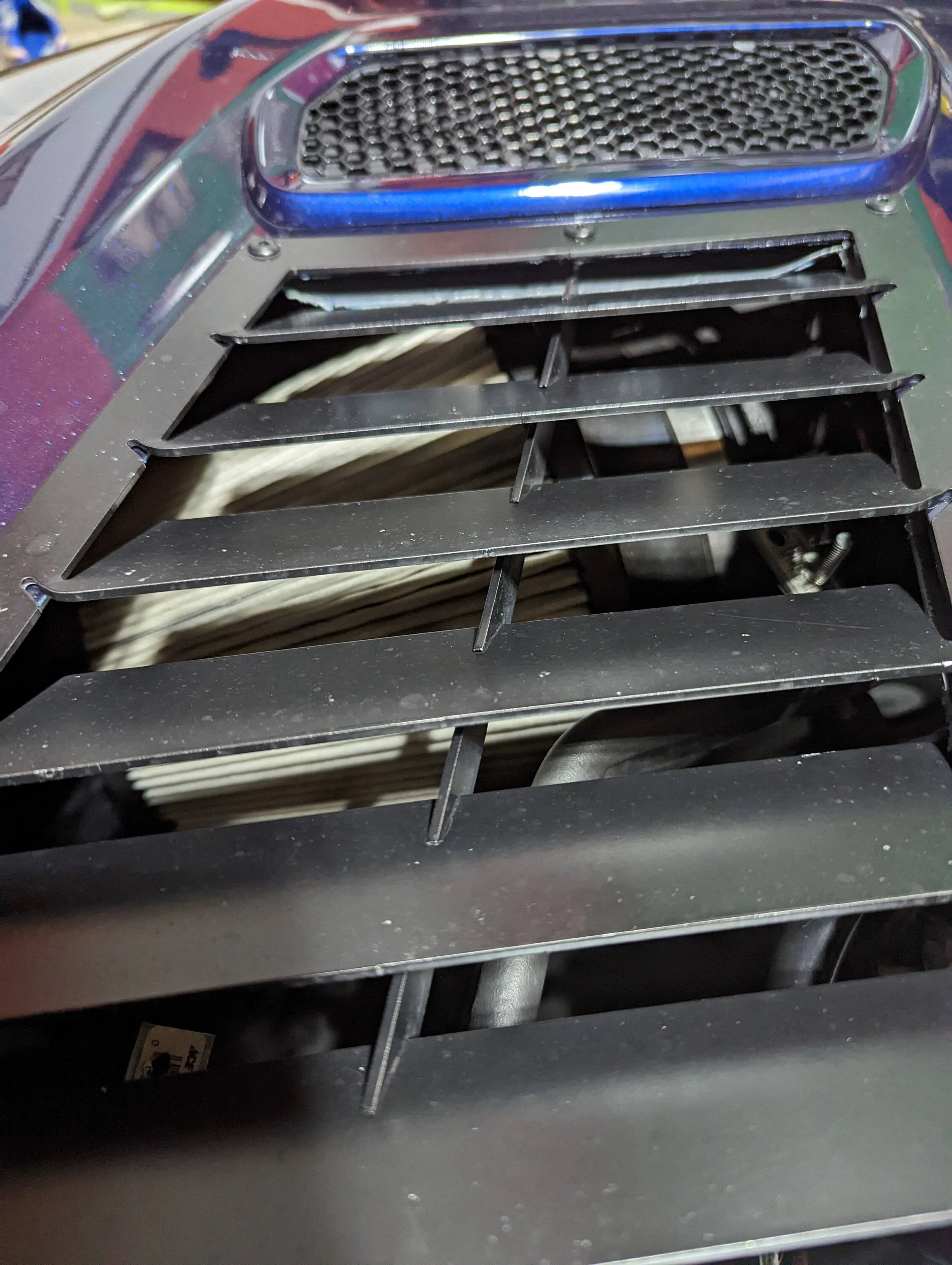

I.did it too. Hood down and up.
And 10whp.difference All the people say because hood up allows u to get air.from.ambient.
But...i have a huge vent over the Air filter so that theory should work with hood down.
But it doesnt. And I'm not sure if their fans moved at 160mph the mass of air that technically the car encounters.
For comparison a wind tunnels.i think reach 120mph or 150mph..
My point is.. the issue is only heat soaking.
My dyno.test showed more whp with a CAI
the street log.test showed more Air going in the engine with a CAI..
Pls send me the link of the video pls.

I would think that is a low pressure area above the filter and would suck air from the box. But it could just evacuate the hot air out the vent instead of it being pulled into the engine.
