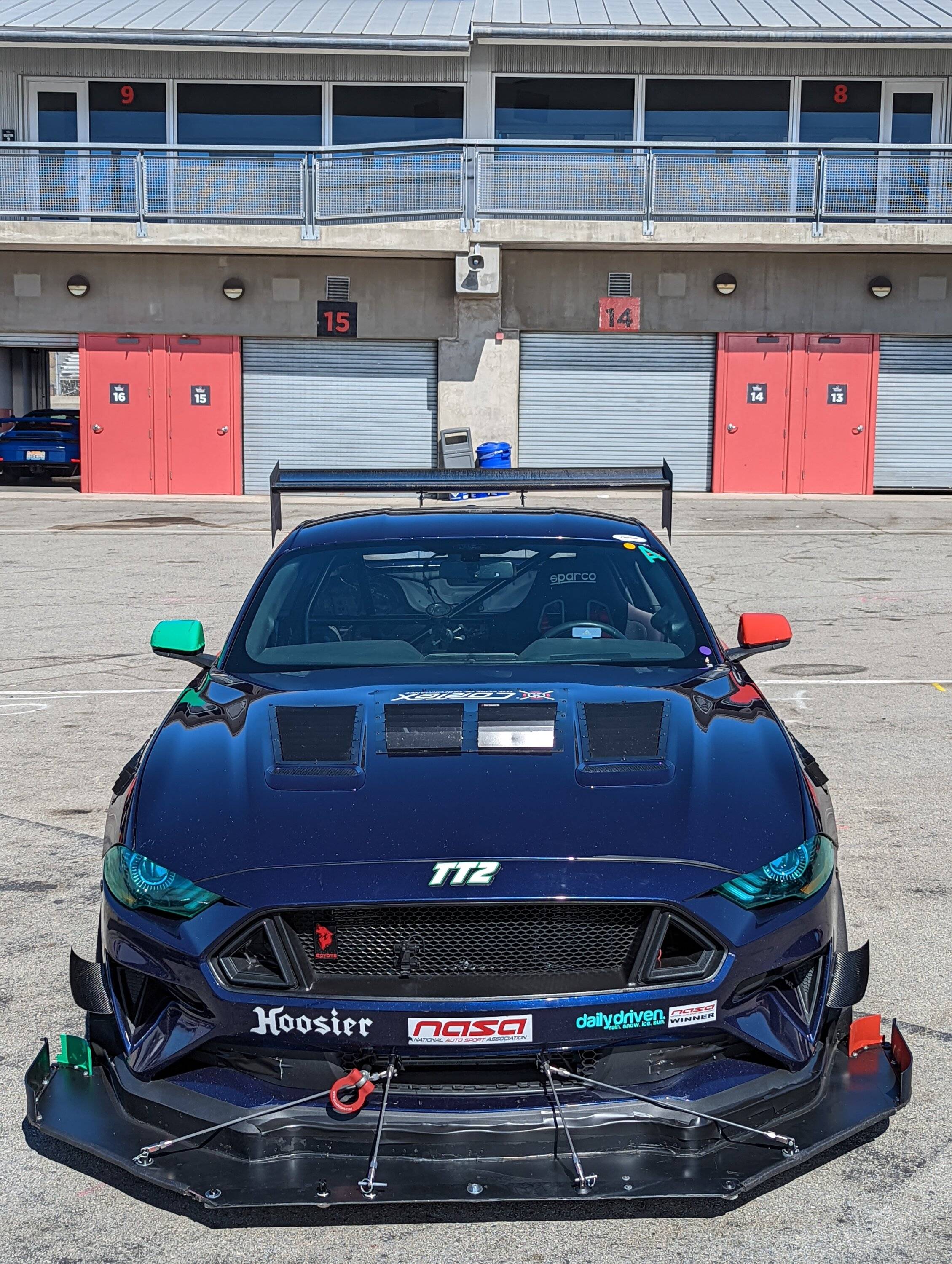

i have big hood vents just above my CAI.
With my tuner we wanted to see if a closed airbox will increase pressure in the airbox (ram effect) while now the air coming from the front evacuates from the vent .

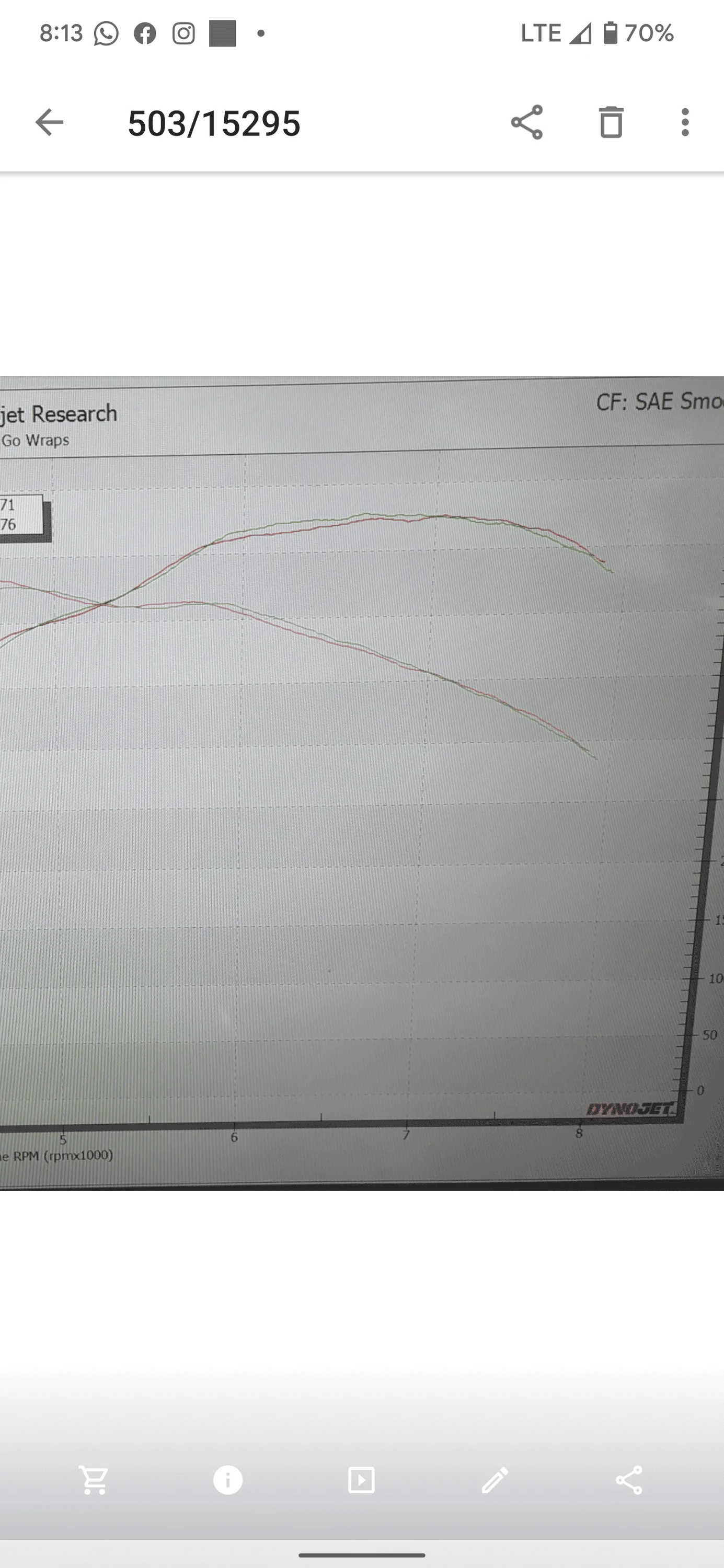

@Flyhalf , how’s the GT350 manifold swap turning out ?
Not worth for peak power
That's interesting. I would've thought that a sealed box with the only source of air being through the front snorkel would cool down really fast especially if you have the grill fully open.
Is there that much air leaking through the bumper and around the headlights that an open element filter can use?
Also when you mean open CAI, do you mean literally just the cone filter at the end of the tube with no box? Or just the original JLT box but without the plexiglass cover?
The front tube is pretty sealed to the JLT box (i have the box)
With the open box i run 2f max 3 above ambient.
Sealed is the same. But in strong acceleration the temps are decreasing way faster on the open one. (maybe cause it takes cooler air from the hood vents ? While otherwise is from the inside the box which is warmer?)
@GregO the 350 seems to not be super worthy. The gain is not with peaks but a better usage between 6 and 7k rpm.
I kept the 2018 JLT CAI. is slighlty different (filter is slighlty smaller) but i dont think this is a huge difference. The graph shows the green line better around 6 7k

I’m referring to the GT350 intake manifold not the filter to TB system.
Yeah thats what i meant.
The ported 350 and TB does not give that much more.
The only thing i was saying is i kept the JLT CAI FROM THE 18manifold (which is slighty smaller)
