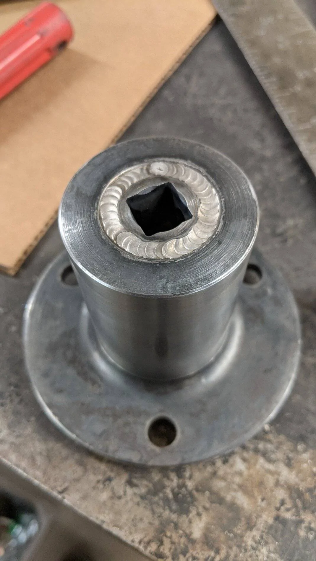

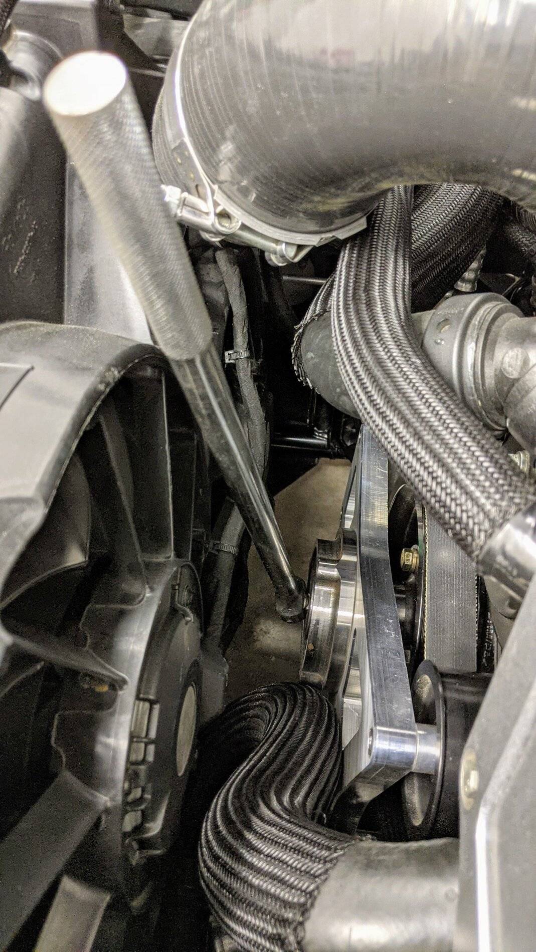

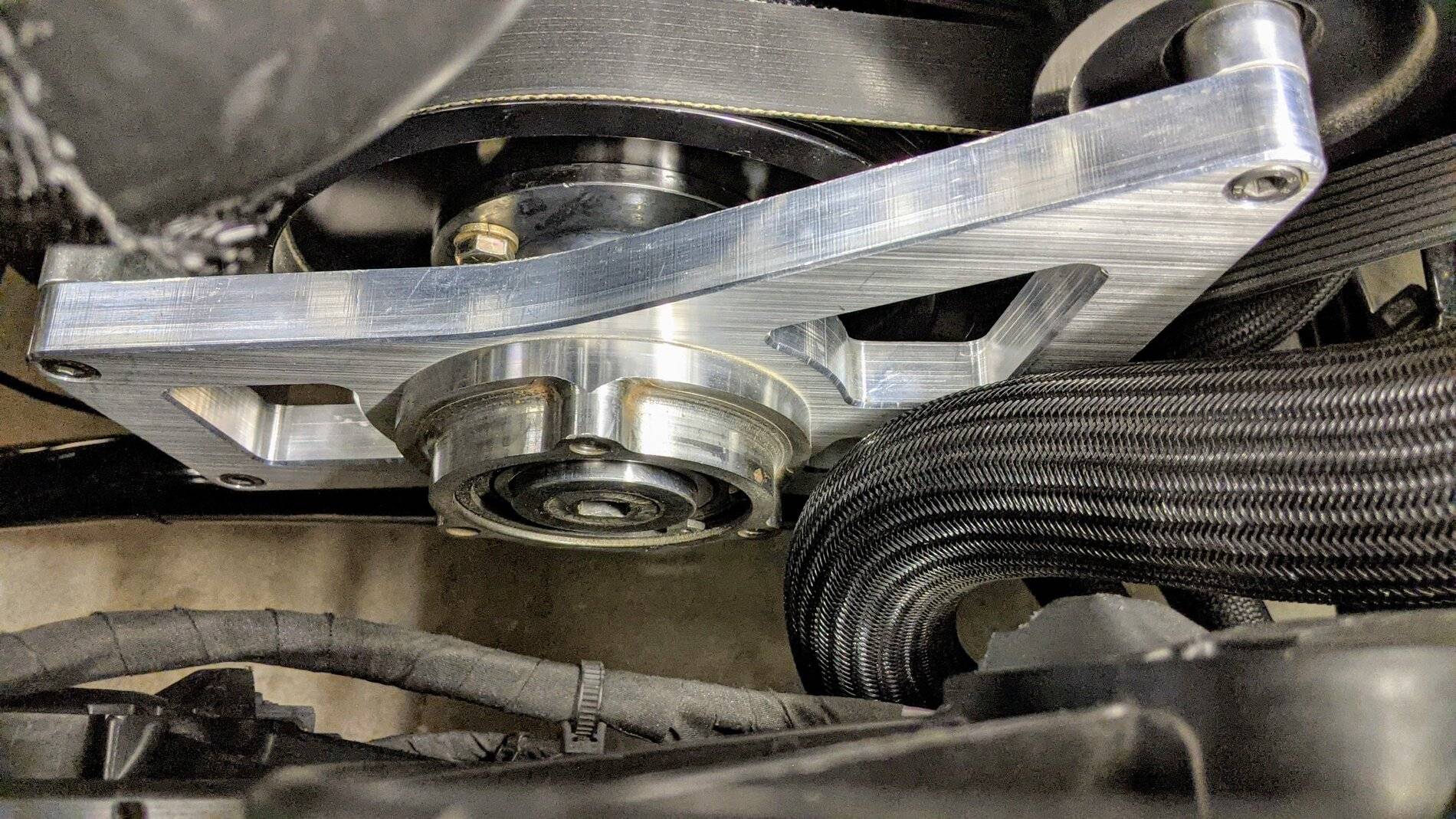

I run and recommend the crank support as well as the crank stud. With the crank stud kit installed, i personally wouldn't recommend putting a socket on the nut to turn engine over as the 12pt nut is small and may effect the torque applied to the balancer. With the crank support installed, the mandrel covers the stud. Its a pain if you want to manually turn engine over to tighten/check converter bolts/nuts, torque blower pulley etc. I had a 1/2 drive installed in the mandrel to eliminate the removal of the support. Pm me if you or @TKM Conbread want this done.
I’m probably going to want that done. I’m also wondering what you guys with crank supports are running for balancer. It seems like there are numerous part numbers for balancers for the coyote. And then does the stage 2 pulley that is supplied with the pc kit just bolt to the new balancer?
I run ATI. What you have now will not work. When you get the crank support, you'll need to order a new machined PC crank pulley.
I am also getting the @80FoxCoupe crank mandrel mod done :rockon:
You want the ATI 918047. Yes the CS kit will include a drive pulley specific for ATI. The ATI and new drive is almost 4lbs lighter than oem balancer/cam lock drive pulley.
PC also has a kit for the Innovators West balancer. I run ATI.
Damn thats baddass!!! Hell of a job Big Dawg!!!
