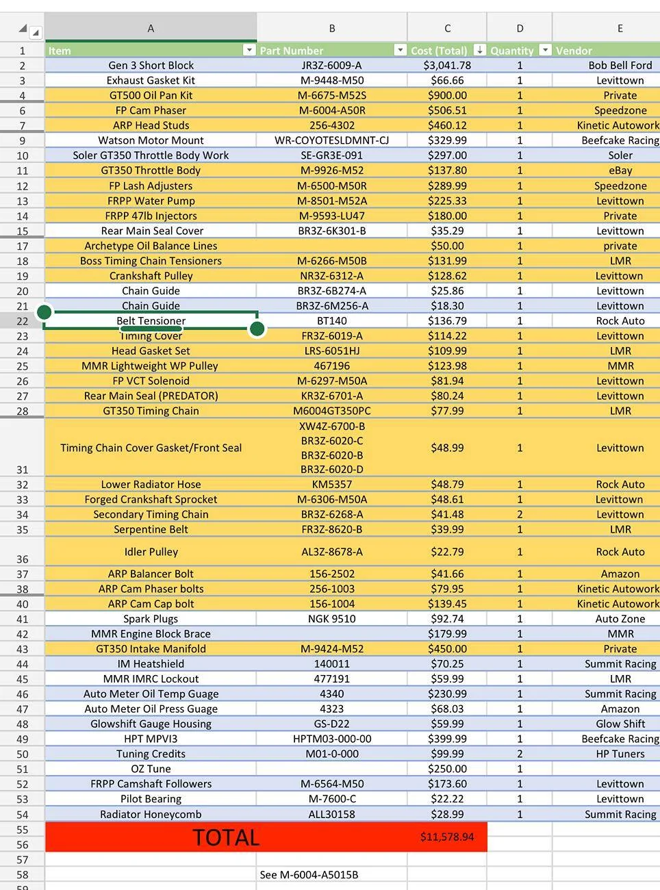

ENGINE

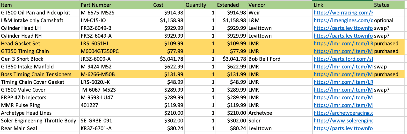

This is the finalized list of the engine rebuild. The rows in yellow are parts that I already have so you can imagine I have a decent parts pile. I would like to do L&M intake cams but I cannot due to Max 3 rules so I am going with a ported GT350 IM and Soler TB to maximize the air intake performance.

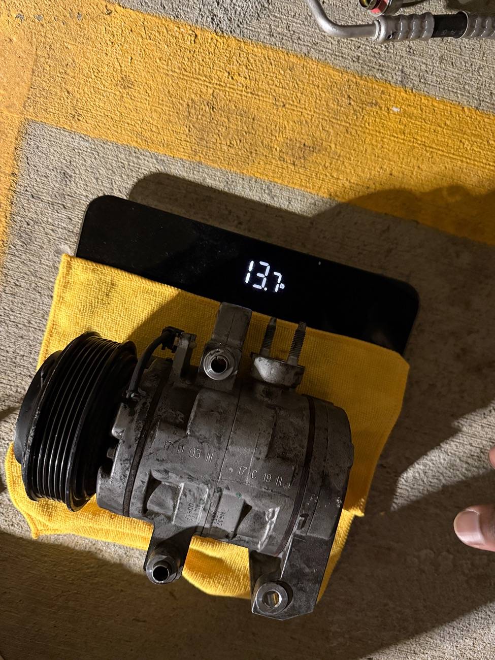

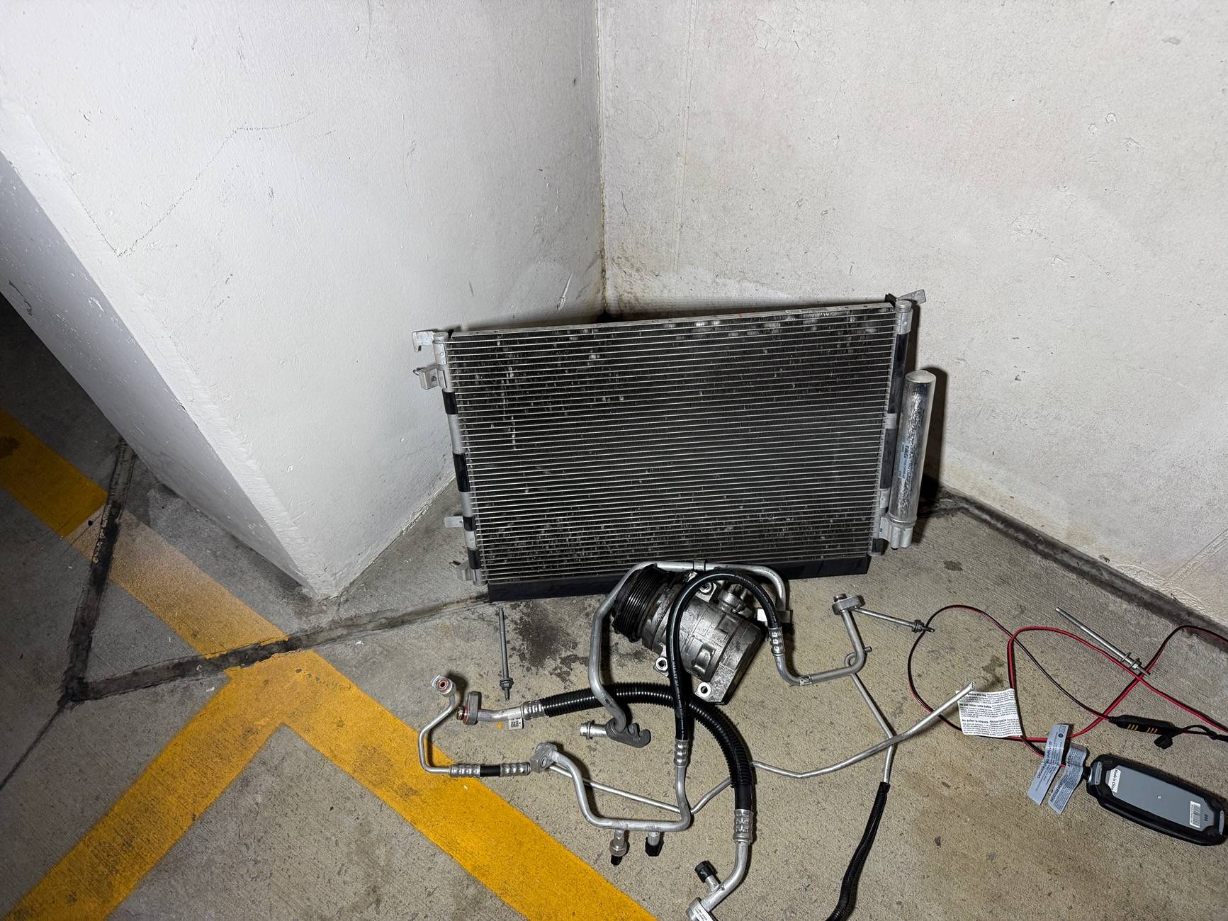

Oh, I also removed the AC compressor and condenser because...racecar ya know. That's 20 pounds between those two that I didn't have to work extra hard for in the gym. BMR makes a simple piece to block off the ports left open from removing the AC lines. Looking back, I could've just bought a piece of aluminum, drill a hole and call it a day but at least it was free shipping lol.

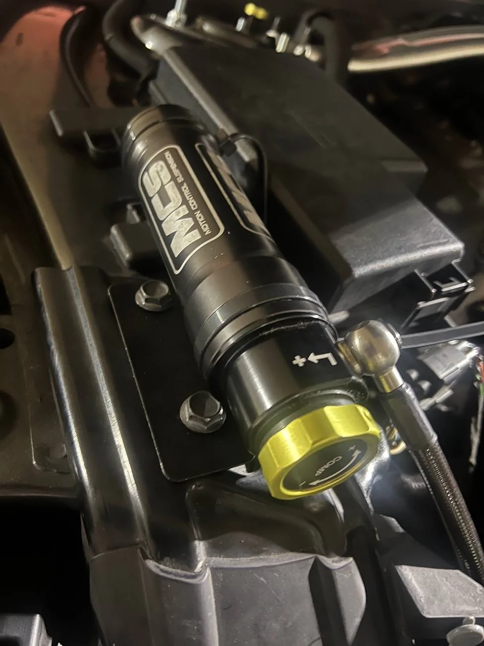

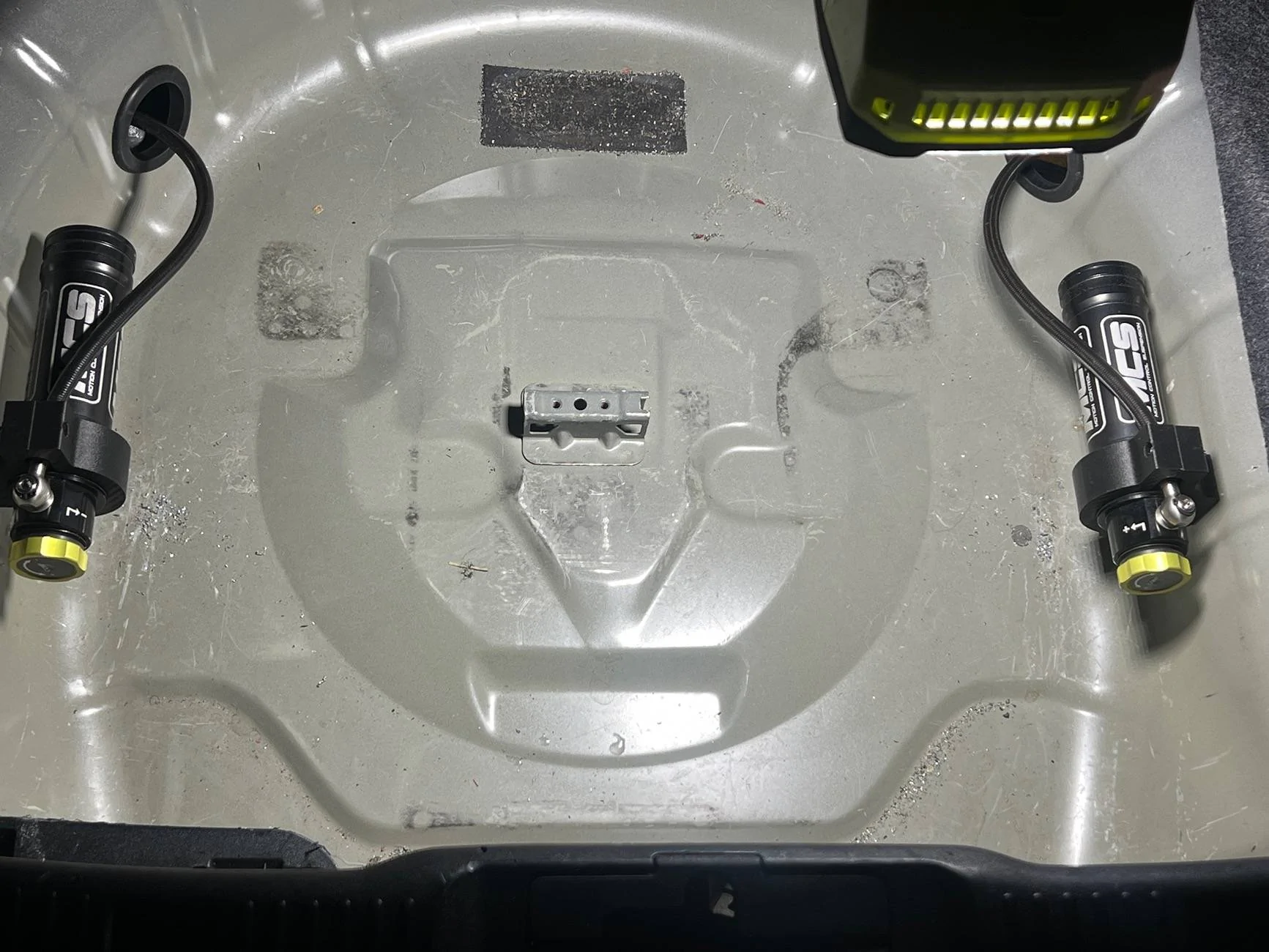

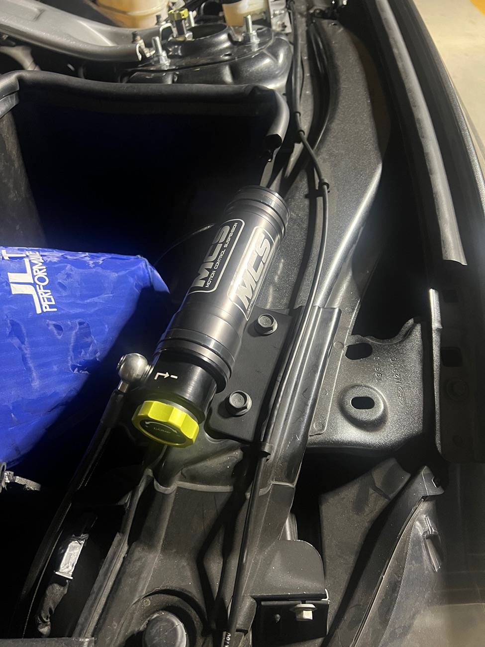

I was struggling with finding mounting points for the reservoirs for the MCS coilovers. I finally found a solution I was happy with. For the rears, I bought these MCS specific mounts from Build Journal. It makes for a clean install.
Up front, I designed a bracket that uses the radiator tie bar mounting points. Because I have a cutout for the track spec vents, the reservoirs do not contact the hood when closed.

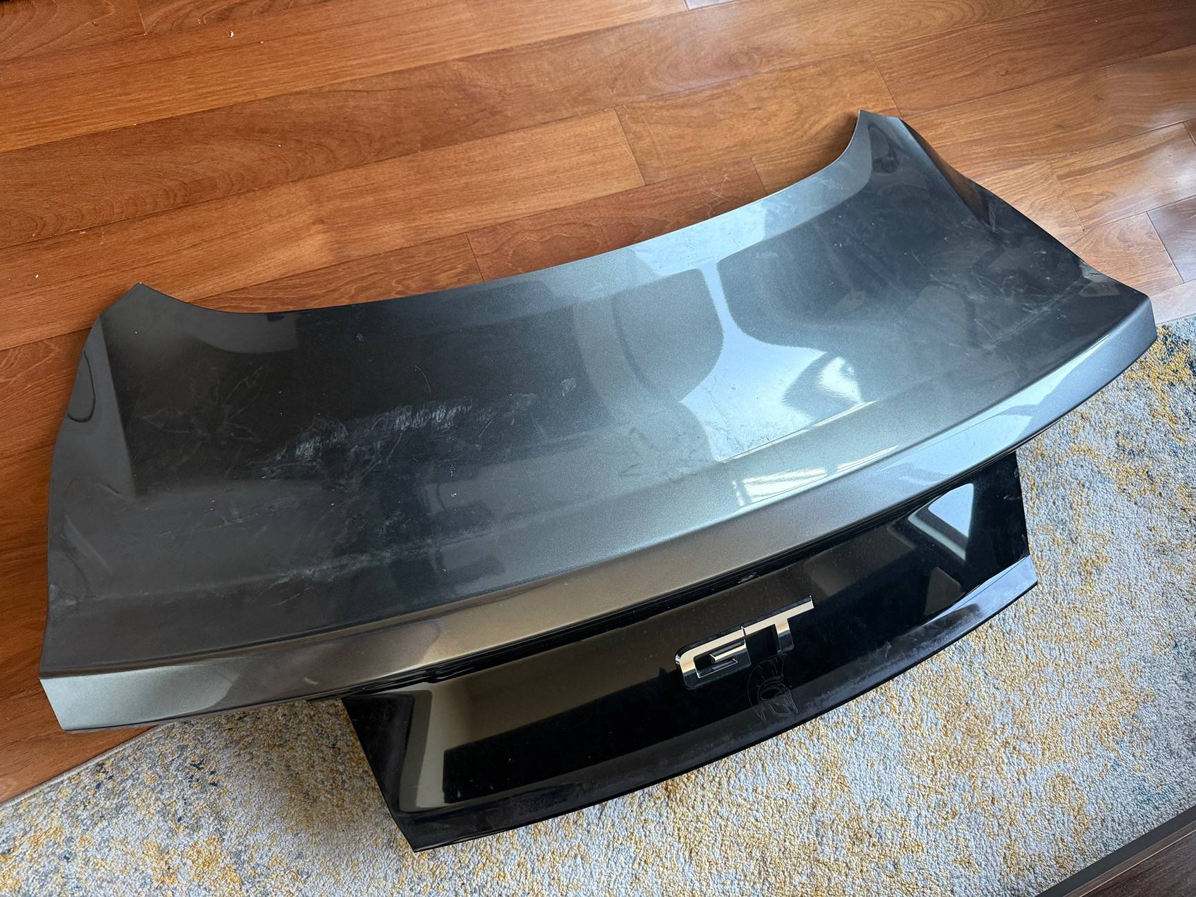

Finally ended up finding a blank rear trunk lid for a great price. blank trunk lid means big wing lol. I have decided to go with AJ Hartman's Fulcrum 14 wing. Thanks to @WItoTX , I was able to get some measurements and I will be setting the wing back a few inches which will yield more DF with less drag.

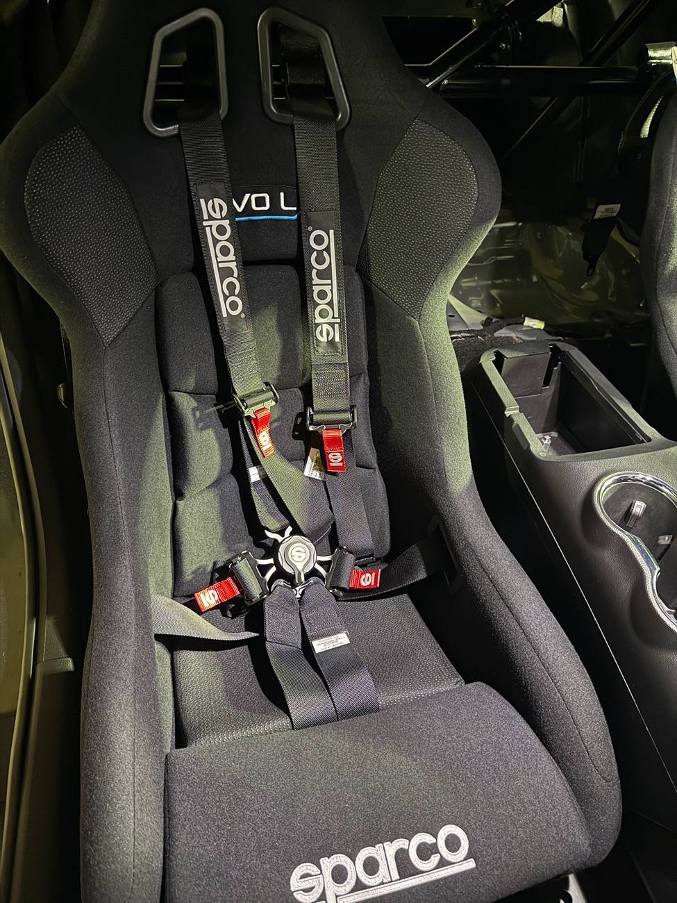

Added a passenger seat and harness. Went with the slider seat mount option from PCI. Very very solid. Now the girlfriend can ride with me on track and she can never say we dont spend quality time together.
Removed the arm rest top because my elbow kept hitting it. I like the look.

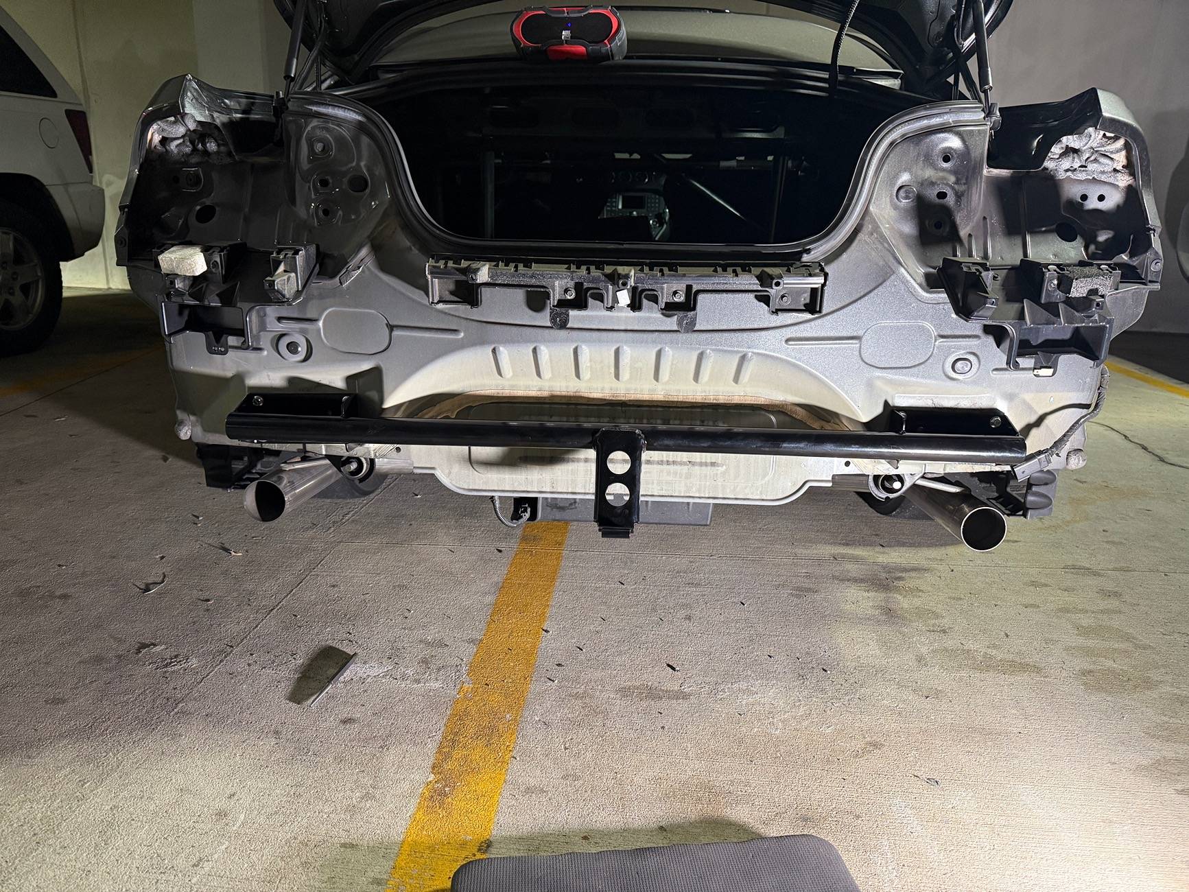

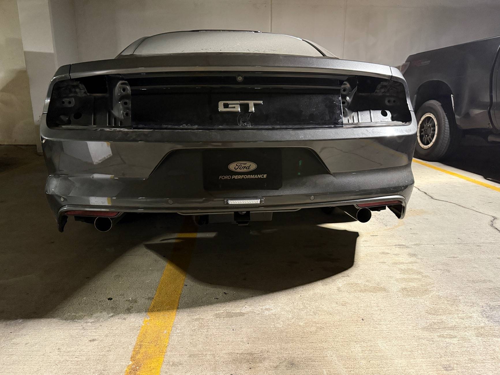

Been doing a lot of things and spending money on everything but the engine.

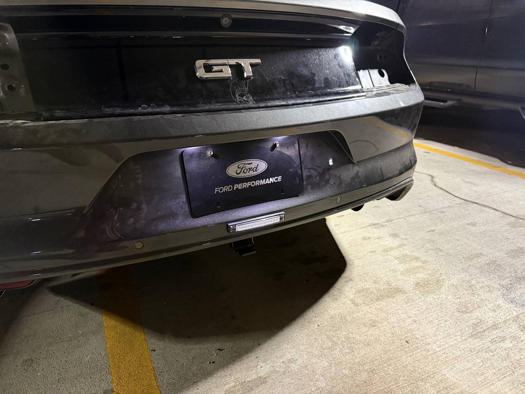

Installed a rear Watson tow bar. It saves a few pounds, about 7 to be exact. Most people install it where the tow hook comes out behind the license plate. I copied honeybadger’s idea and flipped it upside down. Straight forward install. Did some arts and crafts and cut the lower valence section from the bumper. Because I will still drive this in the street or at least people know I am reversing, I bought a weatherproof led light and designed a mount(so it’s sits flush against the bumper). Came out great.
oh and you may notice a different trunk lid. Update on that soon:)

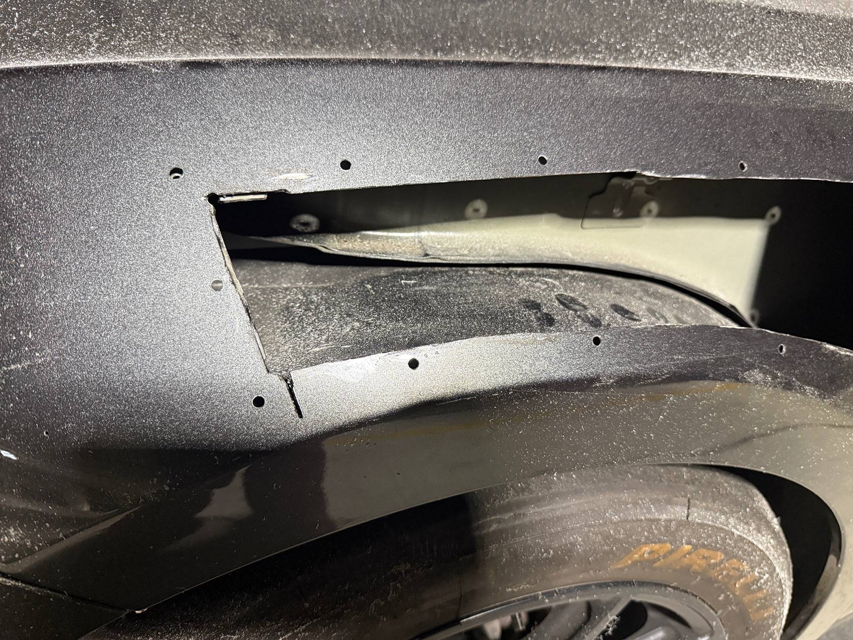

Since I’m here …dremel is the way. I got too confident with the angle grinder.
Vents should be back from powder coating next week.

I love how these cars look with the rear valence cut off. Looks more open, less draggy, more race car. And to think people pay money for different looking ones.
Dremel certainly takes longer but yes, way more control.
