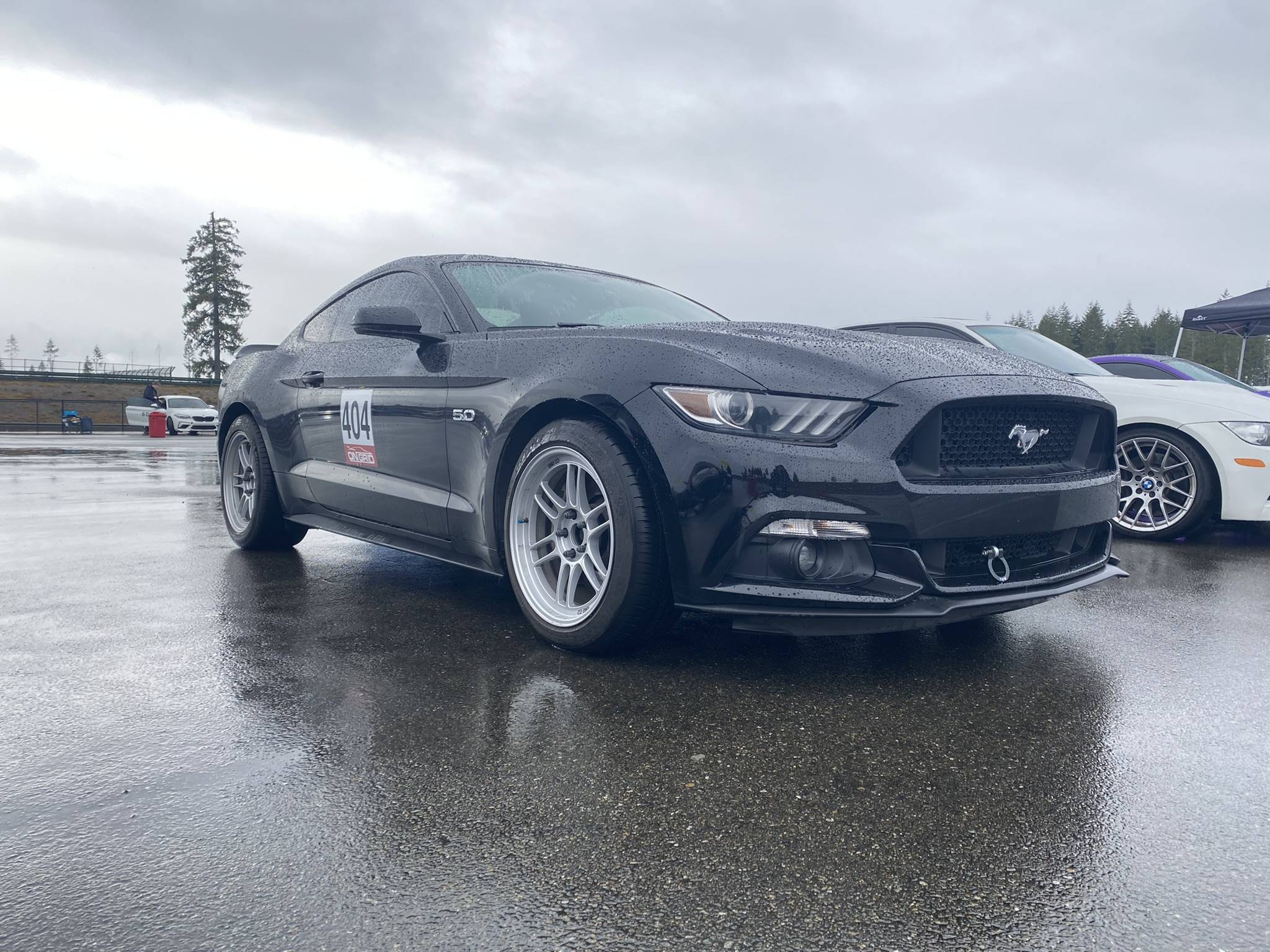

This tread is detailing the current status of my track car build. This is a 2015 manual S550 GT Premium, non performance pack. I just finished my 3rd HPDE.
I really wanted a premium for the fit and finish. The car isn’t anything special, I’ve just curated parts through verified sourced. I’ve been learning track driving with the car, and adding on where I see fit.
The basics are I’m running 18x9.5 square RPF1’s, with 275 rear tires and 245 front Michelin pilot sport AS4. I’d like to run square tires later on.
-Engine:
The first parts I installed were a GT350 intake manifold and an PMAS 120mm cold air, tuning handled by Lund Racing. I retained the stock throttle body for better Throttle response, utilizing an adaptor plate that VMP sells. With this combination, the car makes peak power at 7900 RPM, and on track I rev it to 8100.
-Exhaust:
Initially I ran a Corsa Extreme catback. For stock header applications, this is my favorite exhaust. No drone, and I enjoy the rasp more than a deeper rumble.
I recently installed Kooks Inch and 7/8ths catted long tube headers. The car is insanely loud at WOT, which I may remedy at some point with a quieter muffler. The power and torque gains are great.
Im pretty much finished with power modifications.
-Drivetrain/brakes:
My OEM clutch failed, so I bought a Mcleoud RST with an aluminum flywheel. This is the best clutch for N/A applications. All issues with the MT82 are solved with this clutch.
I’m running hawk HPS pads all around.
-Suspension:
Eibach front sway bar. The front end feel is my main critique of this car stock. At the medium setting, the front responds and has far less body roll.
-Required repairs:
The clutch +slave cylinder broke, coolant hose needed replacement, alternator went out. Engine has been reliable, been tuned for 20,000 miles.
My strategy for this build has been incremental improvements based on what I feel on track. Currently, the car is at my skill level.
When I buy an f80 m3 to daily, I’ll probably revise the mustang shocks+struts and get bucket seats. The car has 96,000 miles, so I’ll also refresh belts, gaskets, etc.
In conclusion, an S550 GT isn’t a bad track platform. The engine is the star of the show, where high revs felt very great on track. It has also been reliable. Obviously there are cheaper/lighter cars to track, but the running costs of a mustang paired with the performance make it a no brainer.
What would you guys recommend for track essential modifications?
