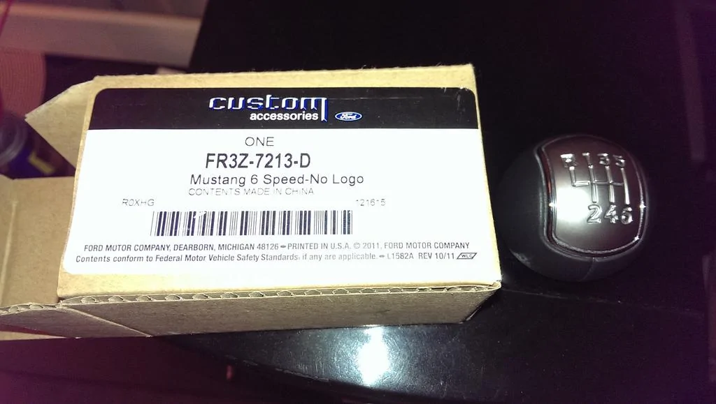

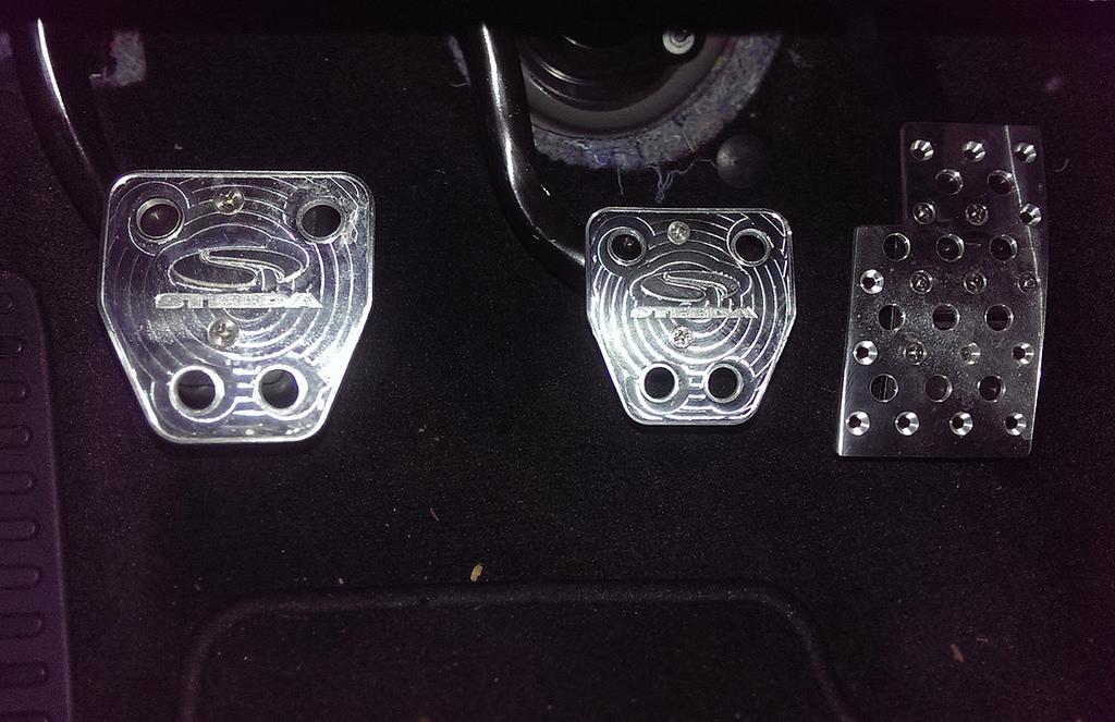

Here was the first series of mods that I installed right after buying it:
Shift Knob:
STEEDA Race Pedals:

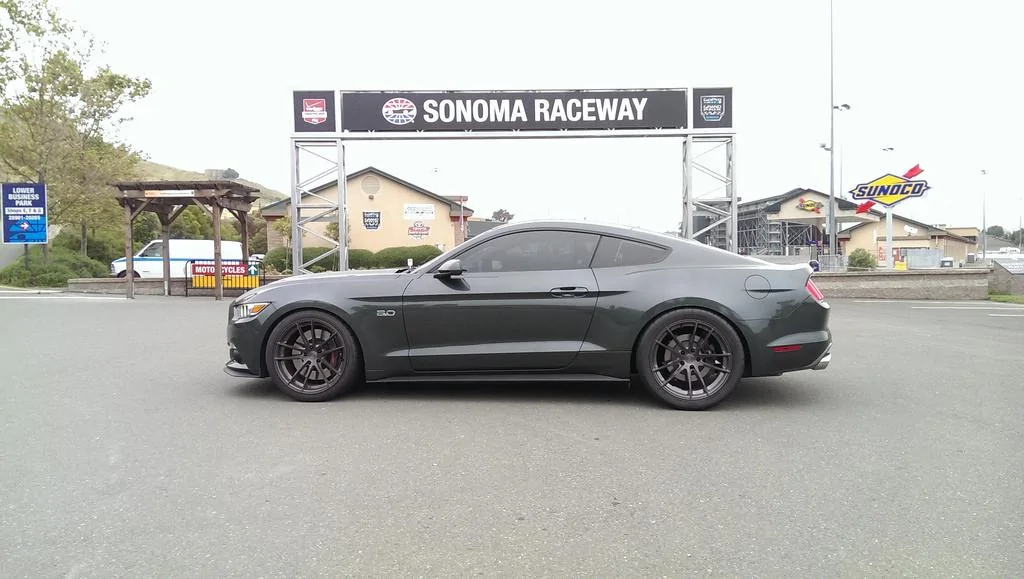

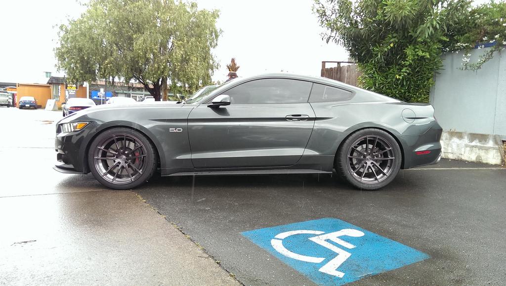

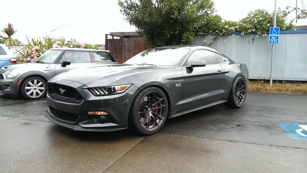

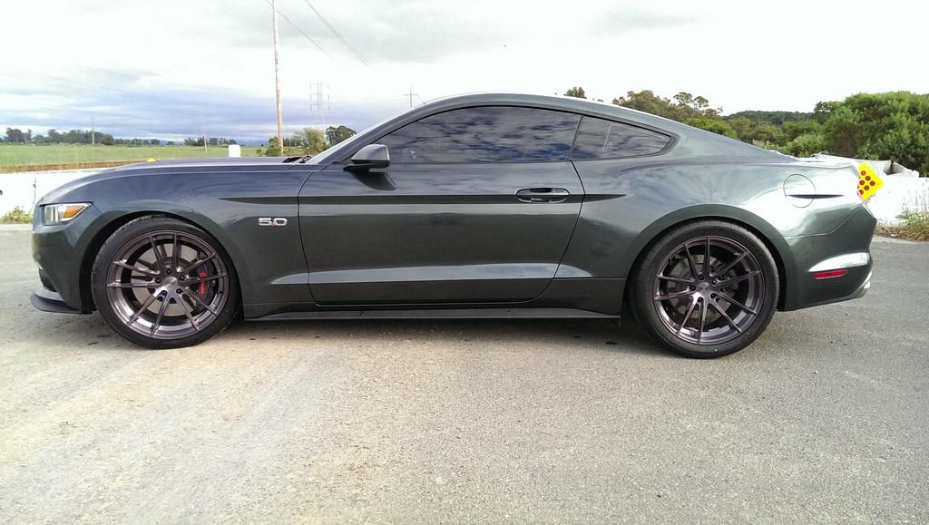

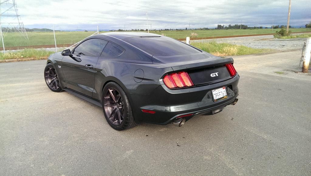

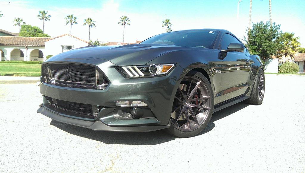

04/09/16: Put on a new set of Stance SC-1's. 20x10 +35 all the way around. 275/35/20 Front and 305/35/20 rear tires mounted up.
After a wash:

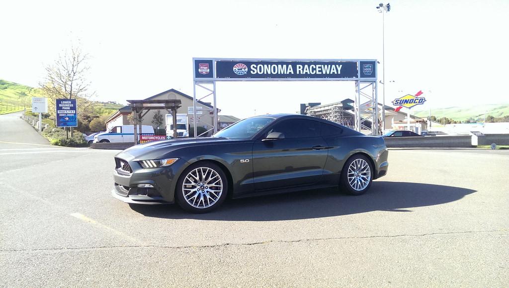

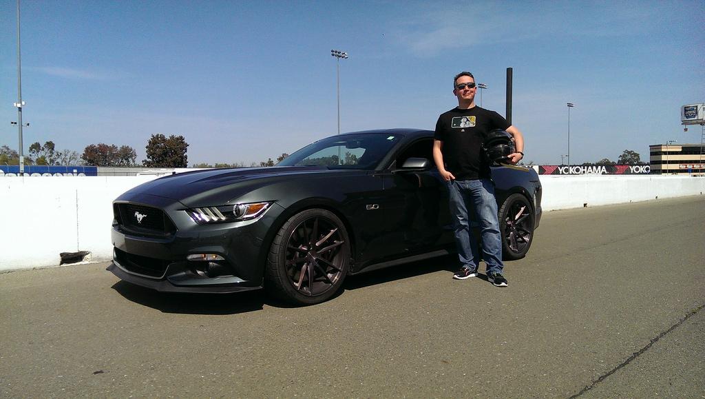

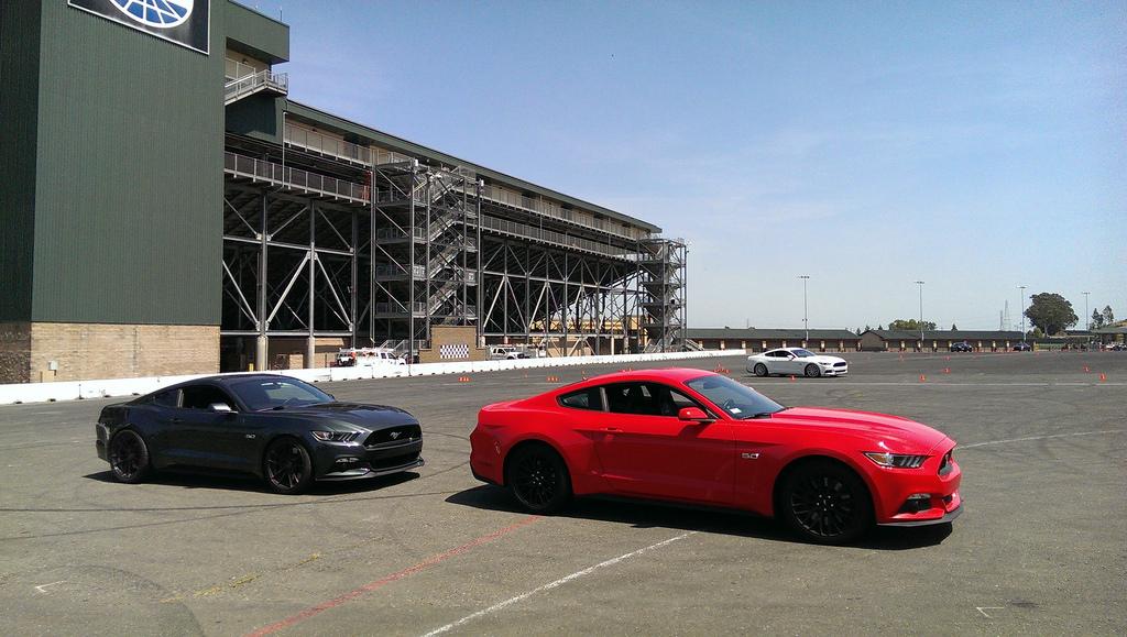

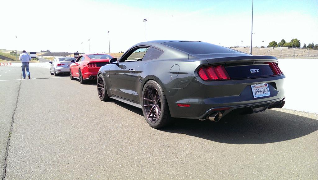

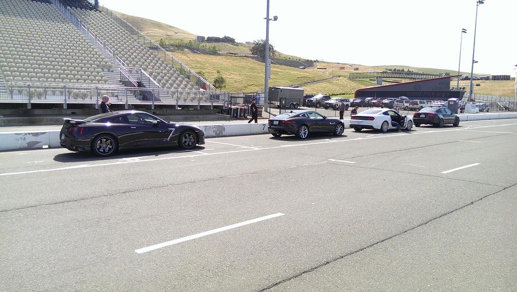

05/12/16: Time to test some of these new parts out at the track! Sonoma Raceway HDPE stage 1 by Sim Raceway.
Started the day's instruction with some Auto-X.
Then off to the big boy track.
Some other toys...
