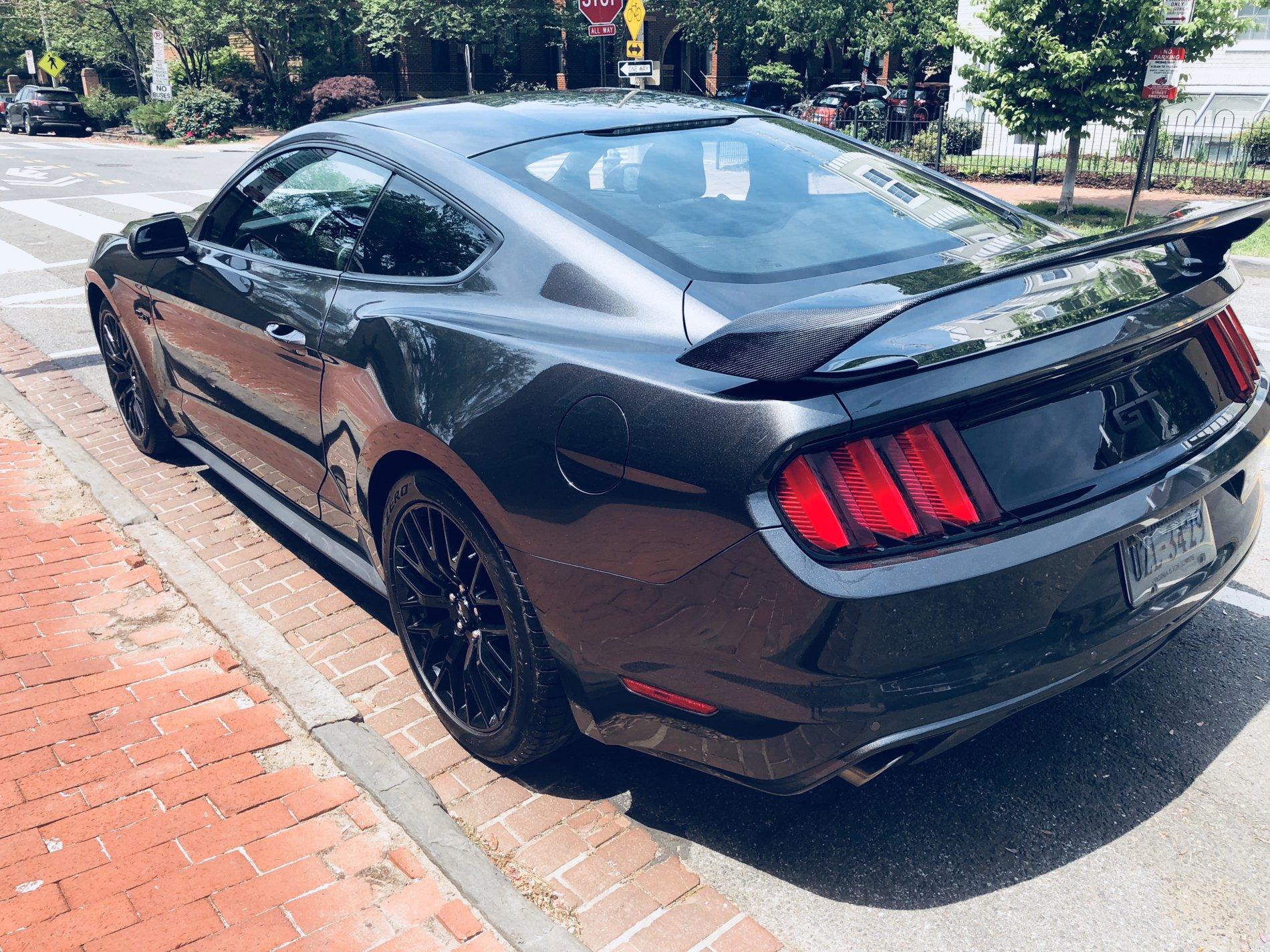

First thing I did was the Anderson Composite GT350R CF Spoiler. I loved the look on the R and I thought this was a must have. I bought it from AM.

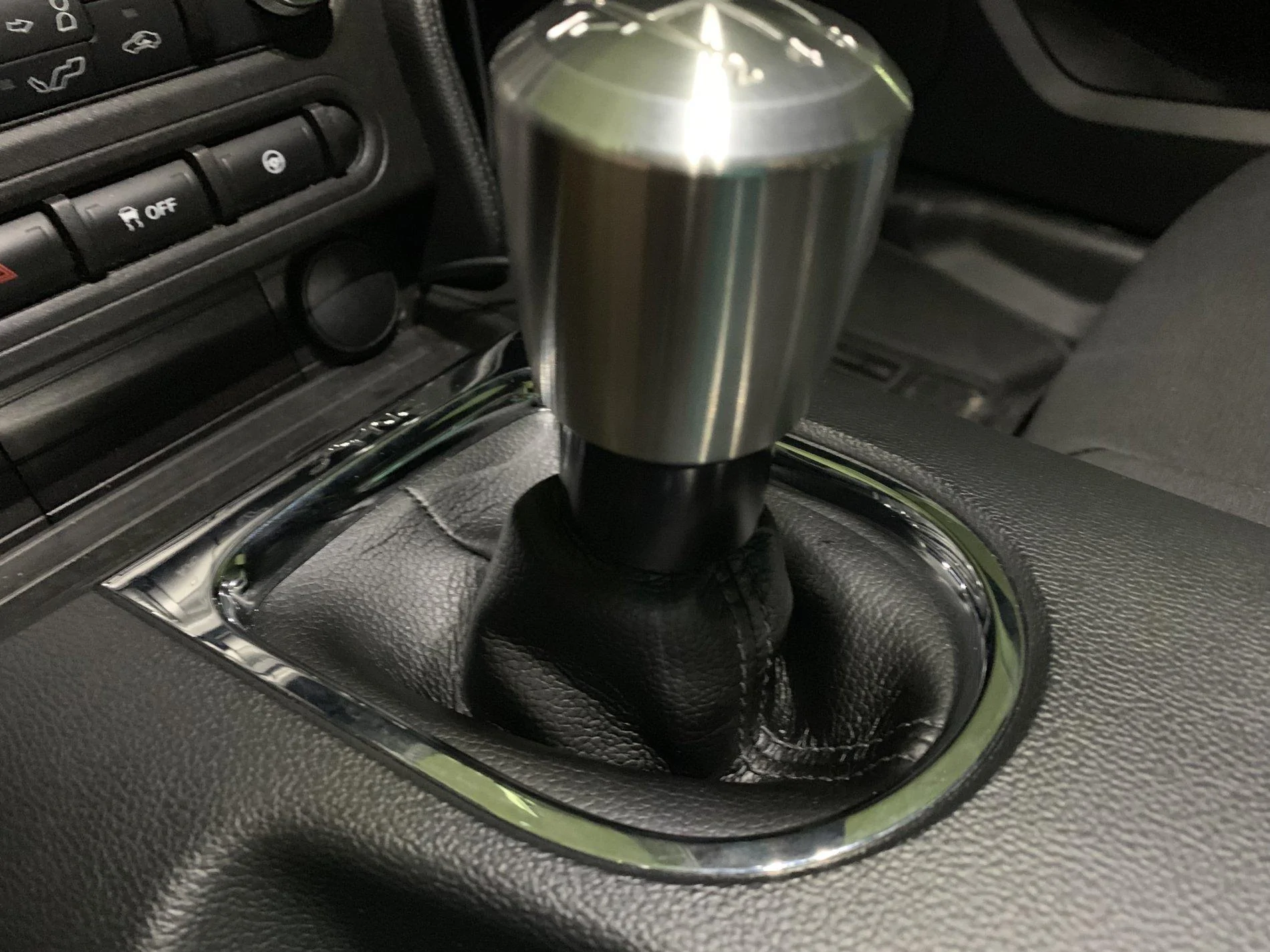

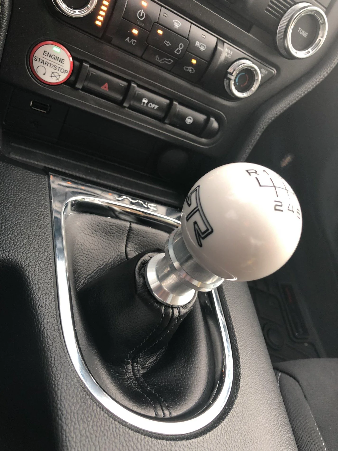

Later I changed out my knob to the white RTR + Barton reverse collar.

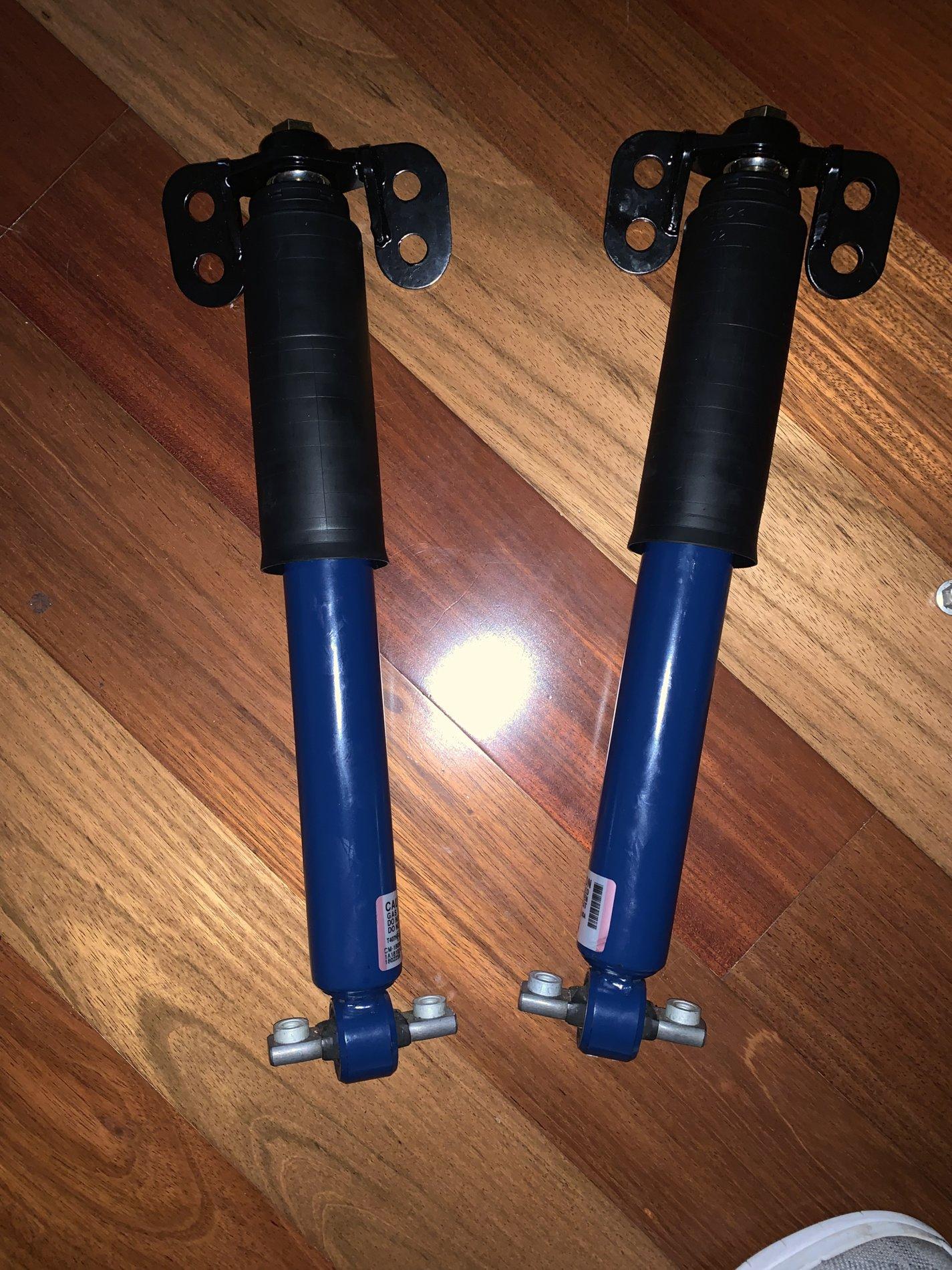

After thinking about how I wanted to start this build, I decided to start with suspension. After going back and forth with @BmacIL (Also a huge Thank you to him for answering all questions), I was set on BMR SP083 and the FRPP Track dampers and all the basic essentials such as the CB005 and RLCA Bearings. Even though I know you shouldn’t install too many parts at once because of troubleshooting and understanding how each change affects performance, I secured all my suspension parts first. I slowly began purchasing all the parts I could get. (Side note: Also finalized a lot of my suspension based off of @Bluemustang signature lol.)
I was planning on getting a MGW after the suspension but I came across a deal on here I could not pass up. So I got that and had it installed at JPC. Did the BG trans fluid along with the JPC SS clutch line and Steeda MC line kit. HUGE difference especially with the weighted Raceseng knob! This is my first manual car so when I used to read about how sloppy the stock shifter was I never knew the grass was that much greener on the other side. Next up is the diff fluid.

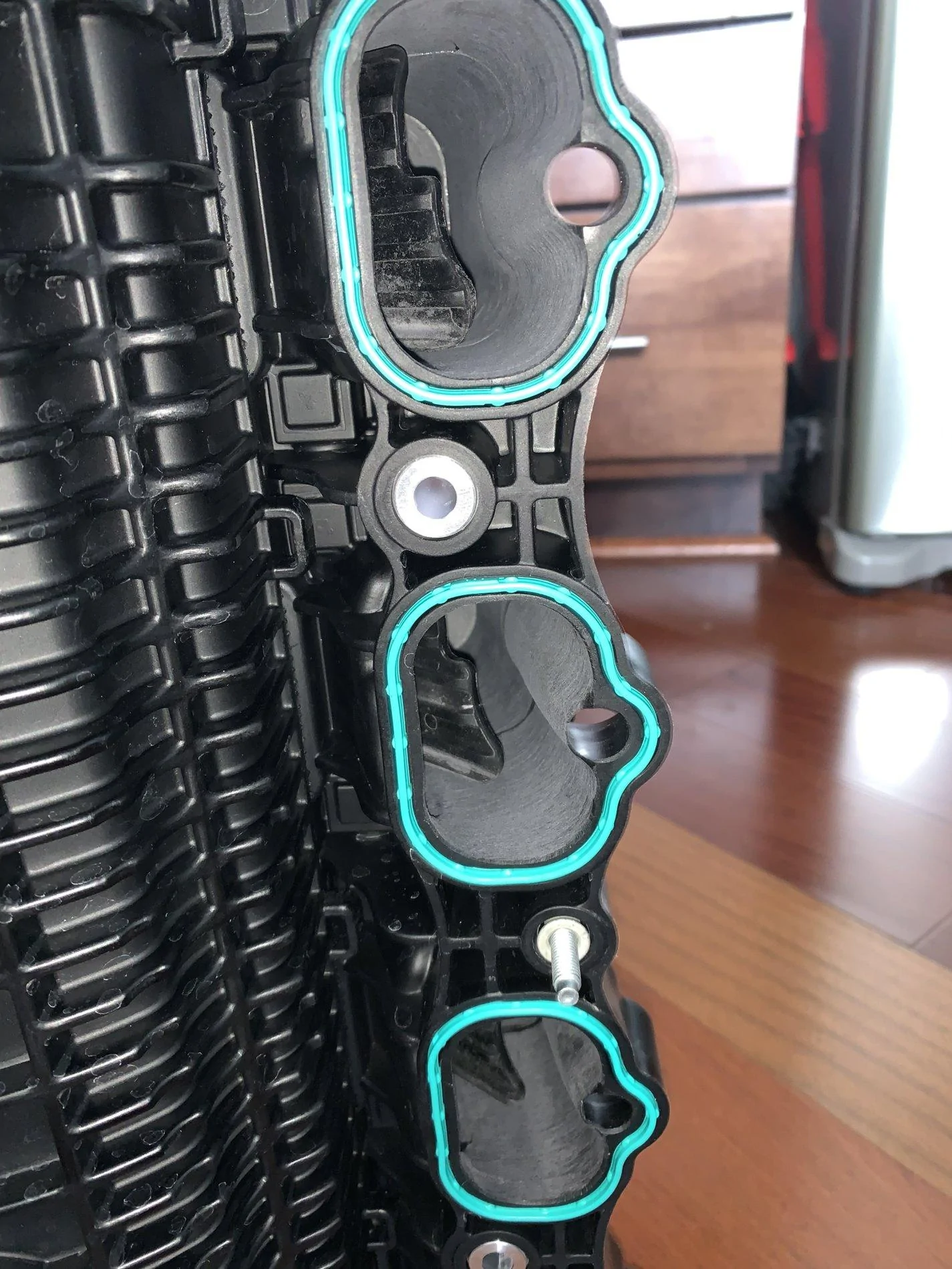

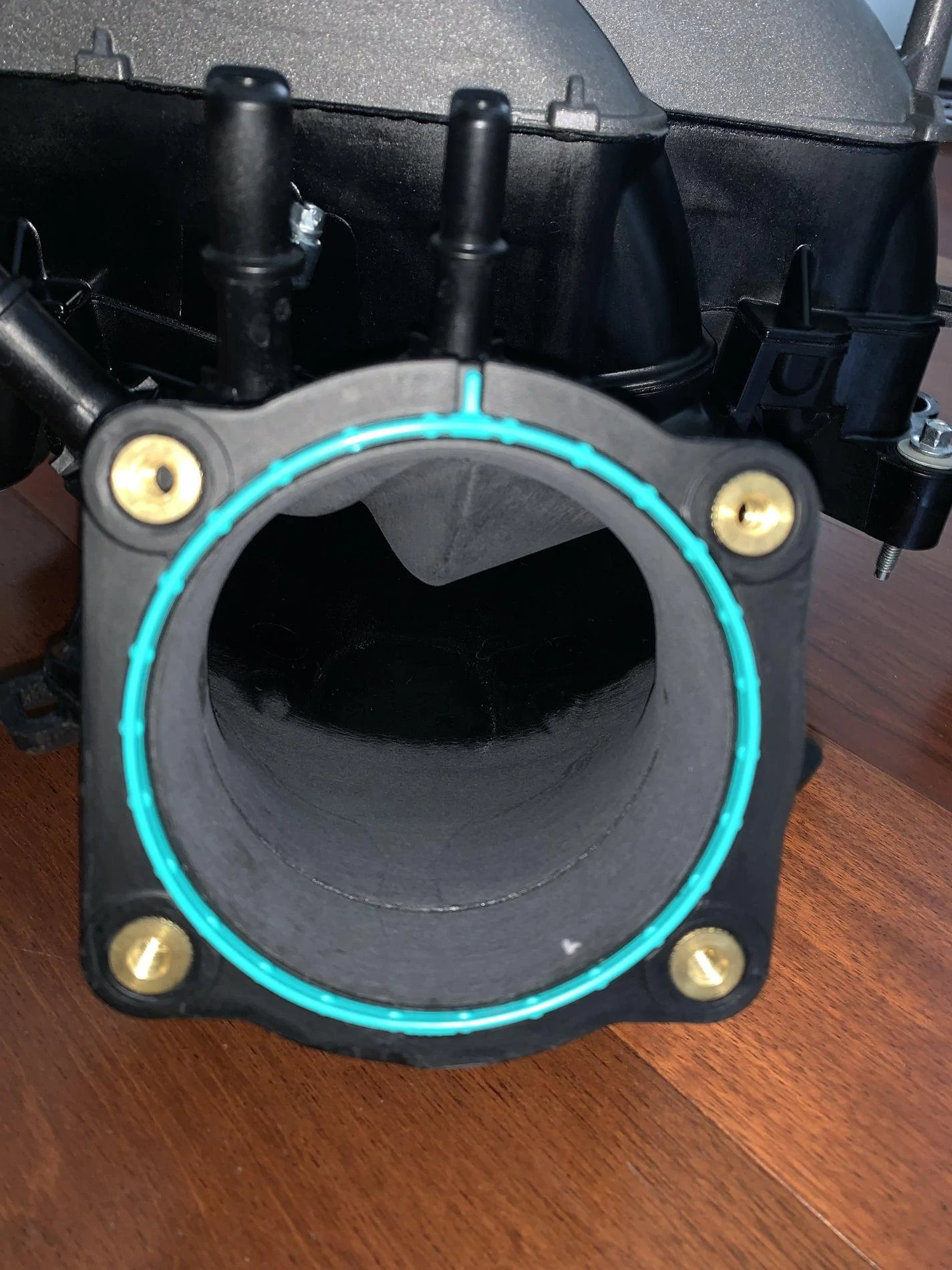

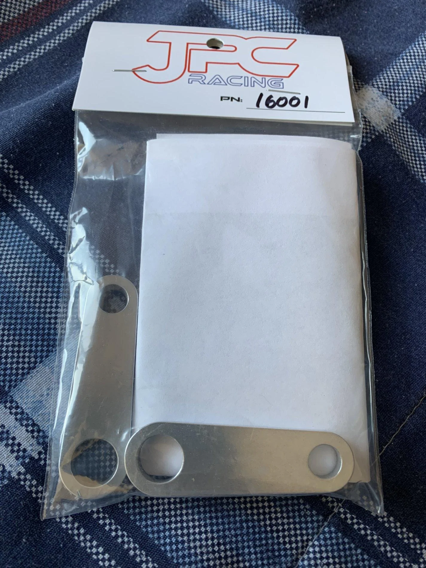

A dealership Parts Manager on FB was selling 18 mani take offs so I snagged one of those and I sent it to Bret Barber this past weekend to be ported. Went by JPC and got their lockouts for only $25.

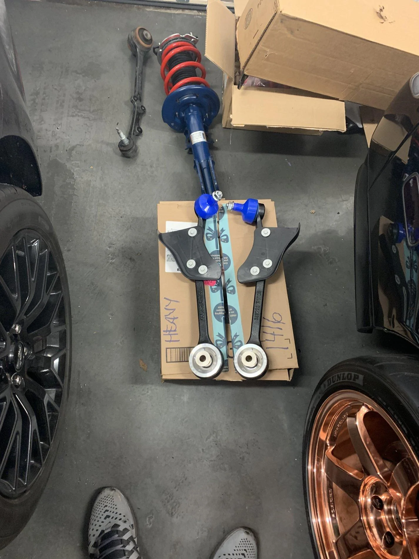

To make installation faster, I got Steeda Tension links and installed the bearings that I already had and a set of low mileage RLCAs from ebay to install the bearings.
I am just waiting for my Vorshlag shock mounts to come in and I will be all set and ready for my suspension overhaul next weekend. Been looking forward to this for a year now. I’m really interested in how different the car will feel. I know I will not get a complete feel because I am still on the stock Pirellis and I have 11.5k on the ODO.

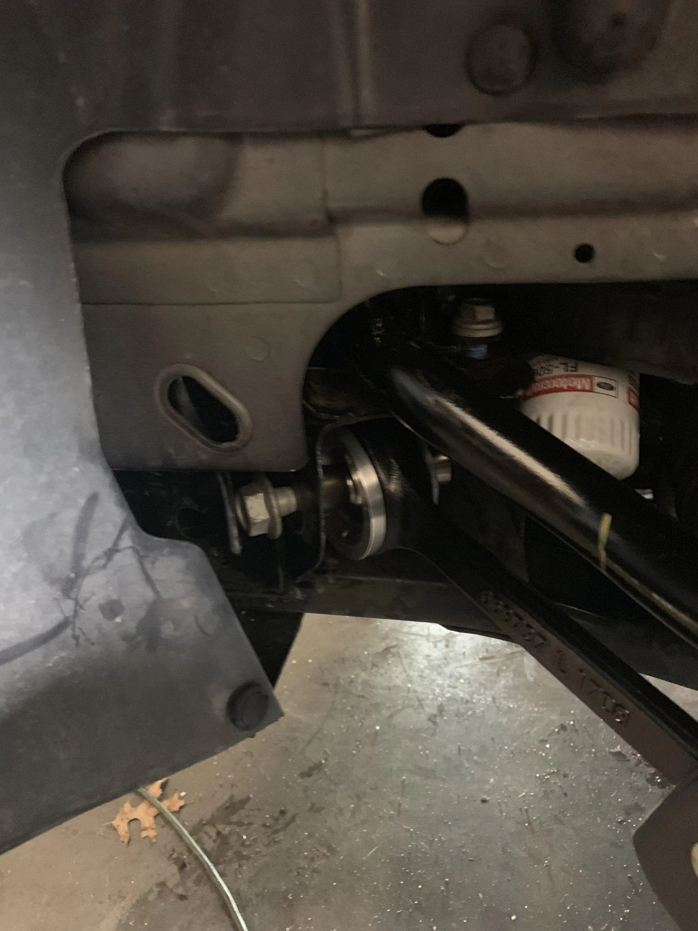

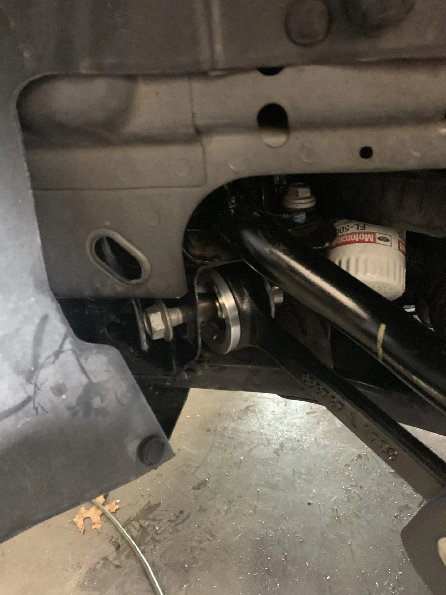

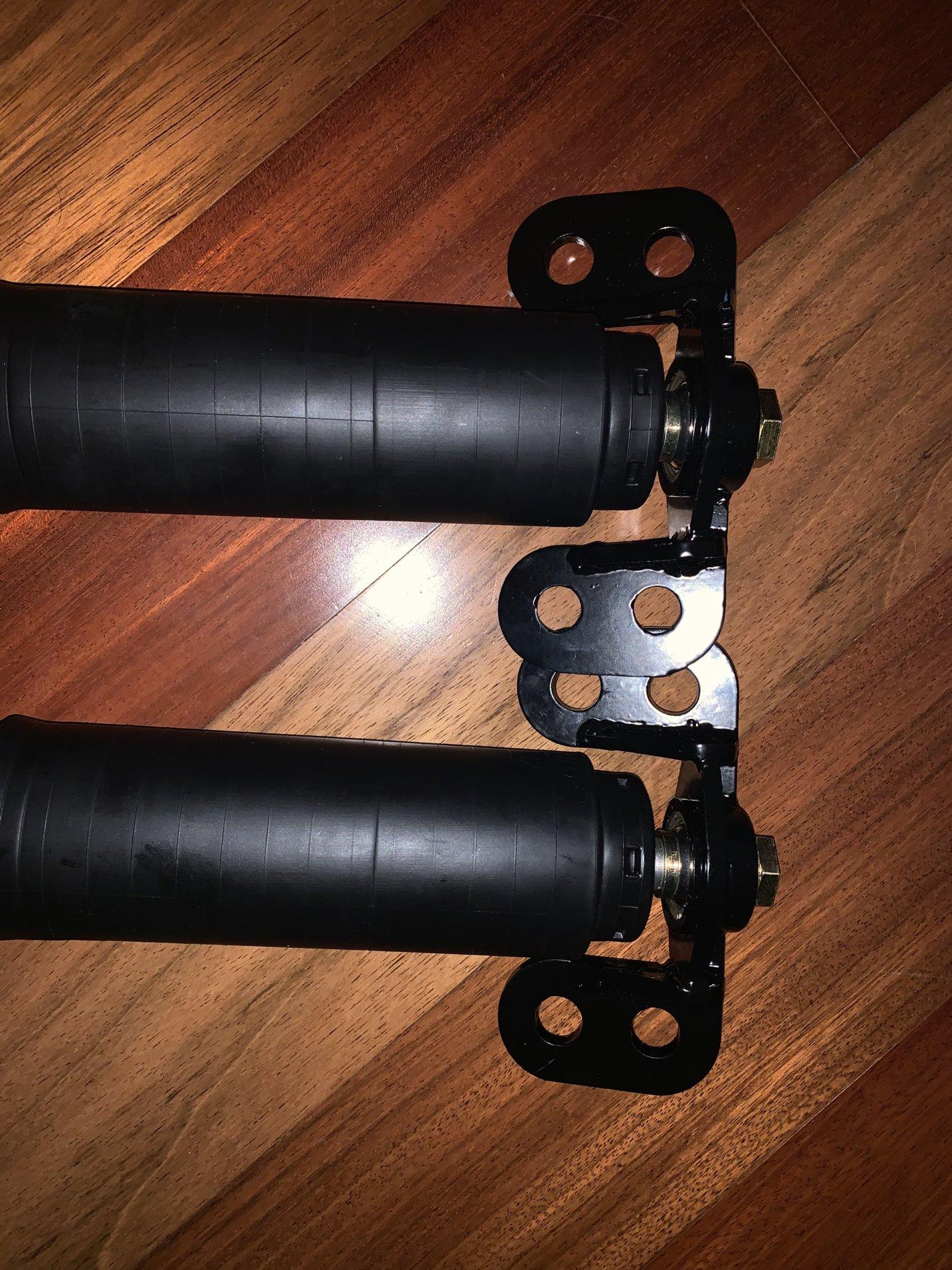

Vorshlag Shock mounts came in. I believe I installed it right. This was done by hand. Don’t have immediate access to an impact yet
BmacIL
Enginerd
Sep 21, 2014
69
14,989
8,910
Naperville, IL
2015 Guard GT Base, M/T
Yep that's correct.

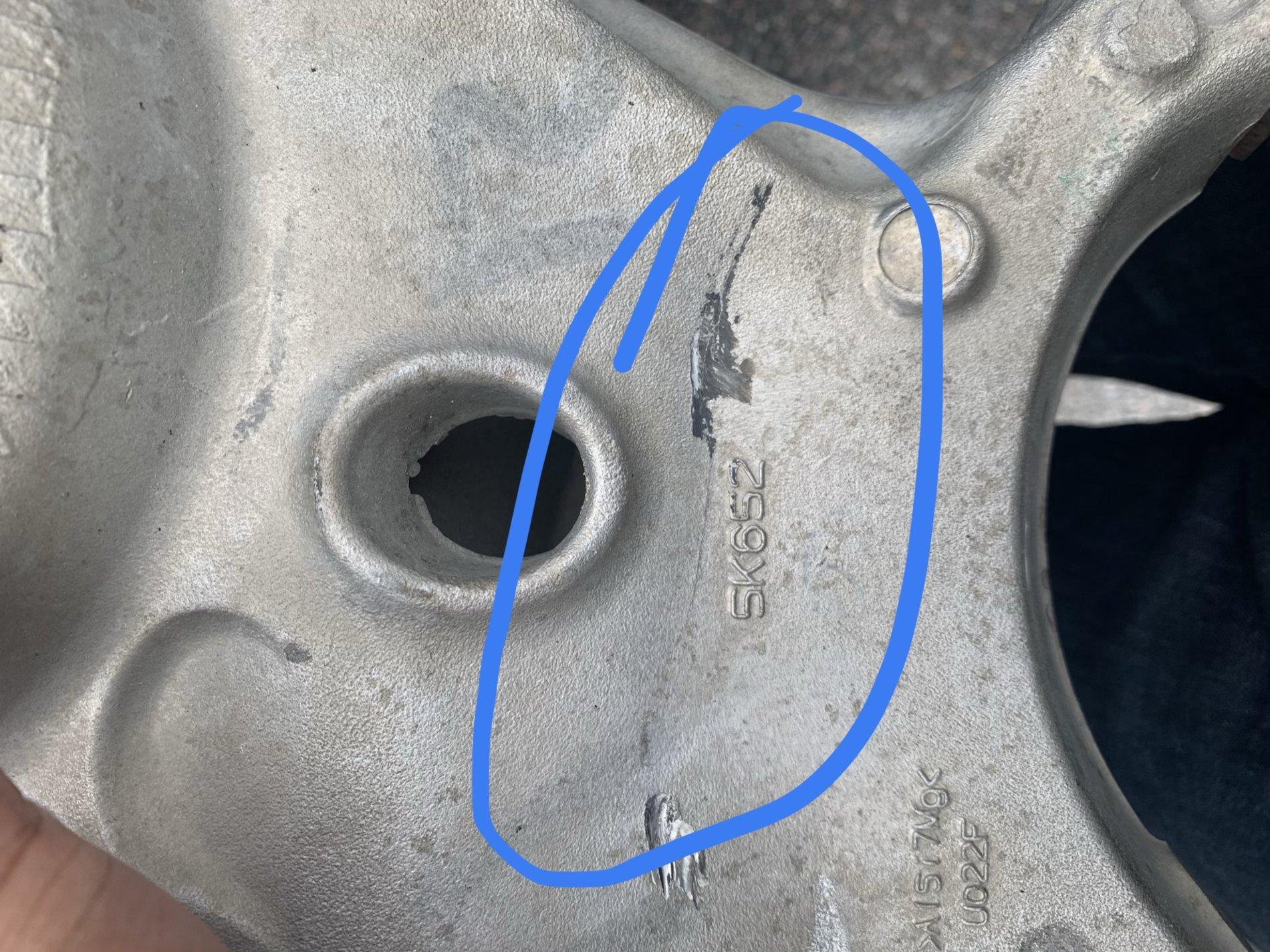

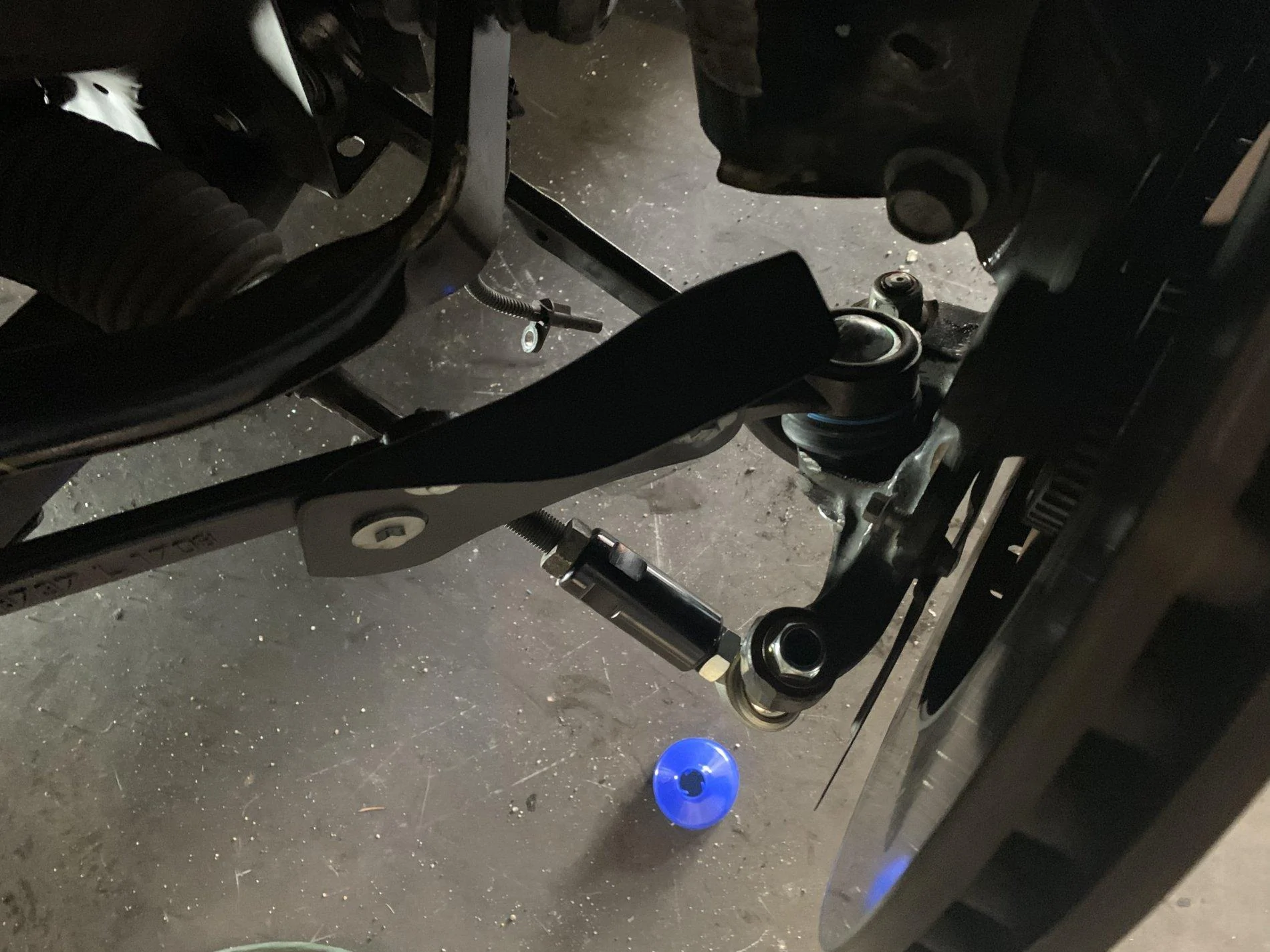

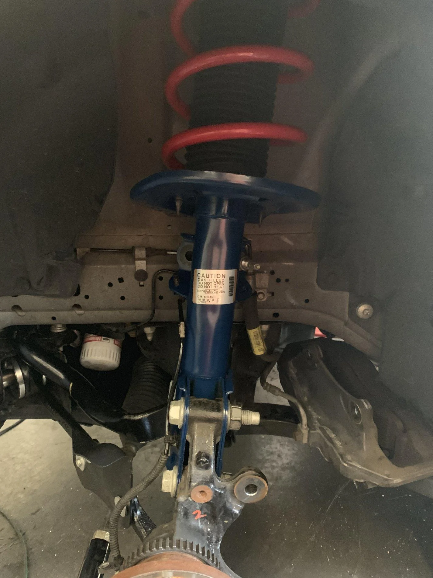

So this past weekend I finally did my suspension work...Things didn't start well being that I bought take off RLCA to get the Steeda bearings pressed in but when i dropped them off at JPC they called me to tell me one of them was cracked. Thankful that they inspected it before putting the bearing in. So now I have a bushing on the driver side and bearing on the other. So the place that i got it from is sending a replacement and Ill get a bearing pressed in that one and do the swap this week. IMG_8999.jpgIMG_8998.jpg
Started in the front with the Steeda bumpsteer kit and lateral arms with bearings, springs, struts and the CB006. Front sway bar wasn't as bad as most have experienced because of taking out all the other suspension parts to allow more room. Definitely plan on swapping out the flimsy sway bar end links.
To the back...hardest part was taking off the entire RLCA and put it back on. The most time consuming had to be the toe link bearing. When trying to get one of the rear springs out, my friend broke one of the sway bar end links so I currently do not have a rear sway bar.
The ride is terrible at the moment and I put down the car until I fix everything before getting it aligned.
We started at 8am and I didn't leave my friends house until after 11pm. This was my first time doing anything like this and it was my friends first time on a mustang, Definitely learned a lot and could save a couple hours if I were to do it again.
So the only things left are CB762 and CB005 kits and to swap out the new LCA. Oh yea, the rear sway bar once I get a new end link.

Those shock mounts are interesting! I’ve never seen them before. What is it about the ride that’s so bad??
yea i like to think of them as a cross between the BMR and J&M mounts. The ride is bad at the moment because I changed a lot in the toe up front. Everything used to help with steering was changed so as Im driving i can feel the tires up front moving independently if that makes sense. Cant really tell anything in the back because i dont have a rear sway bar and i haven't put on the 005 and 762 yet. Still need to get off these stock pirellis. But i believe after a serious alignment with Rev Auto, I should be good and it'll be drivable.

Oh yeah my 18 Mani came back from Bret...just need a tuner and a tune and I'll be good to go

Sooo quick update...since the suspension work, I have not driven my car because the alignment was out of whack and it wasn't drivable. My new driver RLCA was replaced by parts farm and i took it to get the bearing pressed in but just my luck, they were able to get the bushing out but the bearing slid in and didn't require much of a press and that is a concern so after not having a car for 3 weeks, I had to do what I was trying to avoid and had them use the control arms on the car and for them to press the bearing in during alignment and in addition to that was to complete the 762 and 005 install. Just got a call saying my car is ready so I will pick it up Monday. Will then see how right Bmac was about the feel of the car.

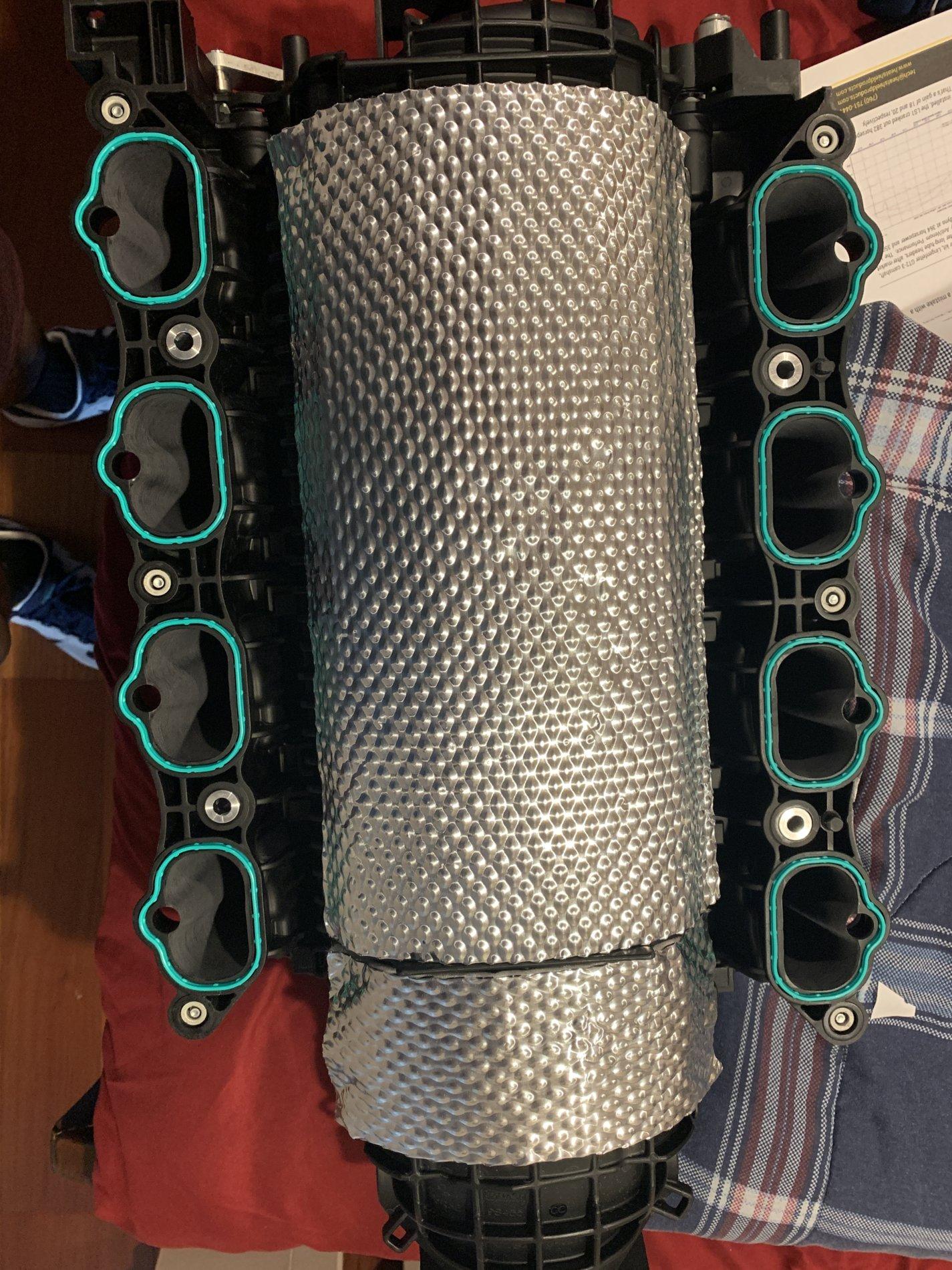

Added the Heatshield tot he 18 mani

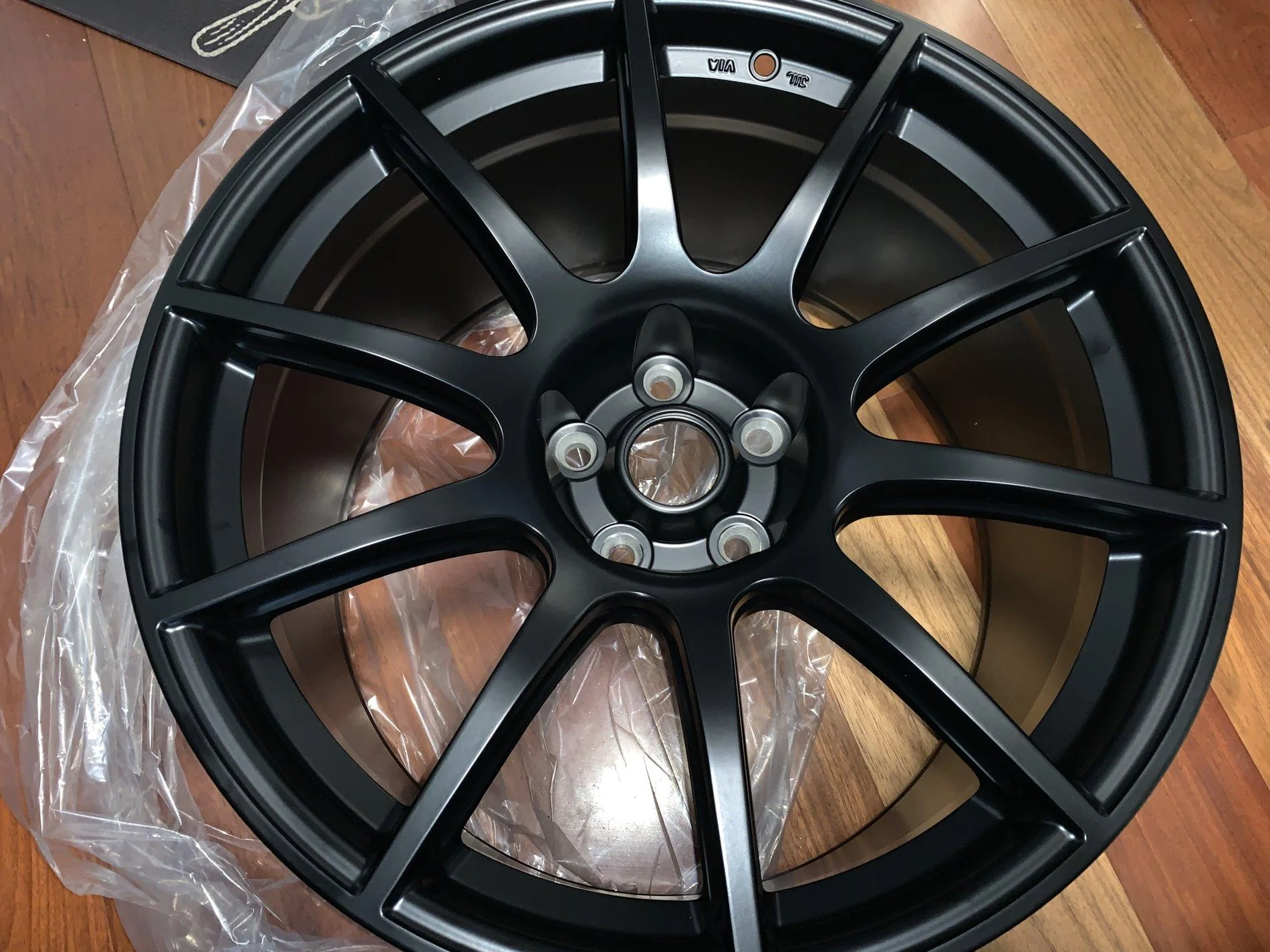

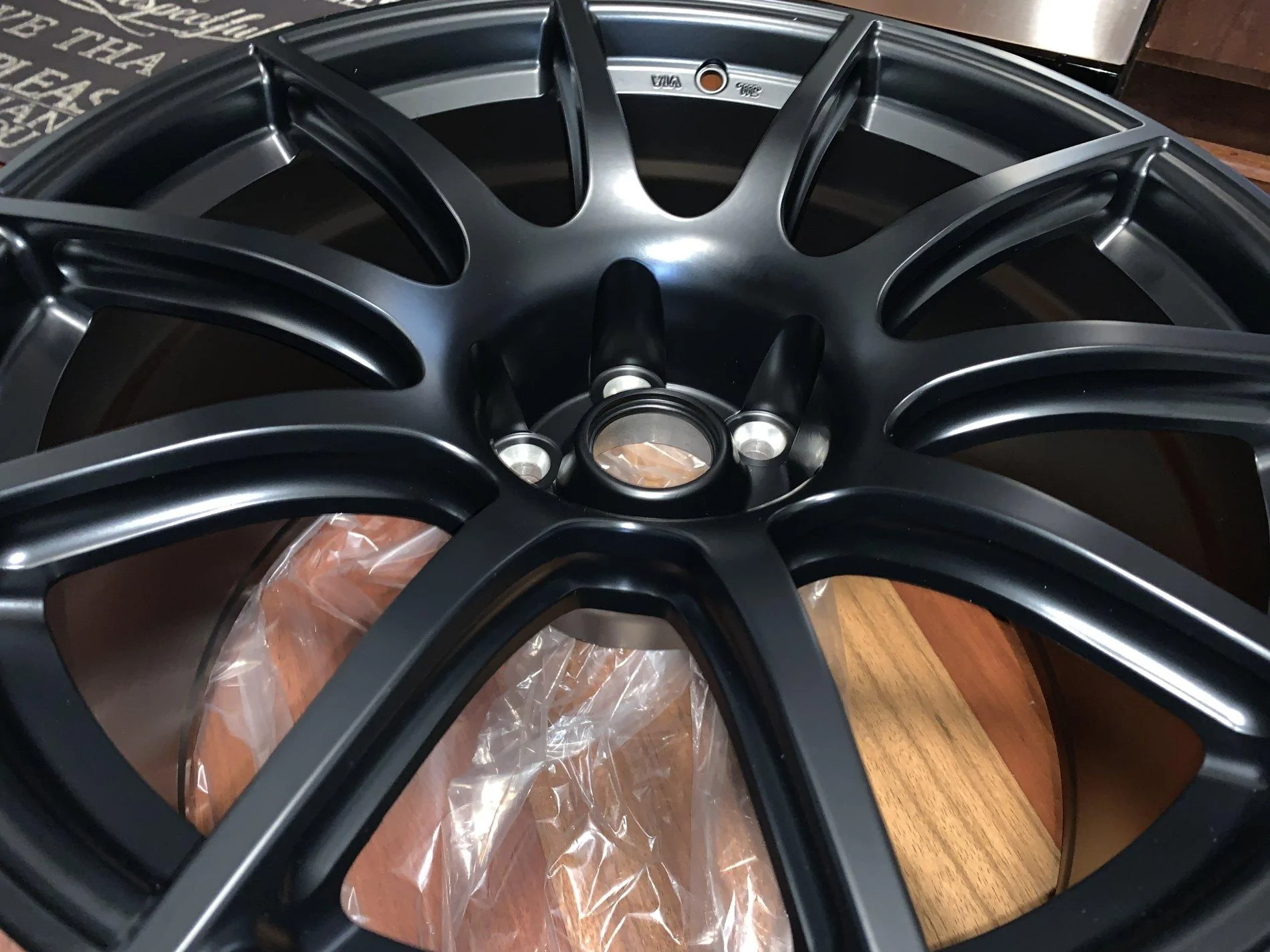

After staring at the computer screen and looking at so many pictures of fitments and playing with wheel tire calculators, I pulled the trigger to take advantage of the current sale and had the fronts delivered today. Decided to go with a square 19x11 set up but the front are +26 so no need for spacer or extended studs. will get the rears(+52) in a few weeks. Plan is to pick up 295/35 Conti ECS with a 3mm spacer in the back for flush fitment. Also in the plans before they get mounted is to ceramic coat them in addition to the Bullitt Brembo calipers together and install them together along with metal TPMS from OP Mustang

This set up is interesting. Those 295’s should fit perfectly on those 11’s. I’m also interested to see how the heat shielding on the manifold affects the iat’s
