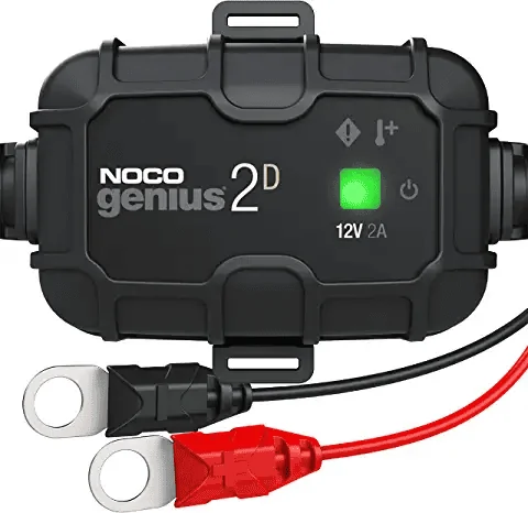

I have one that I just installed on mine today. I had it on my F150 that I traded for the Mustang and it would sit for 2-3 weeks at a time and it kept it up to date and ready to go all the time. I use the NOCO Genius charger. I got one that uses aligator clips but got a second one that has eyelets that I mounted directly to the battery and left under the hood permanently. Works great for me.

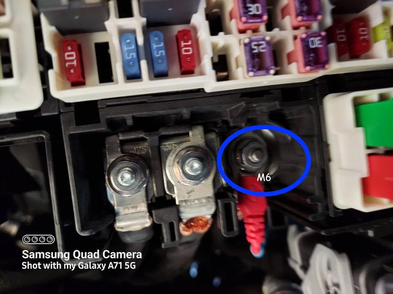

Installed mine this week. There are a few tender treads. Lots of great ideas, products and inspiration.
It's best to remove the negative cable from the battery, before starting any of this. Dropping a tool at the wrong moment can short something out, causing damage to you or the car. When connecting back up, the car is going to make all kinds of weird noises, several times, as it performs self-checks. Perform a BMS reset when done.
https://www.mustang6g.com/forums/threads/bms-reset-no-tools-required.151602/

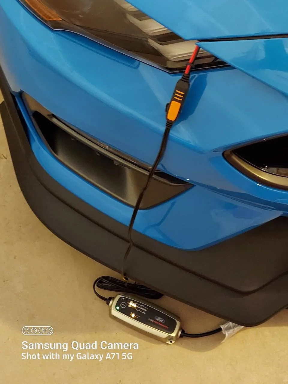

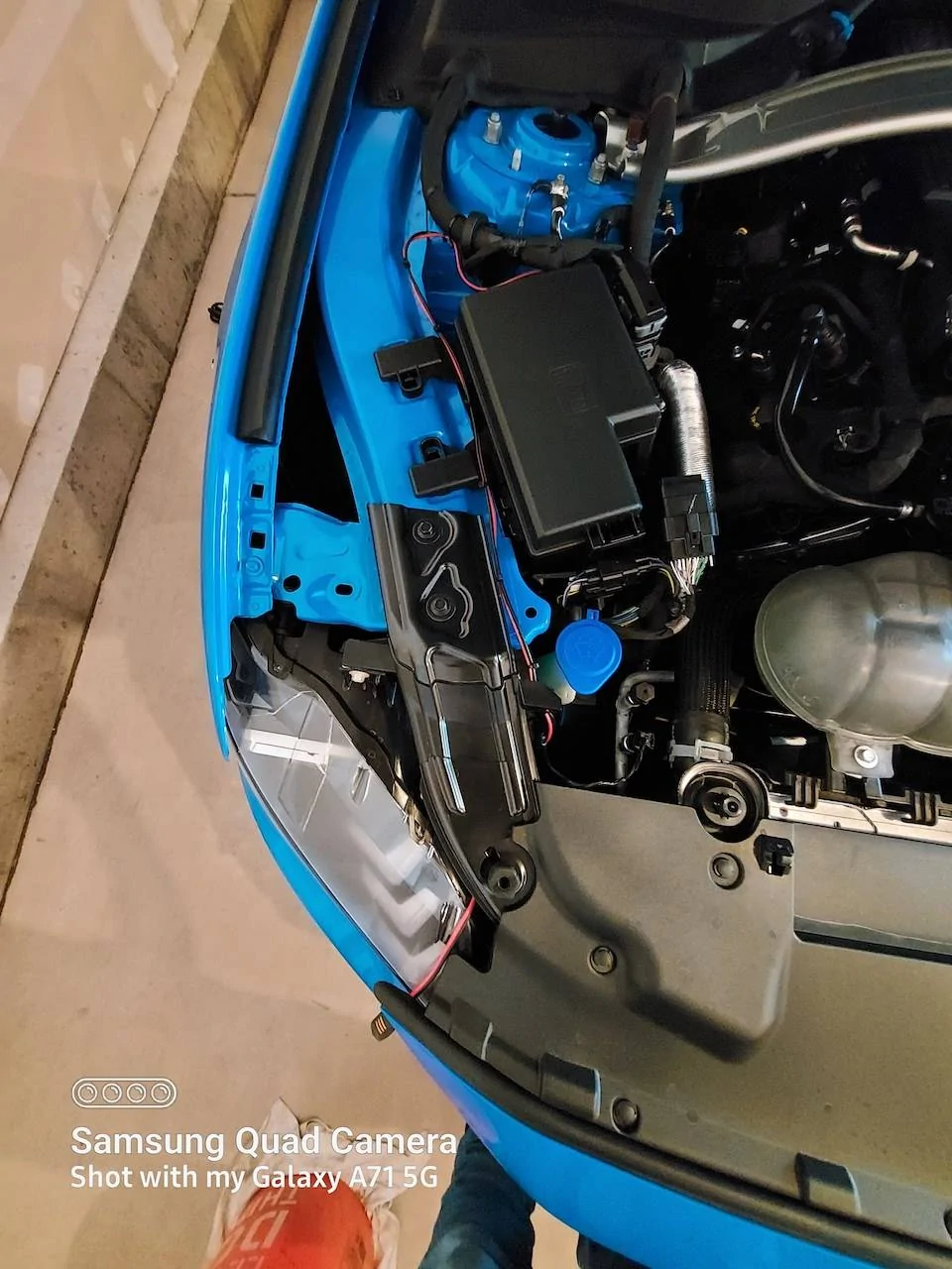

Yesterday, I attached my Ford Performance battery tender for the first time, to check it out. Using alligator clamps and leaving the hood up might be alright for the weekend, but it wasn't going to work long-term. I began eyeing the fuse block, another pigtail I had with the kit and these threads.
Thank You for the insight and the inspiration. Below are two options I'm playing with. Maybe these ideas and others might help you.
Cowl: the advantage of the cowl is I can tuck it under the hood and take it out as needed. To a passerby, it's almost invisible. The disadvantage is the hood closes snug and its a water area. The cable I fabricated is sealed with heat shrink, but still.

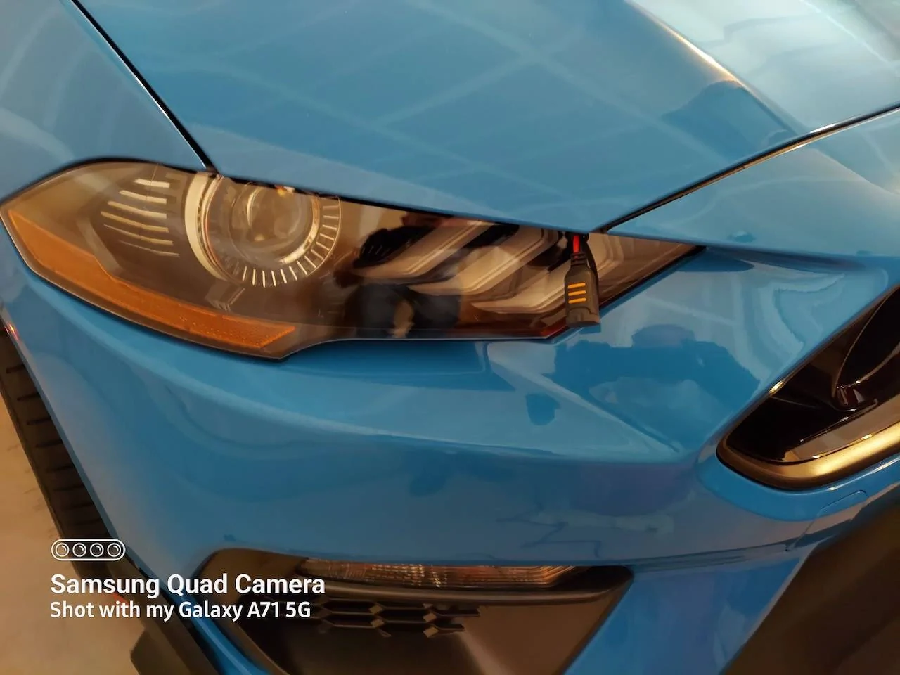

Front: the advantage of the front is all the wiring under the hood stays away from water, sharp edges or rubbing. But the plug poking out isn't very esthetically pleasing. I considered the grill, but it's a heat area and snug fit, for best airflow. If I Sharpie out the orange it will probably be less obvious.
For now, the front headlight area.
The advantages to either solution are not having to pop the hood, being able to hock up in moments and having a visual on the tender at any time.
