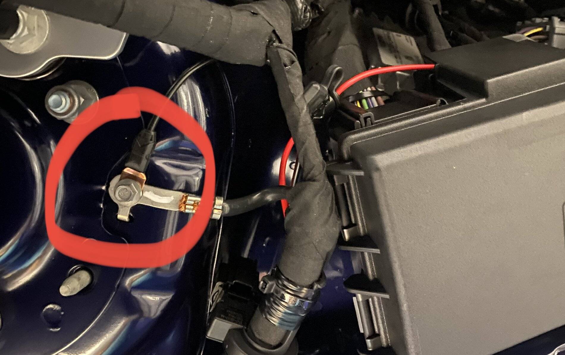

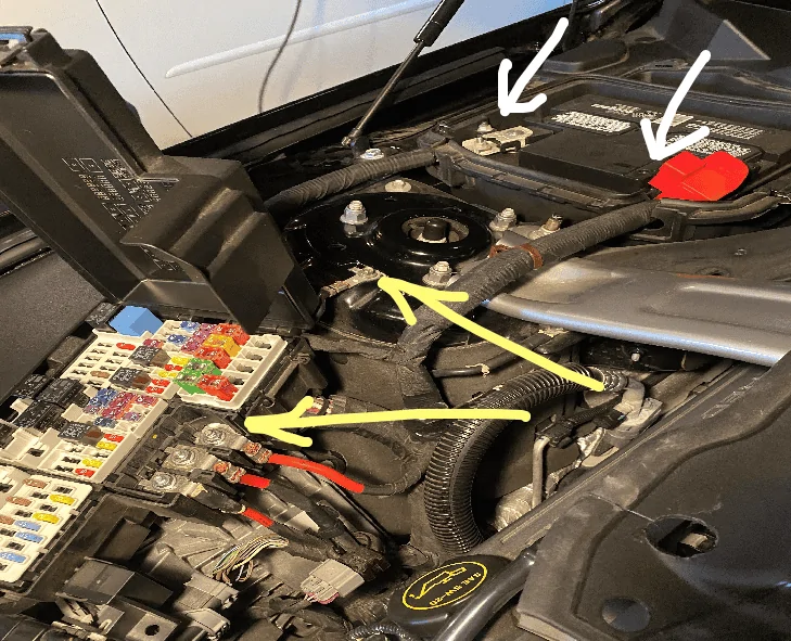

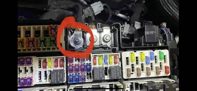

I was trying to figure out where to connect and was gonna start a thread with a pic on battery or Fuse box but … you answered for me :like:
If you wanna use you battery, only use the positive! And ground it to the chassis. Important: make sure you are doing the right way when you are handling Positive and Negative. That’s important the order.
Positive first, then negative. When disconnecting the cables from the old battery, disconnect the negative first, then the positive. Connect the new battery in the reverse order, positive then negative.”

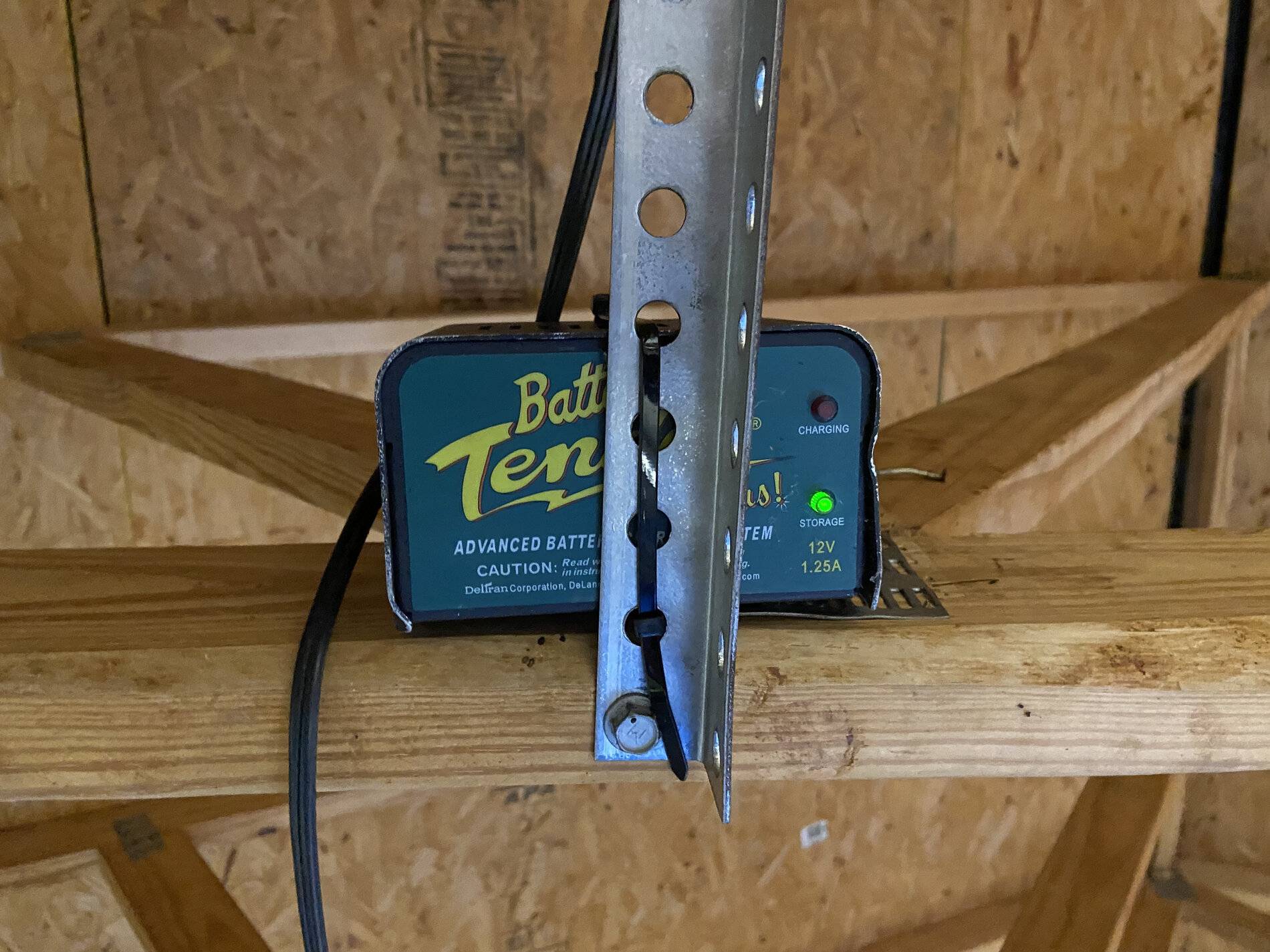

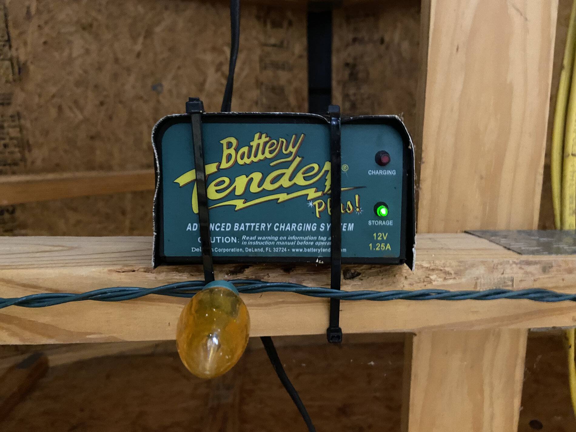

I'll stick with what I know is good, last long time.
30 year owner user, Battery Tender.
Here yesterday be there tomorrow. Plenty of cheap copies of the BT . None have the history .
