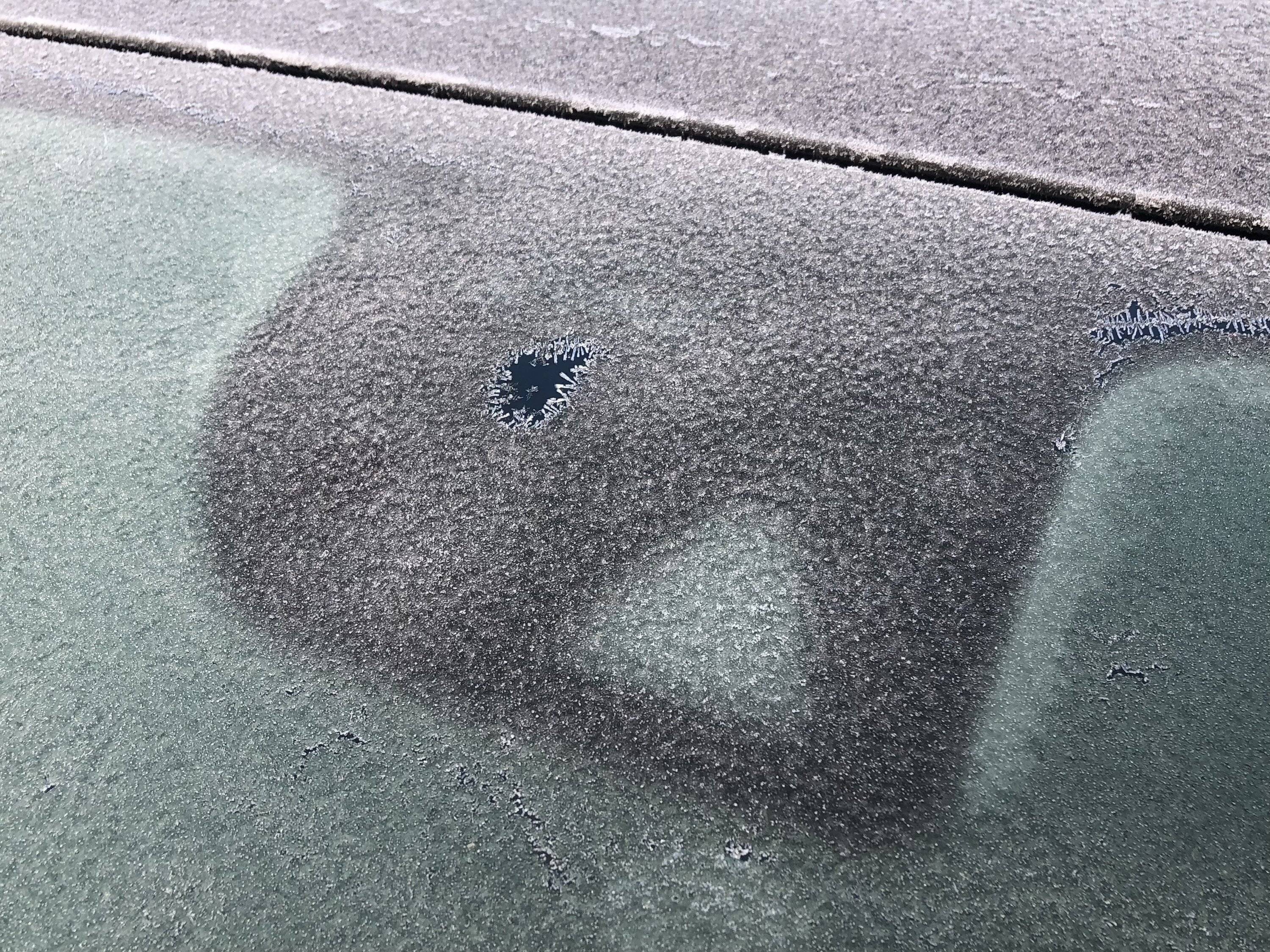

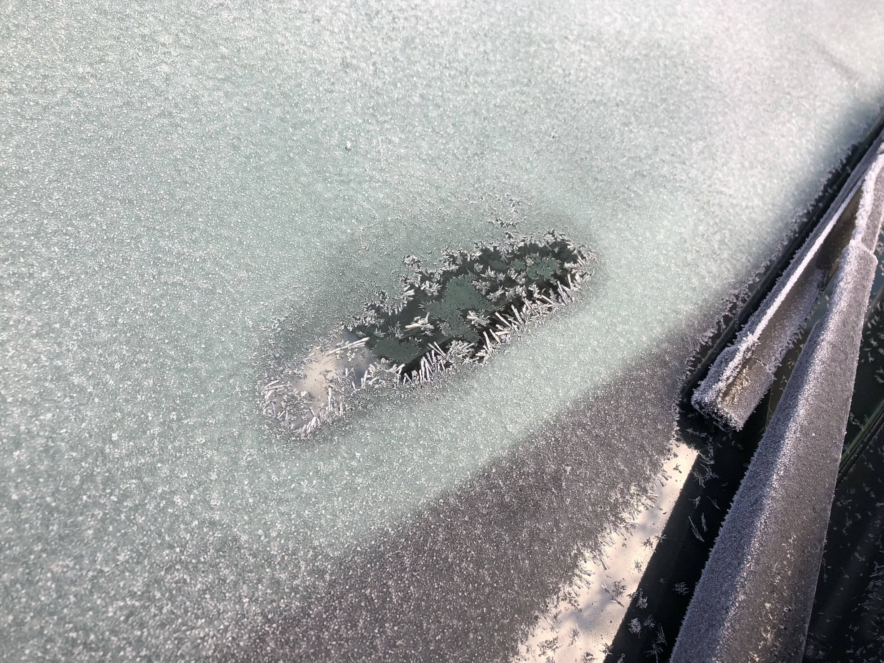

It might be normal so they don't see it as a problem, but there are some things that defo remain 'hot' on these cars (other than the obvious - alarm system etc).
I'm pretty sure @engineermike mentioned the throttle body does something odd every now and then, even with the engine off ?
Other than that, check out my two warm spots on my RHD (car had been stood for over a week so no residual heat) :
And I'm not alone, check out @paulm1 's matching spots on his LHD :
So there is something in the radar camera and also over the steering column / driver display that remains warm enough to keep mild frost away.
