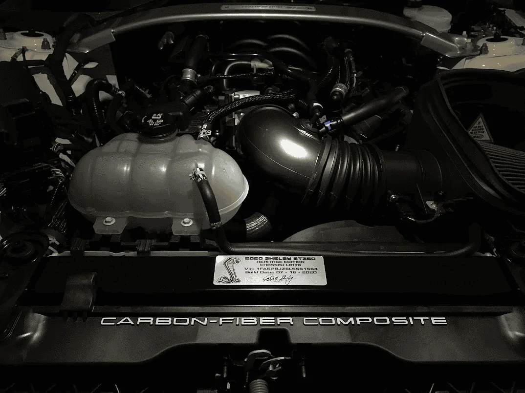

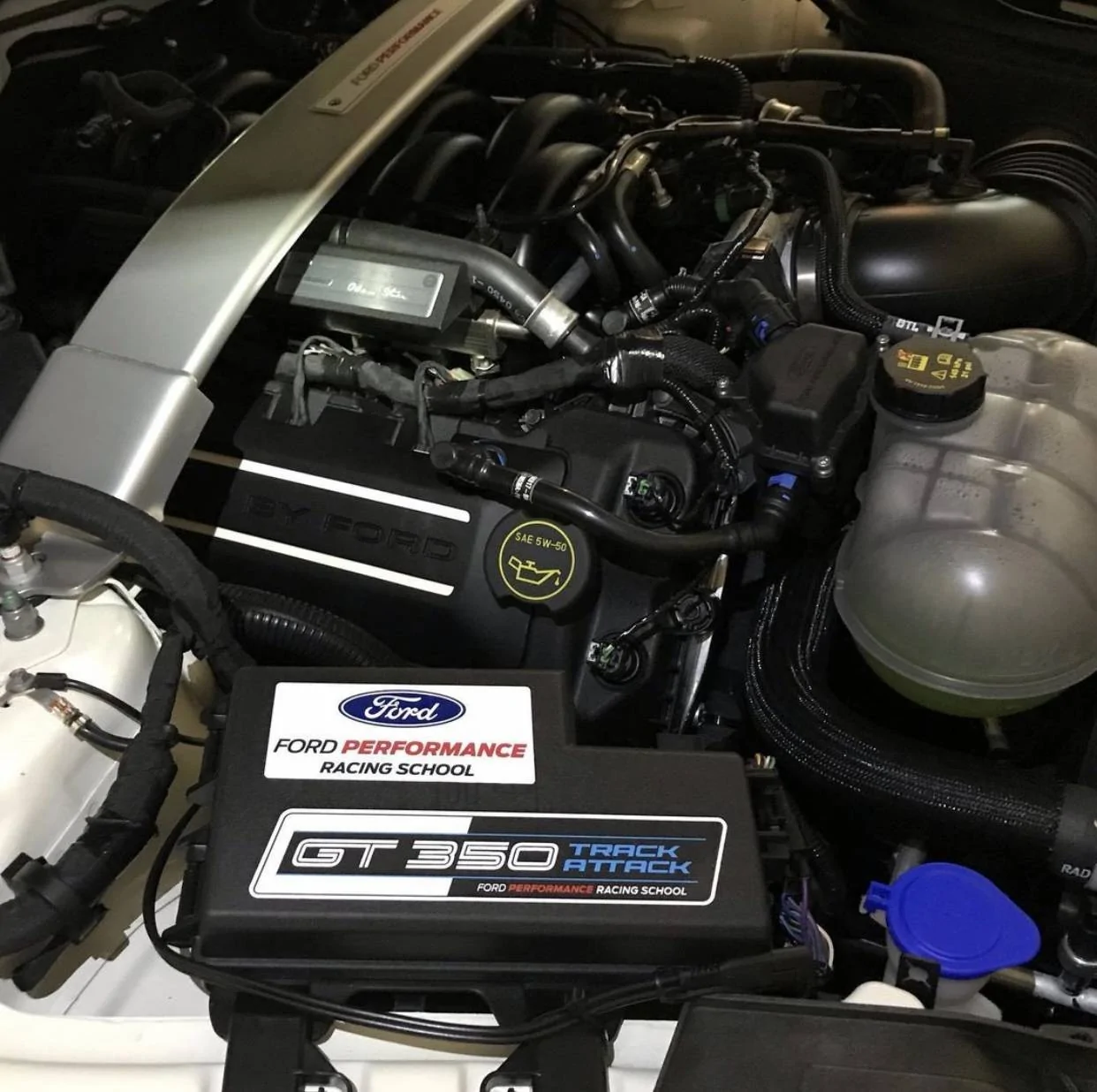

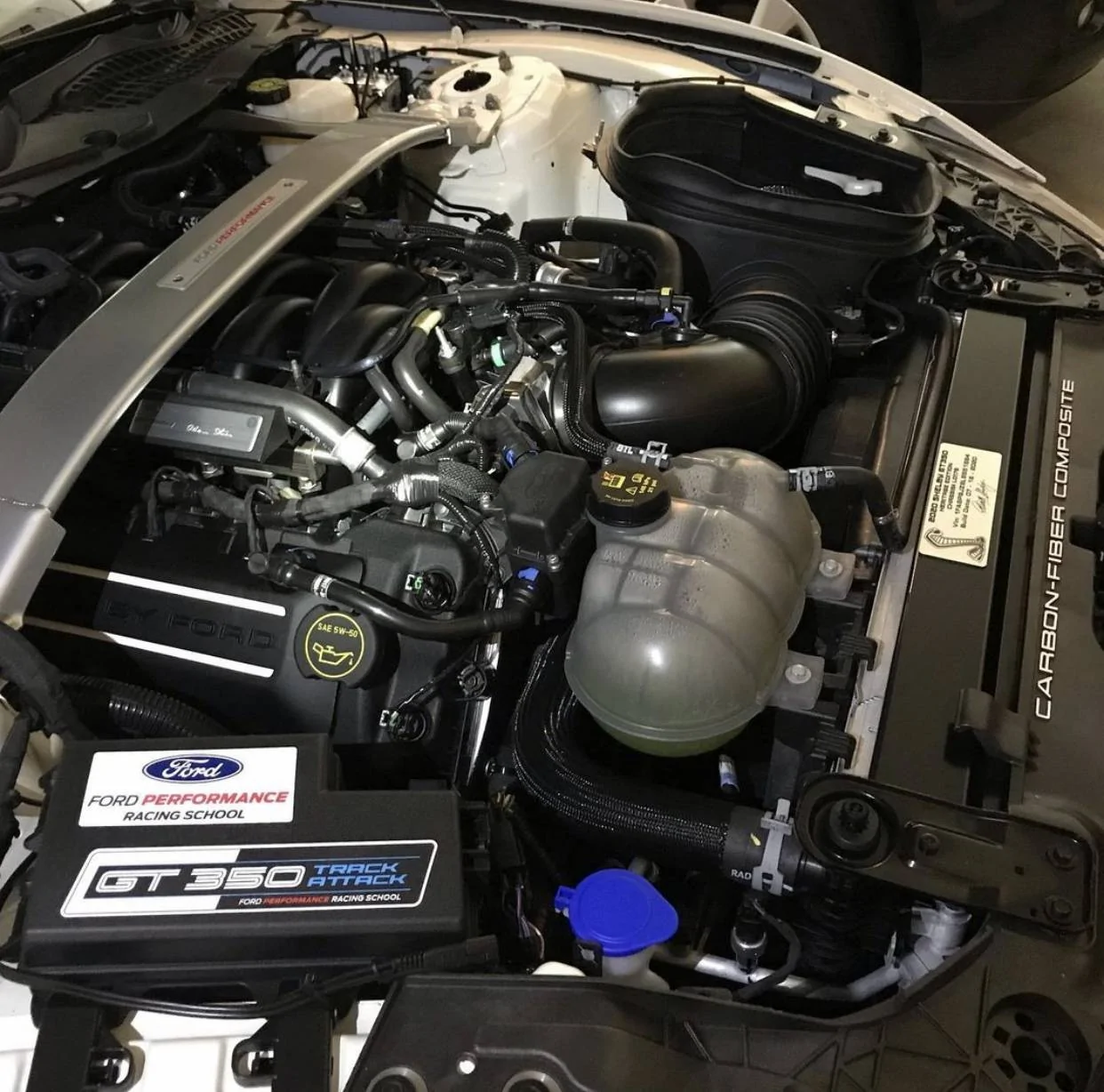

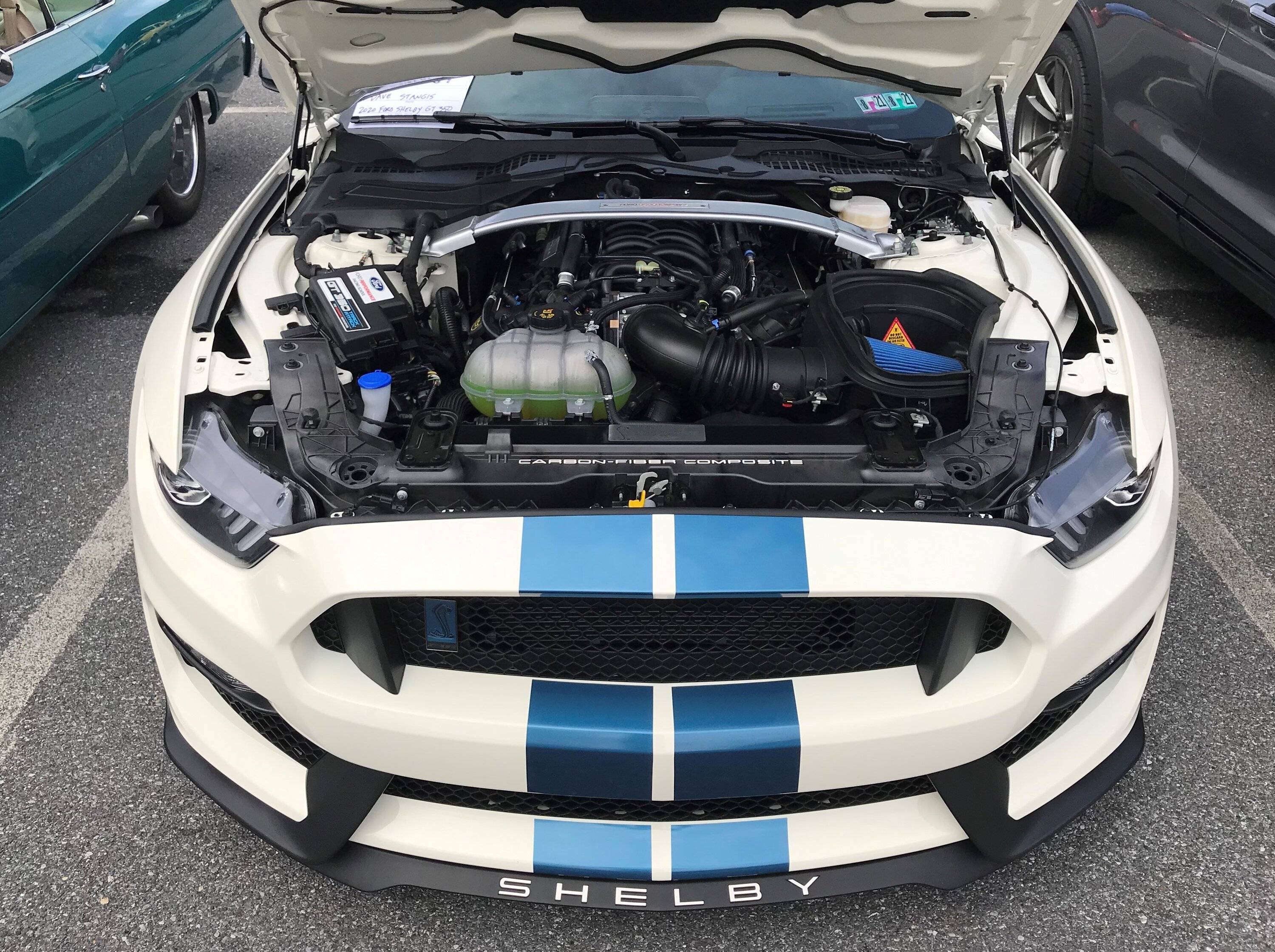

@dps Can you give a pic of your engine bay with all the Track Attack stickers, etc? Thanks!
Ha - always happy to share pics. I have a whole album :). I also have relatively new hood-strut wraps (Bemaro films) but no photos.

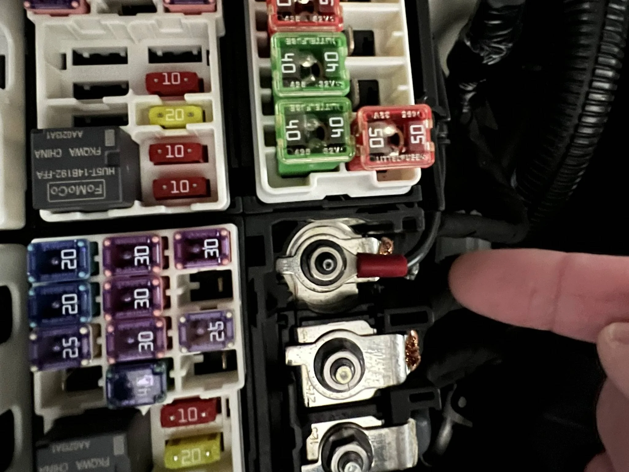

Well installed my tender to the fuse box. Hopefully that will take care of my battery drain issue. I read on some of the threads that I may need to leave it on for a certain amount of hours for the BMS to learn the charging. I was wondering do I need to do that or not since it is hooked up to the fuse box.

When you hook it up to the fuse box, the BMS will monitor the tender. If you don't want the bms to interfere, just go directly to the battery.

I went this way because it seems easier so I do not have to take off the battery cover everytime plus it can blend in. How many hours do I need to leave it on for the initial charge and will I have to do that everytime or will the BMS learned after the first charge?

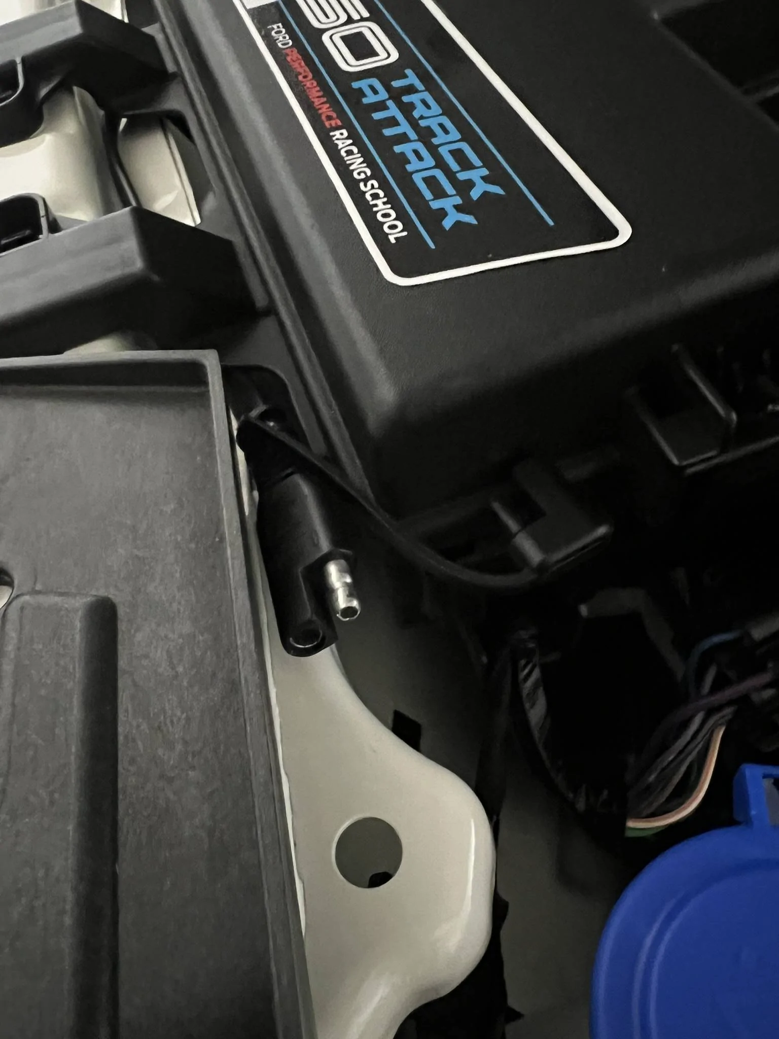

I put my tender on in the colder months when I know it won't be driven for more than a week. The tender monitors ands keeps the battery charged up. As noted, I'm wired to the fuse box.
