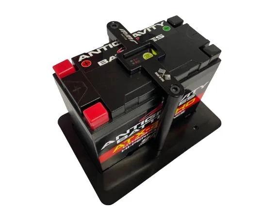

Can you give any details on the mount and what you had to do to make it work for you?
I bought a black plastic cutting board and cut it to fit in the OEM battery tray. I attached the battery mount to the cutting board and used the OEM battery hardware to mount the assembly to the OEM battery tray. Done.

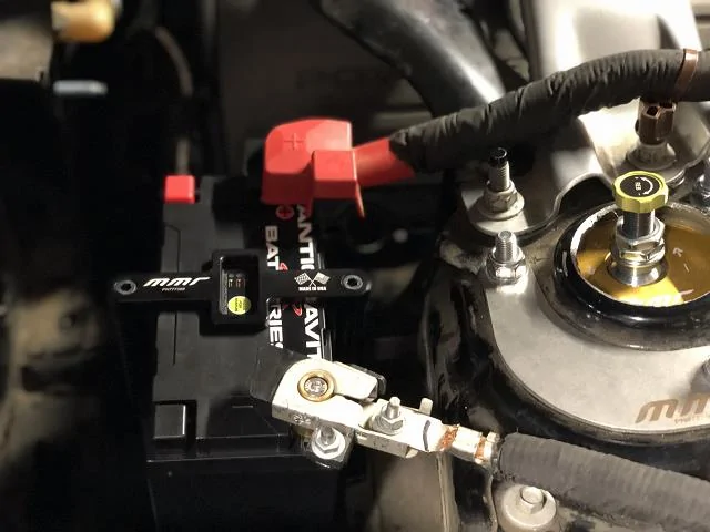

Don't you want to keep the factory battery box for multiple reasons?? Need the lid to seal against the hood and ensure the cowl has a factory finshed look, and isolating the battery from engine compartment heat/elements? From the MMR photo, it also looks like that barrier piece that runs under the strut/cowl brace is missing (you can see the coil cover through that area); not a fan of removing any of that.
You dont need to remove ANY of that if you do not wish, some people want it all out for weight savings which is the main point of the battery. Again, removing those items are all personal opinion and not a requirement with our kit. The Battery Box itself is removed but still fully isolated from the engine compartment and the battery cover can still be reinstalled.
