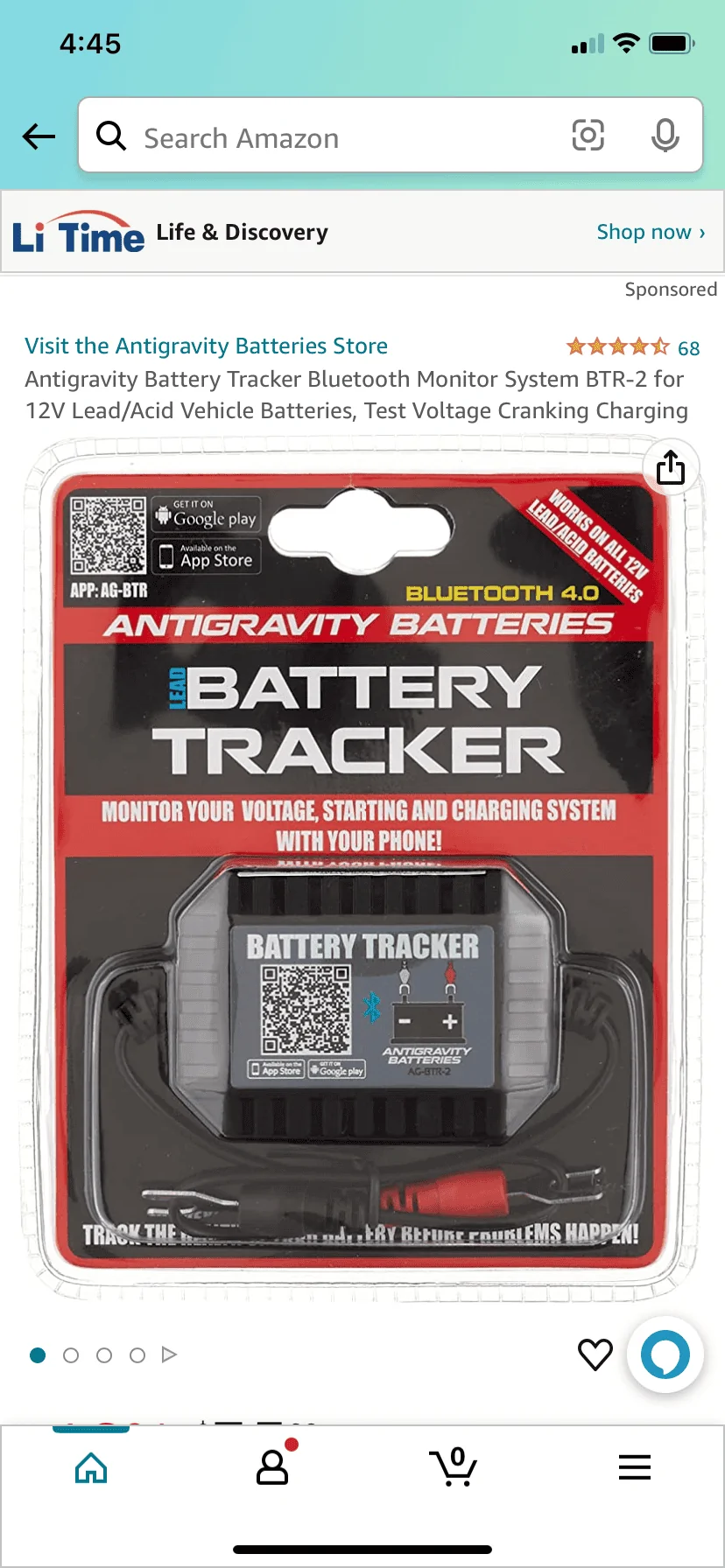

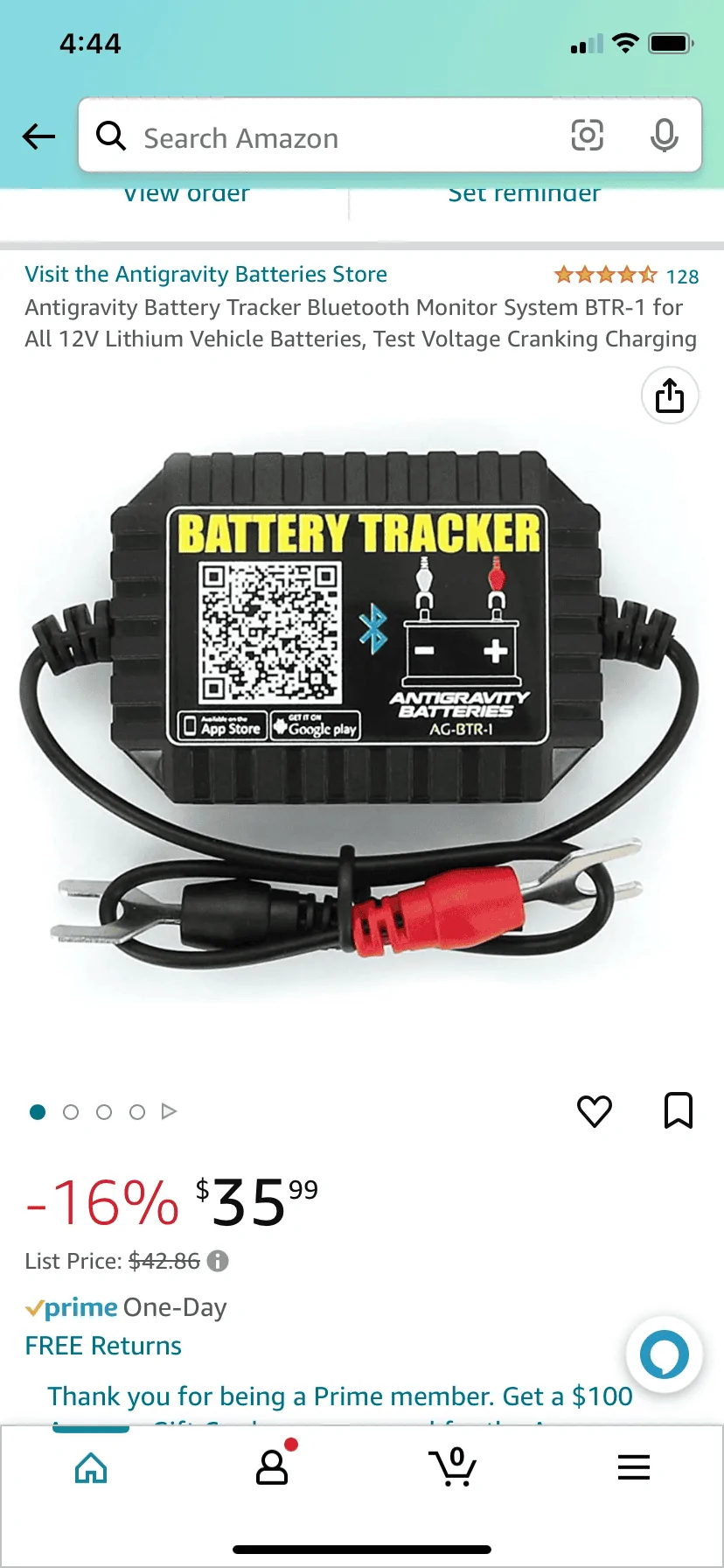

I bought the battery monitor device from AG and it’s installed. It’s awesome. My car hasn’t been started in 3 weeks, and my ATX30-HD battery is still at 81%. I make sure I never even bring the key fob with me when entering the garage lol. Car sits locked AND armed. The parasitic draw is under 25mA.
Nice how much did that monitor run you?
