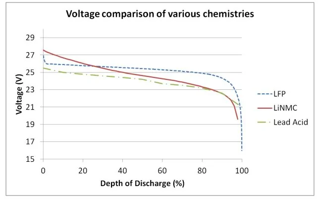

Smart Charging and Lithium
The only issue left is Smart Charging. Lithium batteries charge/discharge differently than FLA (Flooded Acid) or AGM batteries. Most notably they discharge at a constant rate. A lead acid battery discharges at a linear decreasing rate in terms of voltage. See example below:
LFP (Antigravity and similar batteries) pretty much hold a constant voltage. Think a new lithium power drill. It basically quits working once it's discharged rather than slowing down like an old drill.
So what's the big deal? Well Smart Charging makes sure the battery stays at a specific charge of say 85% for example. It may charge immediately at full volts after starting a vehicle but drop down on the highway once the battery is charged. This extends the life of the battery, improves MPG, and helps out with power in certain scenarios. Basically a more dynamic.. or smarter system. Pretty neat
The problem comes in the PCM knowing at what charge level the battery is. A big part of measuring this is just reading the voltages. There's a bunch of other factors but point is — Lithium batteries state of charge are read differently than lead acids.

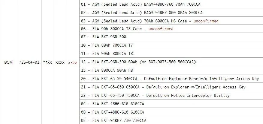

GT350 Programmed Battery Type
The stock value seen in forscan for my R is for a normal S550 Group 96R battery (incidentally not even the GT350's smaller battery). The code is "12" although interestingly some 350s come with "07" for a similar battery.
List of known batteries from the F150 forum. Yes it's for an F150 but the value of "12" found in my R correlates correctly as does the "07". There's a lot of shared values between vehicles.
