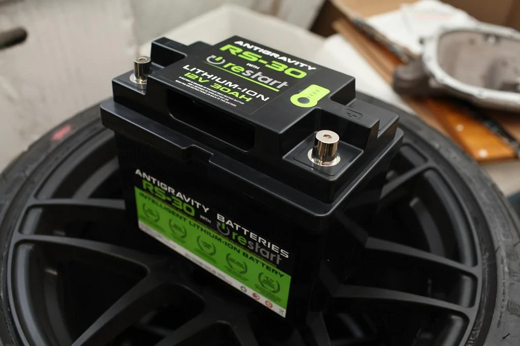

Is that the RS-20 or RS-30? Tell us more haha. It looks like the RS-30, which I didn't go with simply because it weighs more and costs more, and figured the ATX-30 would be suitable since I typically keep my car on a tender anyway.
Totally understandable. I DD my car, and often find myself traveling great distances (not towing) for races. It’s no fun waking up after a long drive in the middle of nowhere on a cold morning with a battery struggling to turn things over - if it isn’t already dead! Been there, done that, wish I’d known about Antgravity before killing a bunch of Battery Tender-branded options. If I didn’t have these demands, the ATX-30 would have been a no-brainer, but wanted to overkill things this go-around. - I’m sure you’ll be happy with your choice!

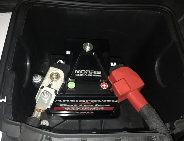

I hope you have better luck with the Re-Start technology on the Anti-Gravity batteries then I and at least one other forum member had. Our GT350 electrical systems and voltage regulator DO NOT play well with the Re-Start circuitry. I suspect you will have the same issues. The issues vary from misfires to random electrical anomalies. Frankly, I am surprised they sold it to you without informing you of the issues as I worked with them closely on my findings and result of the swap to the older battery. We were running the ATX-12-HD with the Morris Engineering mount even though the mount was made for the older style battery it worked. I am now running the older style ATX12-24 720 cranking amp battery with no issues. The S197 group have been running this same battery for a few years as well. I have one track day on it with another next weekend and several starts/drives as well. I just keep it on a CTEK LiFePO4 charger/maintainer.
Build thread here: https://www.mustang6g.com/forums/showthread.php?t=74433

No problem. Glad to help. I would not be concerned going with the older model as I did. As I said you just have to be diligent in keeping on a maintainer if not driving for an extended period of time. Shedding 20 lbs is nice especially above the front left wheel.
