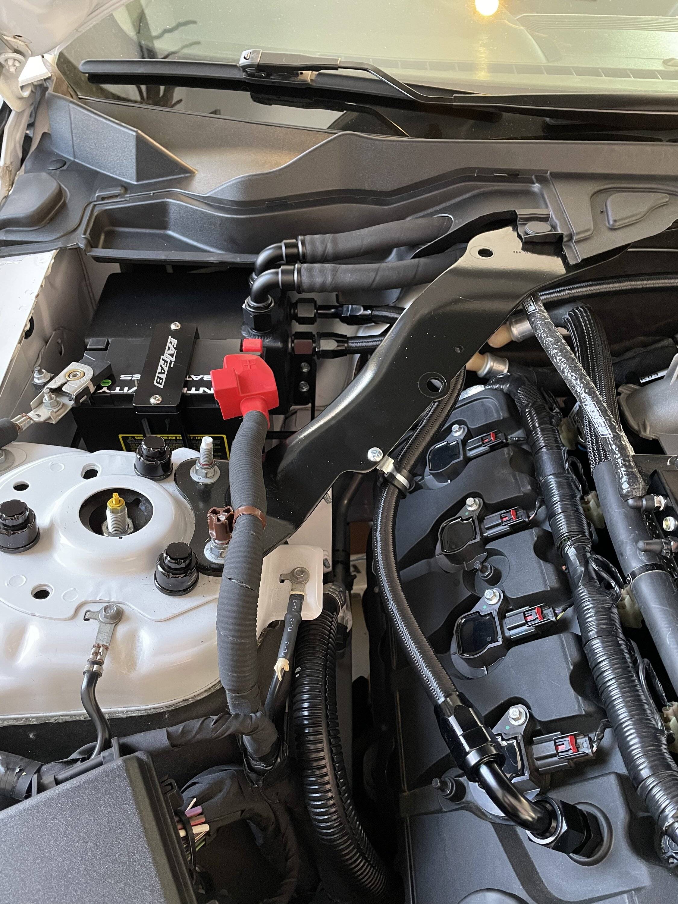

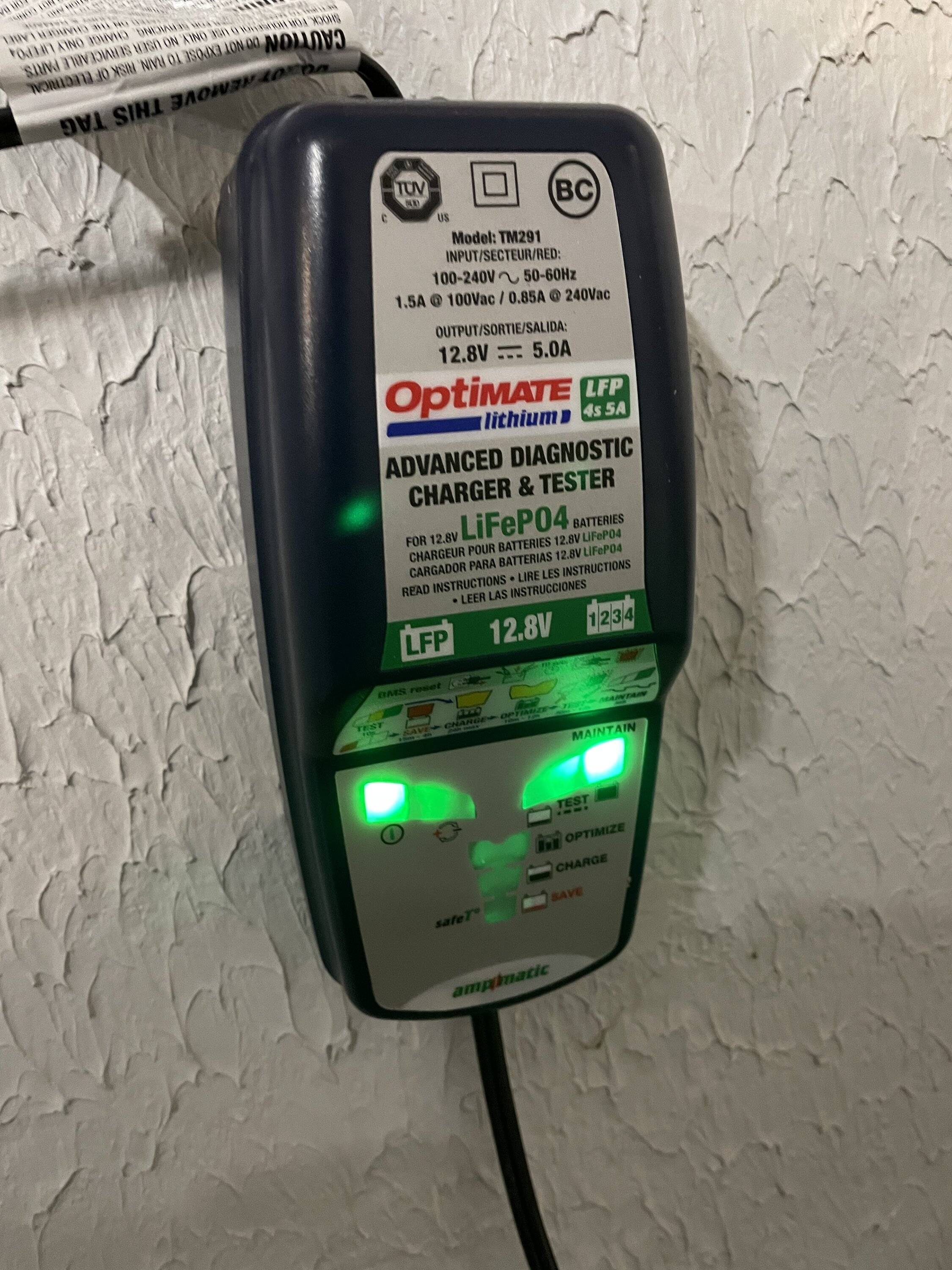

So I’m having an issue too. Wondering if doing the charge with non lithium charger will work too. Situation.. put AG battery in and no lights come on in the car.. nothing. I put the stock battery back in and no issues. AG is showing full charge and no issues.. any help is appreciated. Pictures attached

@LightGT Don't put a non lithium charger on a lithium battery. I did not do that. I hooked up a 12v jump start battery; not the same thing. That alone was enough to wake everything up.
You can for a few minutes to wake the battery if it's gone into protection. The owner of Antigravity instructed me personally to do it when the lithium charger wasn't waking it out of protection mode.
