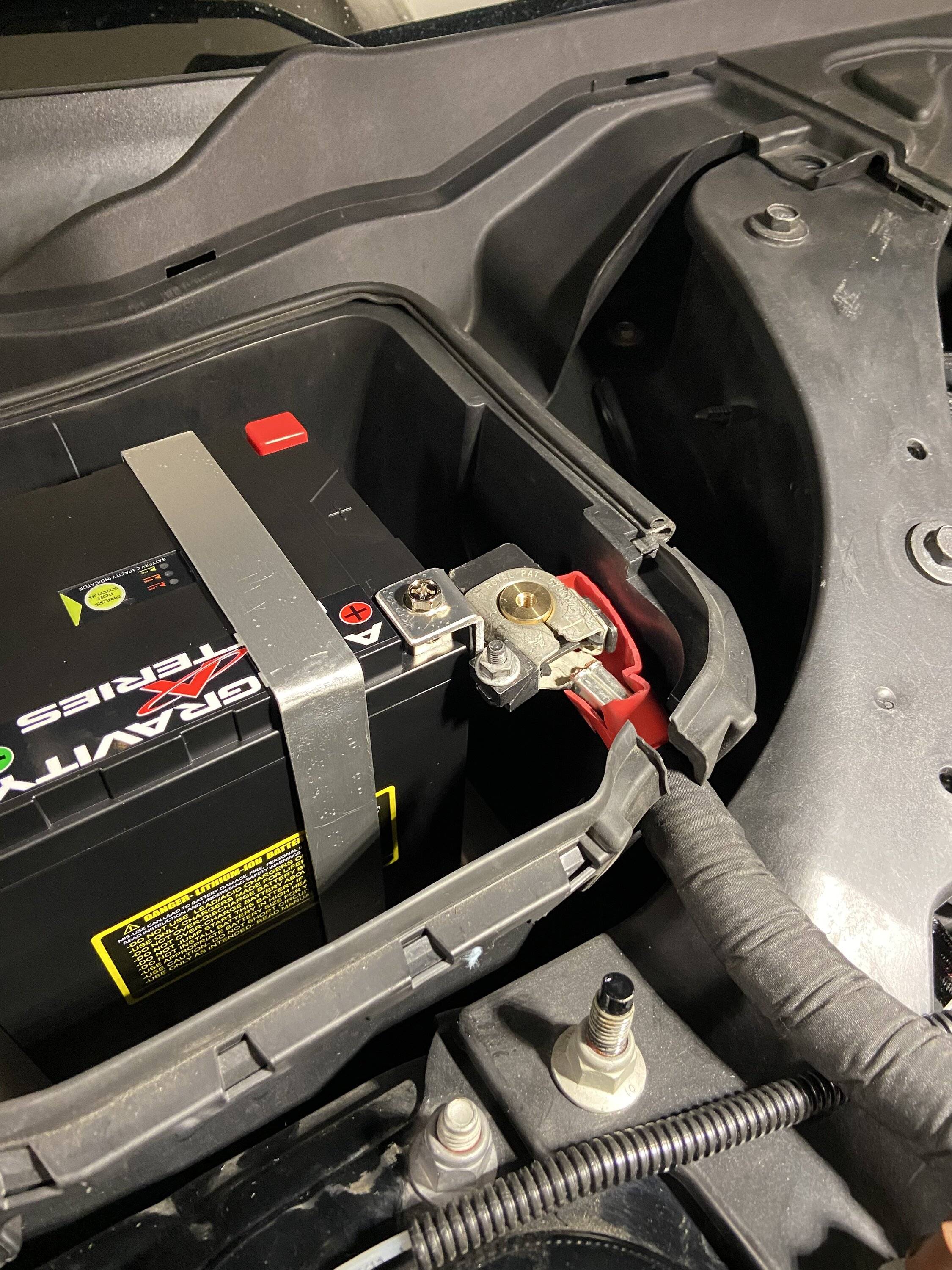

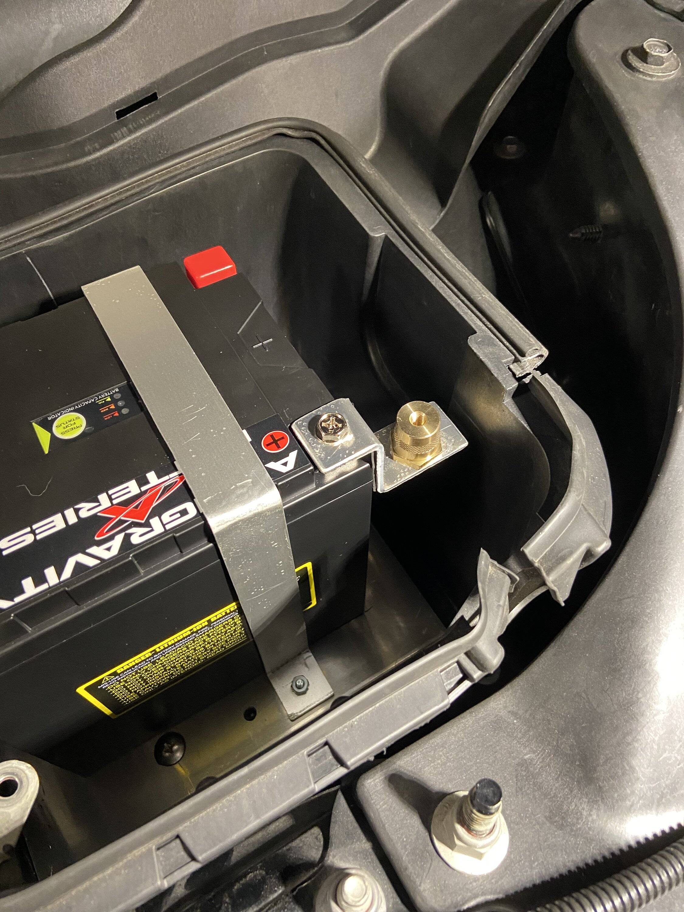

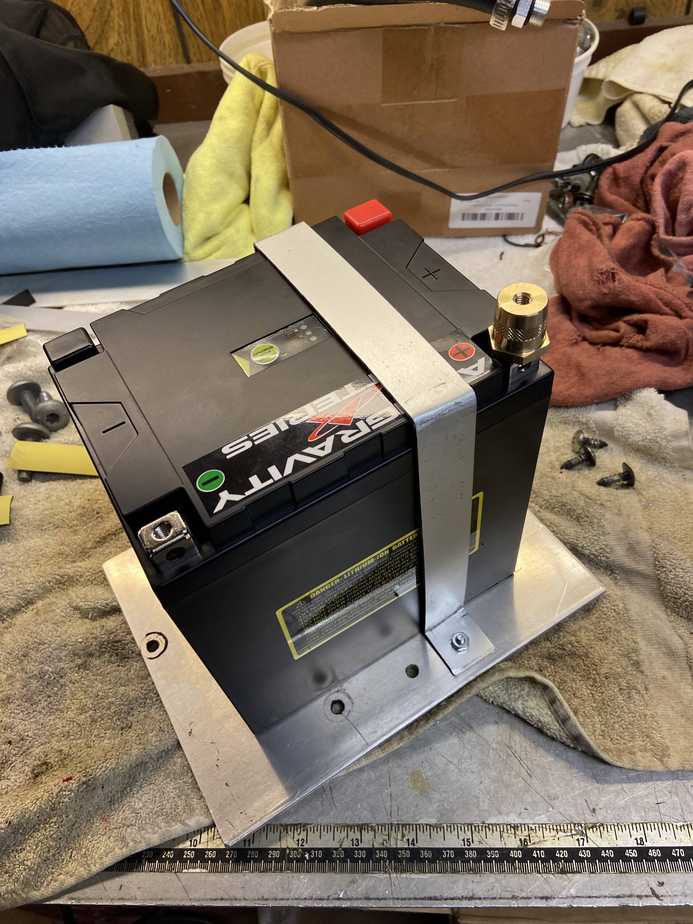

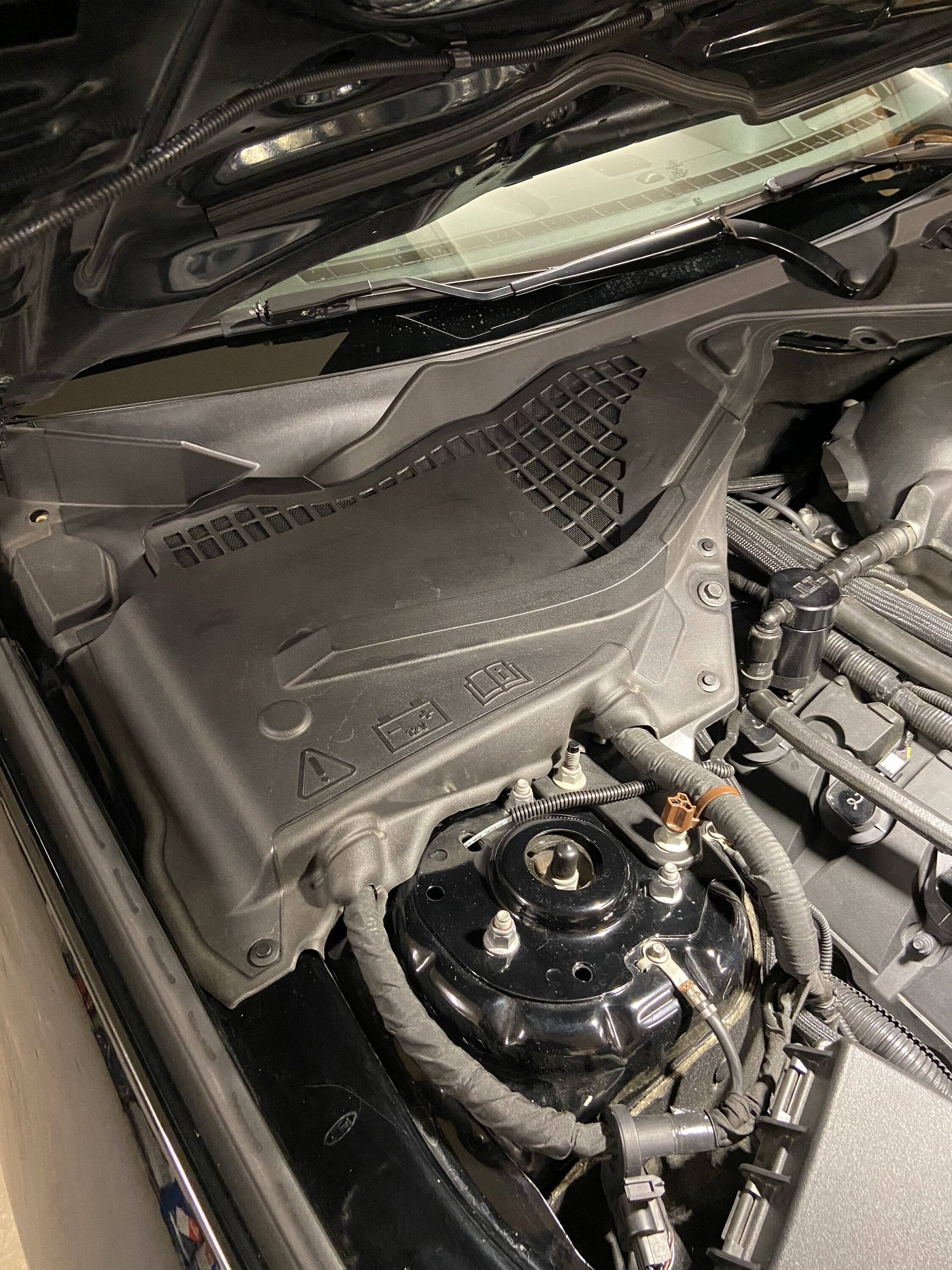

Here’s the ATX-30HD with the battery cover in place after a couple of hours of creativity. It wasn’t very difficult.

How is the base secured to the bottom of the battery box? Did you have to make any mods to the floor of the stock battery box to get it all to work?
Some pilot hole drilling and big screws. 4 in total. It’s never coming out on it’s own. That’s for sure.
