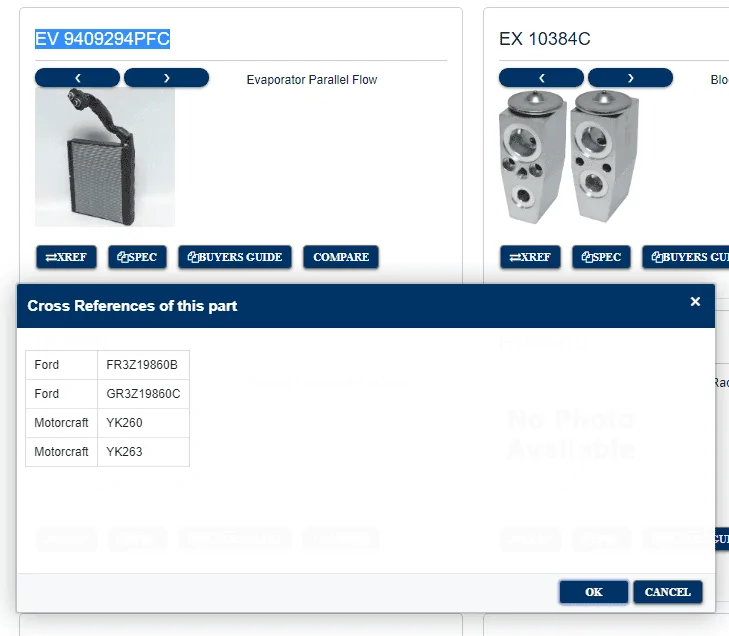

Ok so I am new to this forum and I too now have a failed Evap according to the dealer. I waited thirty years to buy a sports car and this is what I end up with. I have 37,450 miles on the car. The entire hood was replaced last month and now this problem. I am very disappointed with Ford. The dealer held my car for two weeks and Ford said no assistance will be given. Now the dealer will only charge $1,200 for the repair which is cheaper then what I see here but is still very expensive for a part that costs $150 or less. I will call Ford but have no expectation for them to help. When I do put my car up for sale I will never buy another Ford product or recommend them. Now I am thinking about doing this job myself, I am very capable of working on cars or just about anything. I would like to know if anyone has knowledge of the correct current part to use. The TSB shows this FR3Z19860B but also I see this part MOTORCRAFT YK260. Anyone know which is the best most up to date part for the job? Thanks for any info provided.
Both the same. One is the Ford part number the other Motorcraft. Take your pick.
Go to UAC's website. https://www.uacparts.com/Catalog/Index
Enter your vehicle info and then look under the part #EV 9409294PFC
And click the x ref tab under the item. A reference chart will pop up showing all compatible core part numbers.

Ok thanks for that link, now I see those parts on Ebay from UAC for about $60. The Ford and Motorcraft branded ones are around $150. Are those third party brands any good?
I purchased a UAC AC Compressor for my daughters CRV a few years ago. Never had an issue yet and works great. I do believe it has a 1yr warranty, same as Motorcraft. I would call and check with UAC first before you purchase.
Great website for research - thanks for posting it up!
