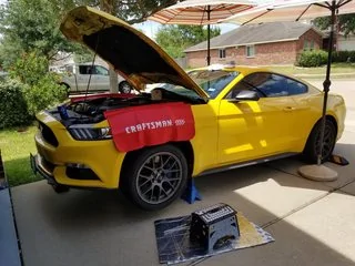

So I have a 2016 Ecoboost base with an automatic. AC had been failing on me in these Texas summers, reddit, this forum and the other says what’s happening. A bill for $2300 is really crazy to replace the AC Evap, the dealership quoted that and they want to replace the whole climate control housing unit (600-900 part alone) instead of the work to just do the AC Evaporator as per the TSB.
Big thanks to Rod Schneider for help with this as well. This project took me all weekend to do it. Started Saturday, finished Sunday. This is best as a two-person job. I had my dad to help, he’s was a big help and of course the one who taught me how to work on cars. So just wanted to share my experience on the whole ordeal. I use PDF manual, and found one free online too, and they compared just okay.

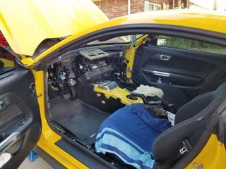

Big Step 1: Prep removal of FLOOR CONSOLE.
This is rather easy, use any of the “install new radio” or “base radio upgrade” in the youtube, and you see most of it.
Note to add here, not that center console is in two parts.
Big Step 2: Depower the Airbags, um I just disconnected the battery.
Big Step 3: WINDSHIELD WIPER PIVOT ARM
Big Step 4: COWL PANEL GRILLE
, ie the black stuff over the battery and windshield wiper area.
My dad removed the linkage of the wiper arms to help aid in the dash bolt removals.

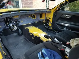

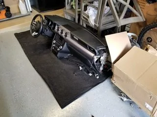

Big Step 5: INSTRUMENT PANEL
The cowl bolts remove them. Jack the vehicle and disconnect the selector level cable. Drain coolant too while you’re here, or later, but before Climate control removal. Undo the bolt/nuts, and the shifter and stuff all just come off, after wiring disconnected. More body/trim panels (I would do these with the rest, I did these before removing shifter, just because I was already tearing out the center, why not get the other panels too. While you’re at this, get the upper door panel trims too, and disconnect the speaker and wires, this doesn’t need to be a last step.
Remove Driver Knee Airbag- There are bolts after you pull a few clips. There are nuts that go behind into the dash, you can definitely feel for them, I used shallow socket.
Hood Latch Release: I used the CJ Pony Parts video for this, it’s 2 minutes long. Use small screwdriver and a ¼ 10mm socket, and this will finish up the rest of the interior/door trip removal.
Big Step 6: Steering Column and Get Dash out: Basically disconnect Steering Column and all wiring to the dash and glovebox area. None are the same, and all connect in different ways and styles of locking. It’s not fun, removed seats would have made this better. The A-pillar bolts; the door bolts; the upper is 13mm and lower is 10mm… and they do not come off unless you take the door off, so think of them like the lower receiver pins in an AR15. Captyive. This is where you need the ratcheting wrenches, the socket and wrench combination will get it loose, but to get it all the way out you won’t be able to get the socket back. These are rather long, 3 inches or and will go straight into door. You’ll know when they’re off. Removing the dash out is a two person job, it’s just so bulky. It’s not necessary very heavy, just clunky to carry. So you learn that the shifter really need to be out to make this work.

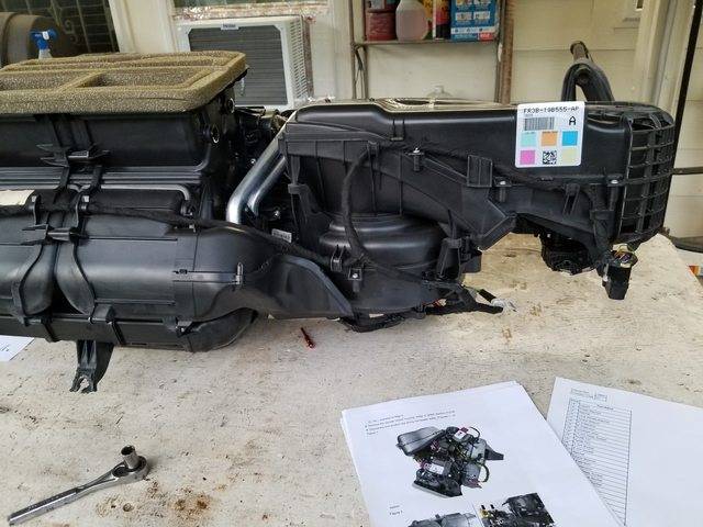

Big Step 7: Remove and Disassemble the Climate Control unit. Taking out the Climate Control is pretty easy. Two 8mm bolts upfront behind the engine. As Rod mentioned, it's easier to get the second one from under the car. Use a ratcheting wrench for this one and the universal joint for the upper 8mm. There are three 10mm bolts inside holding the unit. The toughest part of this was removing the heater core hoses. =( I had the old AC tools but don't think they work on this, I used a tiny screwdriver and wiggled it out after the push in part. I had to use a step ladder and leaned over my fender. (Good news, Mustang fender can handle my overweight 265lbs body on it).
Refer to TSB-18-2256. It’s pretty straight forward. Remove the cable/wiring, it can only go one way. Basically using a T20 bit, remove all the screws. The TSB said you’d need T27 and T40, but unless I missed something this whole thing I just used the T20. There is an order to go about in order to get the parts correctly.The evaporator comes out fairly easily. There were some problems putting in the new one, the hose was not in the same alignment. So we flex a little bit of muscles to make sure the hose cleared the opening and lined back up in its slot on the Climate Housing Unit. Using A/C Manifold Gauge set ($45 from Harbor Freight) and vacuum pump to get things tested too.
Big Step 8: Put things back in. Good news, almost all cables/wires only plug into one place so can’t mess it up. Don’t forget wire to cup holder or you’ll get “No Key Detected”.
I had the FR3Z-19860-A (C is the newest) and comes with the A/C Expansion valve already installed.

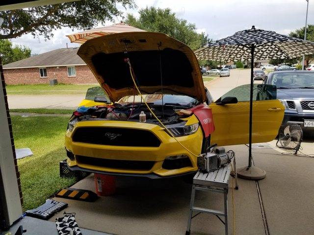

Been a week now since I've had it back. Pressure is holding and AC runs. Will clean out hoses and add UV Dye to check again in a week. Before the Texas August hits. So far so good.
