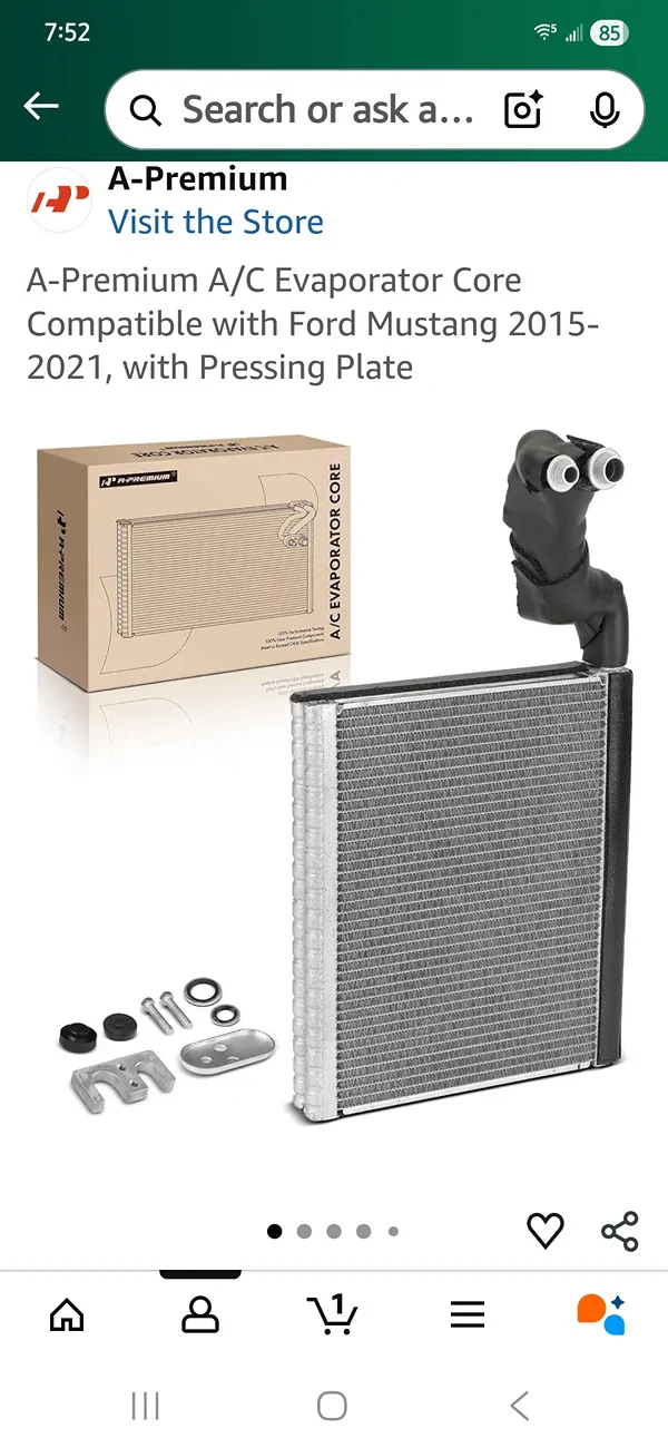

What evap core did you go with name part number ?,
Thanks in advance.

I decided to to go with with this one from Amazon it came with washers/o-rings hope Made the right choice cause I'm not doing this again. 🙄
You should consider replacing the TXV (thermostatic Control Valve) while you're at it. It might be possible to replace the TXV without removing the dash again but it's much easier now that it's a part. The TXV isn't expensive.
Good luck
