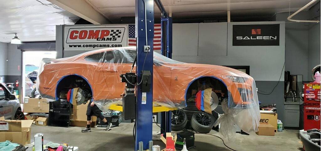

The very first modification I made to the car was to change the color of the brake calipers. It is a shame that Ford does not give you the option to do so. My friend who owns a shop hooked me up with a guy who air brushes calipers while they are on the car using the stock paint code. He mostly does Lamborghinis, Ferraris, McLarens, etc. It cost me $700 and took a whopping 5 hours! He puts the Brembo decals on after spraying and then lays a clear coat over it. Such a nice convenience to not have to wait at least a week for the calipers to return from powder coating and will probably be just as, if not more durable. And as you can see the results are amazing.

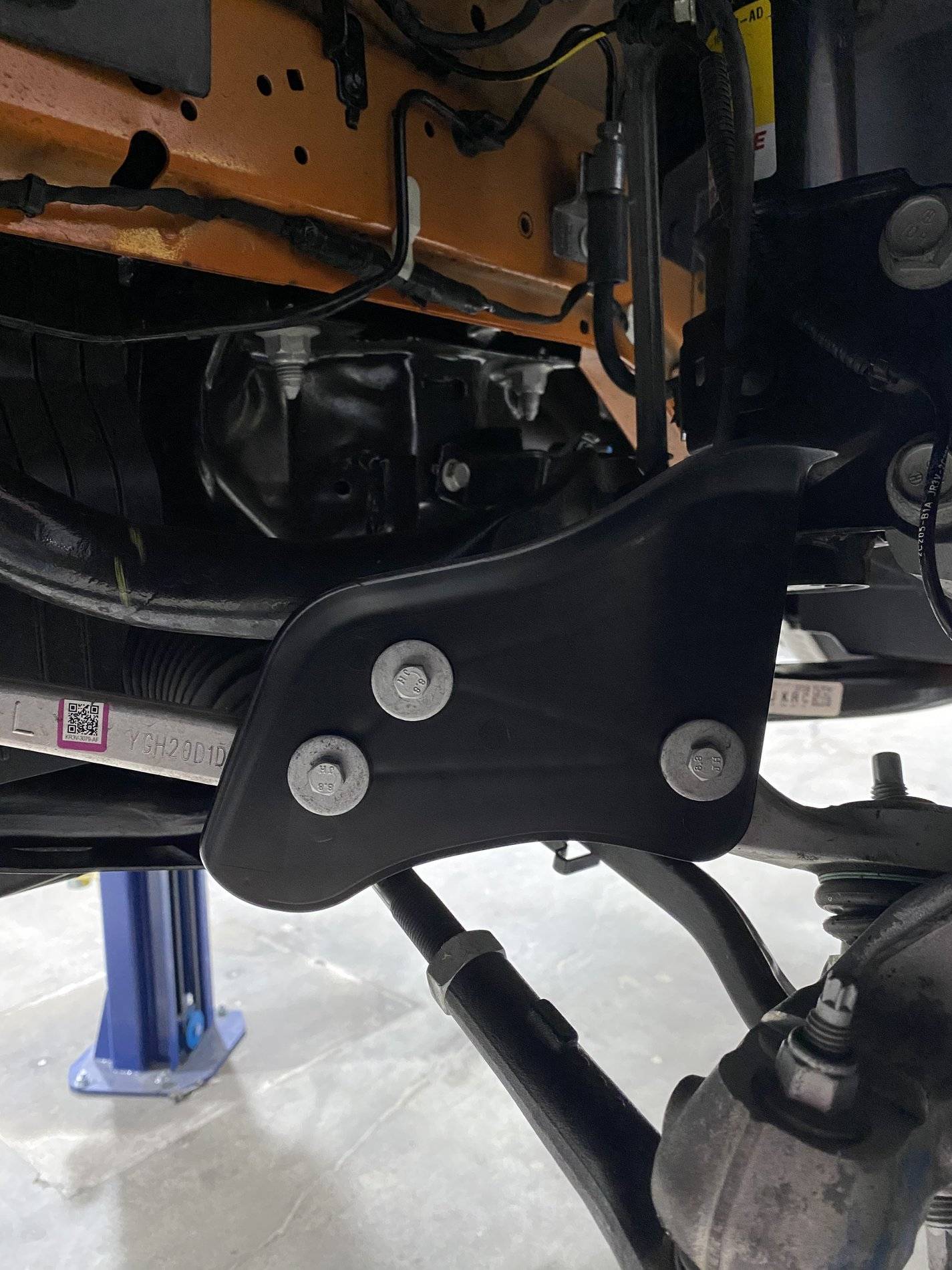

Small modification that I made was to add these brake deflectors from Steeda. The stock lower grille has a nice opening that allows air to go directly to the brakes. These mount to the lower control arm, where Ford conveniently had mounting points and redirect air to the center of the brakes. The holes just needed to be threaded and they bolted right up. Took about 15 minutes to install both on a lift.
