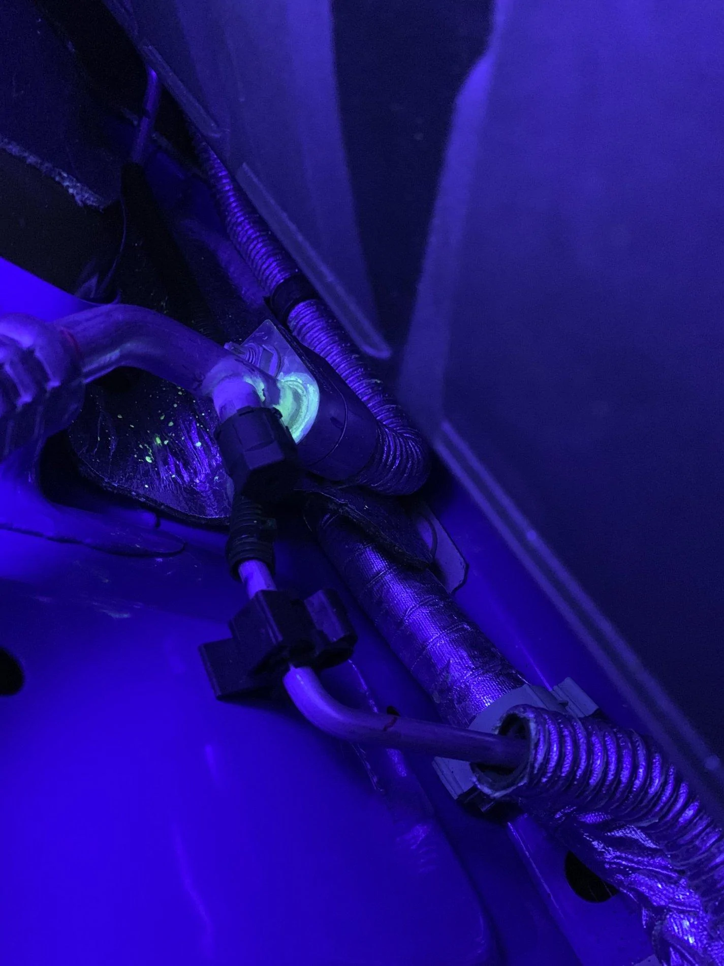

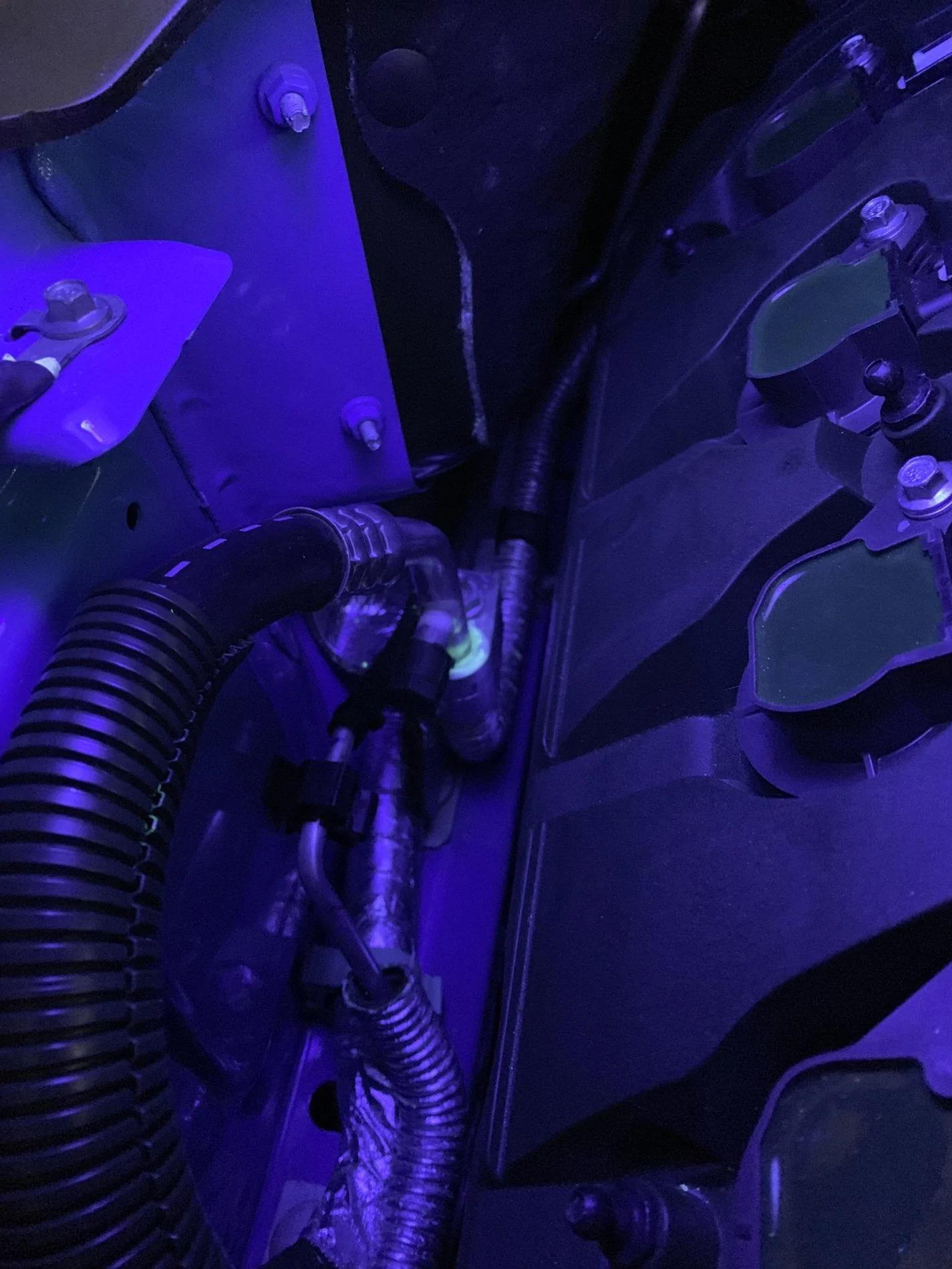

My ac didn’t work when I got my car out for the first time this spring. 17 gt 2911 miles then. The dealer said all the refrigerant leaked out but they couldn’t find from where. The charged it up and added dye. After a month or so the ac wasn’t cooling again. I took it in again and they said the evaporator was solid but a low side hose was leaking. It hasn’t been hot so I haven’t used the ac much, but I don’t have much faith in my ac being fixed for good. On a side note, when I was talking with the service manager he told me they have already changed some evaporators in the 18-19’s. Hopefully the 4th or 5th version of this evaporator will finally be a good one.
