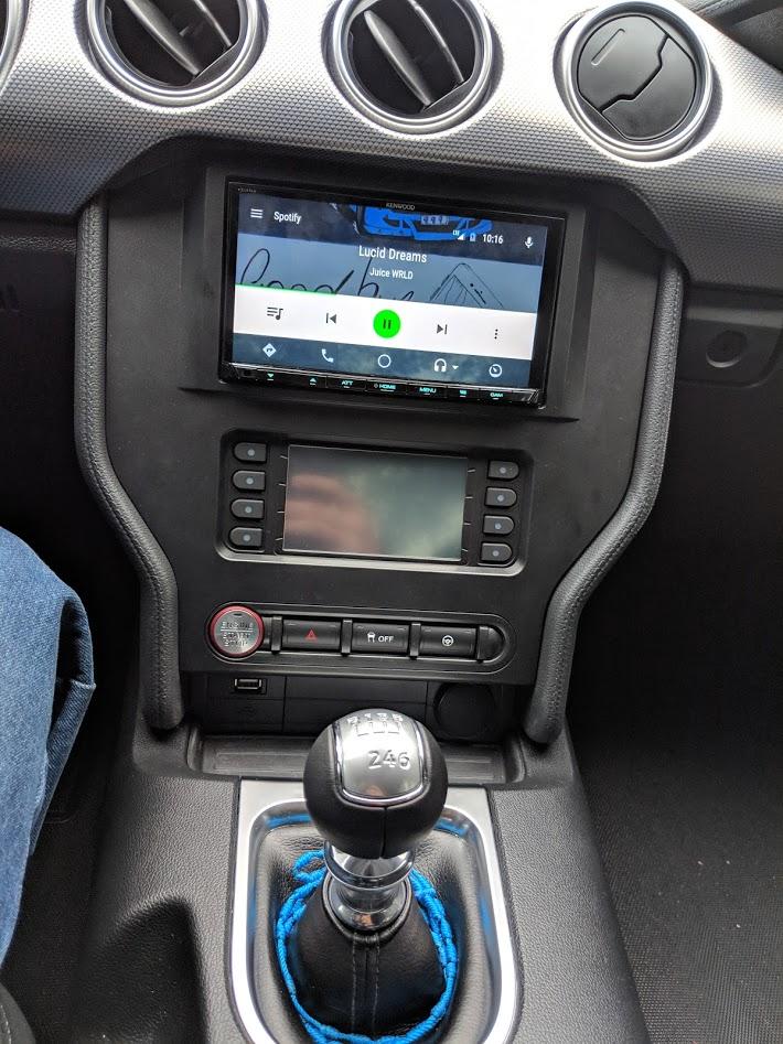

Hi all,
Trying to read all 81 pages for info on this issue and it is quite scary to see what it entails to replace an evaporator. I have a 2018 GT base black accent package (Houston, TX). Bought the car brand new from Joe Myers Ford and currently at 13,800 miles and 15 days away from 1 yr of ownership.
Symptoms I currently have.
When I leave for lunch at 1 pm the A/C doesn't blow cold. Sometimes it works, sometimes it doesn't. Same thing at 5 pm when leaving for the day. If the temps outside are extreme, I find it acts up. If the temperature inst bad, the AC blows super cold. Is this a sign of the evaporator going back or a Freon leak or compressor going bad? I am currently waiting on the dealer to get me a loaner so I can drop the car off to get it looked at / diagnosed but they don't seem to be good on follow up. Its been 6 days and counting.
I do have an aftermarket radio with a metra board for the AC controls (Pic attached) Not sure if that board has gone bad with the heat but everything seems to turn ON just fine which leads me to believe the problem is mechanical.
Have any of you experienced similar symptoms on a 2018 GT and up?

I had something similar happen to me. It was the evap core and was replaced. No issues for over a year now
Deleted member 35786
Guest
Take it in and get it diagnosed. Its on warranty so let Ford figure it out. Keep in mind of you installed different electronics/AC Control as you say that could be a factor in how it is behaving. Even worse if Fords says your aftermarket electronics are the issue then you could be out of luck on a warranty claim.
Good luck with the dealer and keep us posted.
