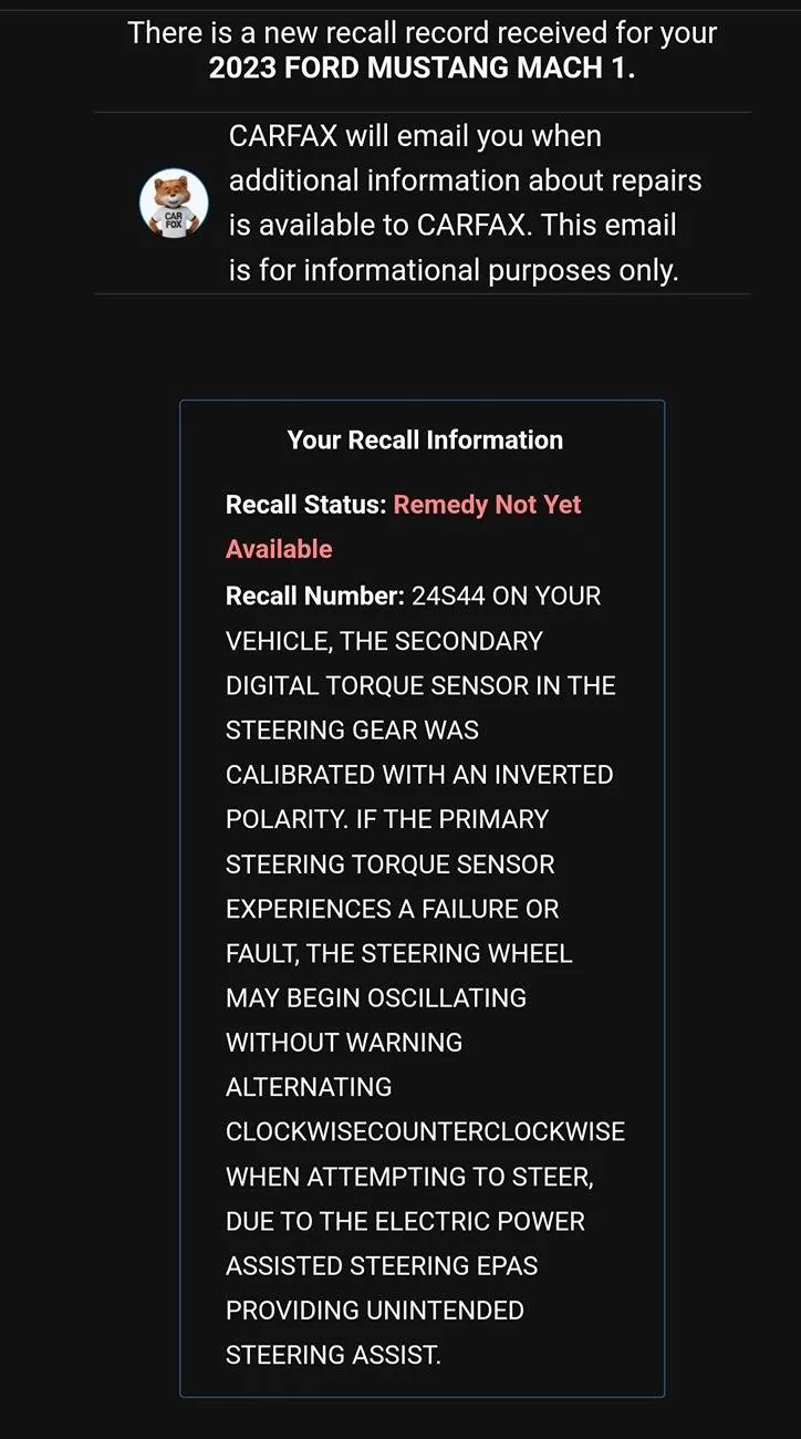

From fordaut web site
Affected vehicles: select 2022-2023 Ford Mustang models produced at the Flat Rock Assembly plant between September 15th, 2022 and April 5th, 2023.
https://fordauthority.com/2024/07/2022-2023-ford-mustang-recalled-over-steering-wheel-issue/

I’m shocked this made it past QA. Assuming they made a change in the 2022-2023 models, wouldn’t that change require a new QA regression (test all related components)? The phrase “when attempting to steer” makes me think you can’t steer if the primary sensor fails, and the “crash” may be more likely. I’d love more detail on how the issue was introduced, giving confidence that the impacted vehicles are indeed due for an update.
Agreed. Especially since they state no known failures to date.
