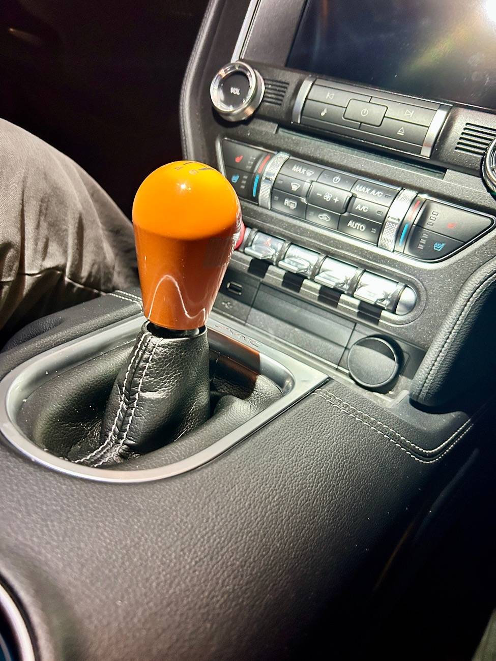

Yeah I agree, the MGW is really low. BUT, I put a Billetworkz "Tall Teardrop" shift knob on and it helped a tremendous amount. The height is perfect now. Cost quite a bit of money to fix it with the shift knob, the MGW, and the installation.... But it is soooo worth it, the noise was ruining my whole experience as well...

This totally fixed it? No resonance or rattle in any gear? I had an MGW in an MT-82 and it rattled awfully in 3rd gear. Do you have a link to that shift knob perhaps?

Thanks. That looks pretty good, especially in orange. So sounds like overall quieter than stock...how is it not totally silent? Just overall NVH like at high RPMs?
Yeah just a bit. I chalk it up to the more mechanical connection. Mine is still a bit notchy too but it's getting smoother every drive. The 1.5 pound shift knob helps some too. Overall it's 150% improvement. Direct and smooth, and the noise is minimal to me considering. I haven't owned a manual a few years but this is the best shifting manual I have ever had, even stock it was good other than that stupid resonance. I did do Amsoil fluid when I did the shifter too so it's hard to tell which is helping which.
