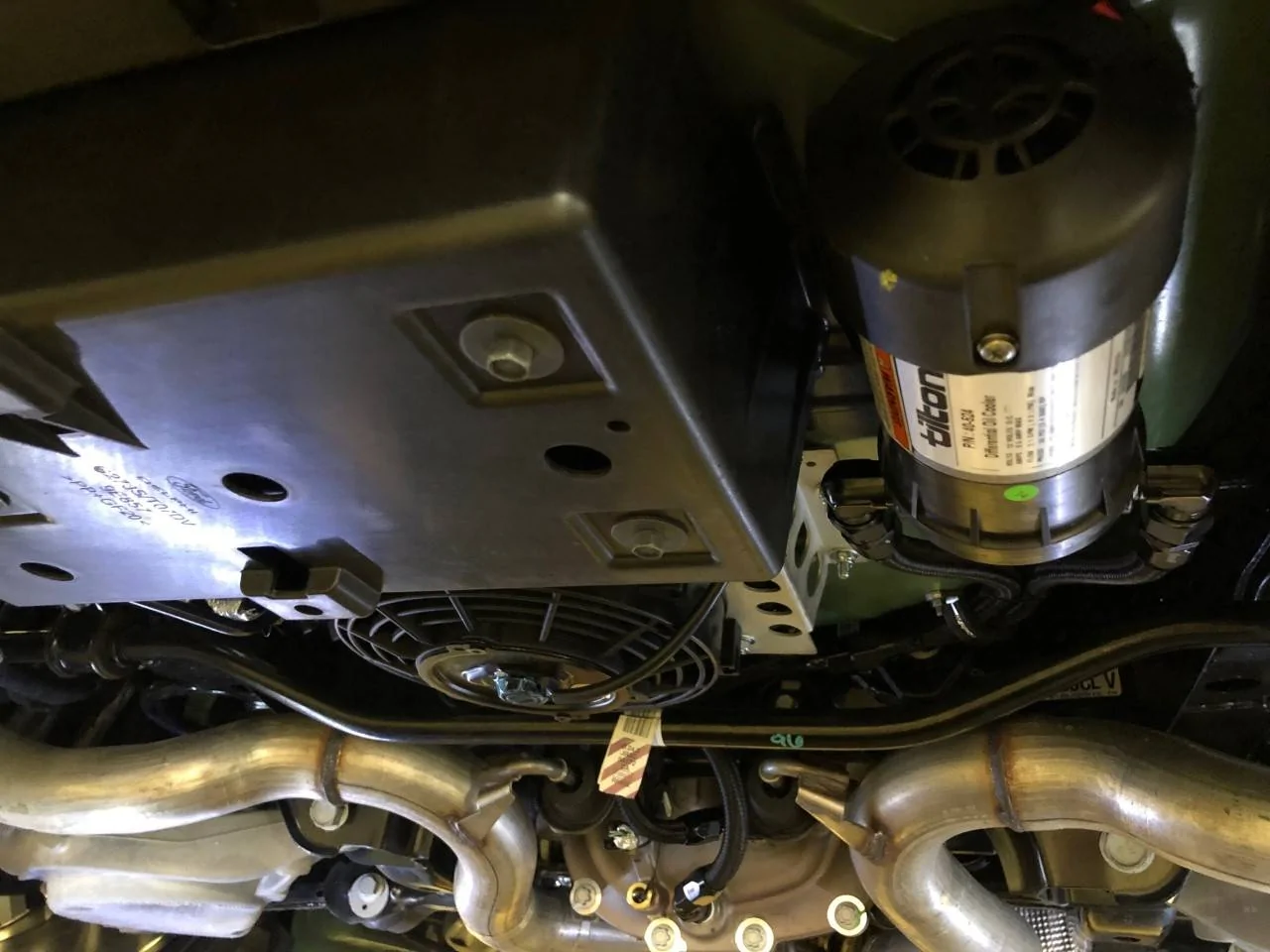

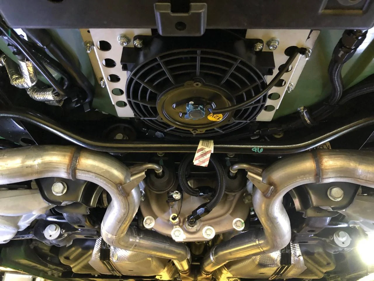

In These kits is the fan pushing or pulling air through the radiator? Someone mentioned using rubber stand-offs to add separation between the radiator and the bottom of the spare tire well.
This is my FTBR Diff Cooler mounted on my 2019 PP2. It has been flawless in all applications.
