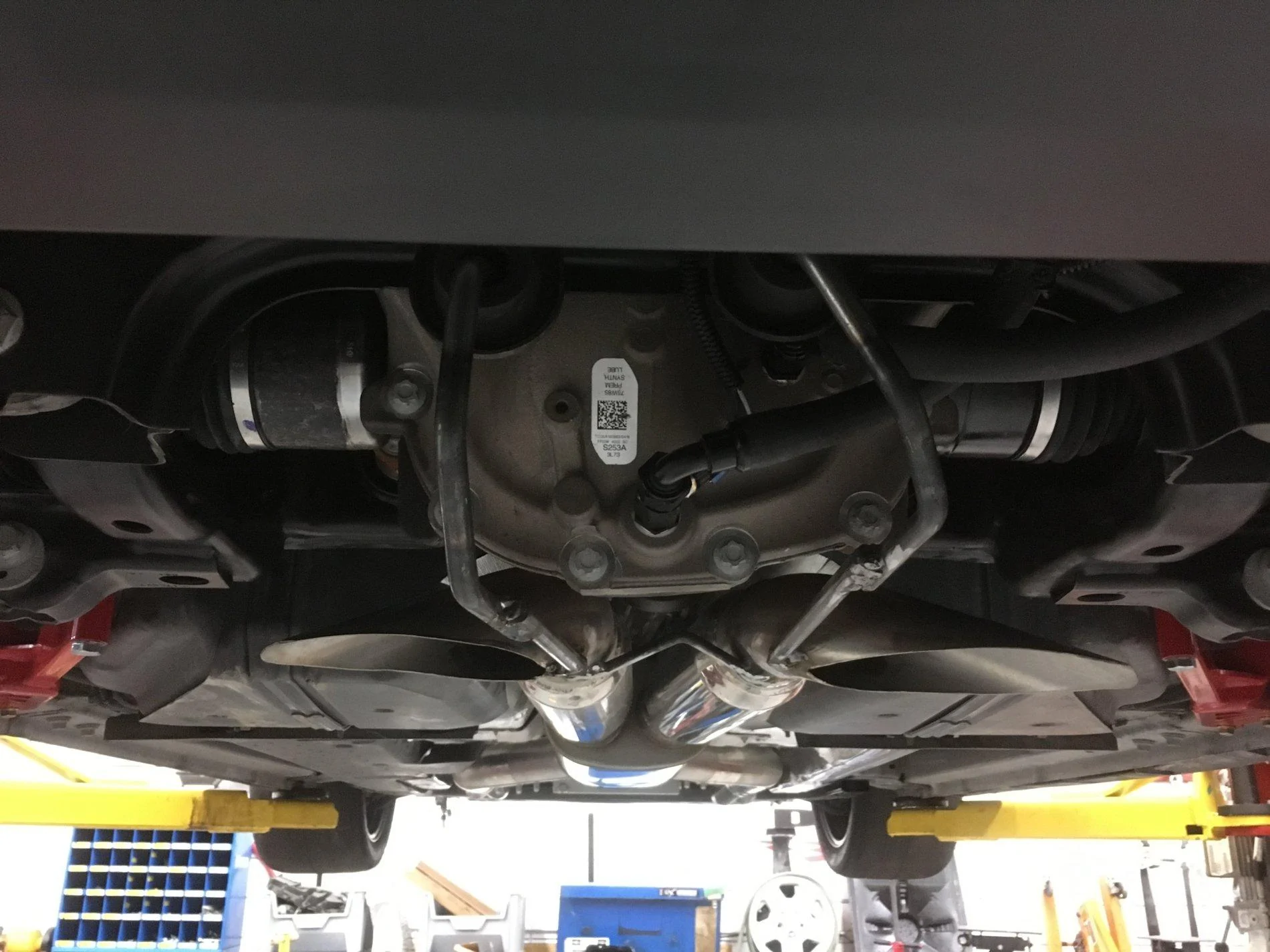

I wonder if there's an exhaust that does not go all the way to the rear bumper, but rather exits before rear wheels that it also reasonably quiet to be street driveable.
This would be a weight reduction by itself, plus maybe rear diff wouldn't need extra cooler weight. I mean, there wouldn't be heatung exhaust around the diff.
I have my exhaust dump just past the pumpkin, I also doubt it will have any effect, I dump mine early for weight, aero and noise limiting. Mine is a dedicated track car and does not see street use but a lot of tracks are getting harder to pass the noise limits. Dumping the exhaust under he car helps to cancel out some of the noise and reduces the sound level a bit.
The reality is if you drive on faster tracks you can buy yourself a little time by fluid type, heat shields, and fans in the pit, but the only real cure is to add a diff cooler.

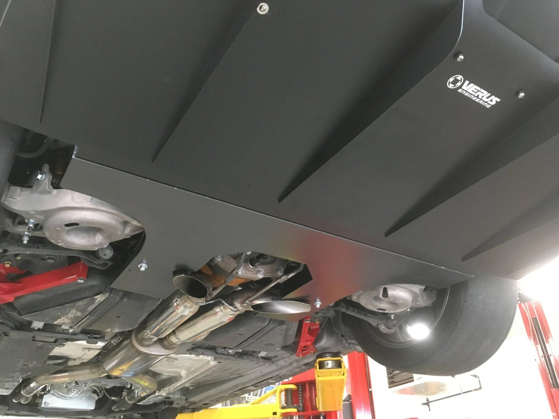

What is the brand of rear diffuser set up is this? I'd like something like this for mine, but I'm guessing you have to totally ditch the axle backs to make this work?
Side note, I have a full tilt boogie kit an I can run the car hard on the track and it keeps it around 175/180 all the time with how I have it set.
The Diffuser is from Verus Engineering, they do not always have them in stock so if they do have it and you want it I would order it. They designed it to work with the stock exhaust, but I added the extension to the diffuser that goes from where they stopped forward to right behind the end of the fuel tank. If you run full exhaust you will not be able to run the extension but I ran the diffuser on my last car without the extension and it is noticeable with and without the diffuser in place. This diffuser with a GT350R rear wing and a 3-4" front splitter has a well balanced feel aero wise and worked well for me. They have some CFD data on their site about the parts but it is all calculated data and not real world numbers so keep that in mind.
