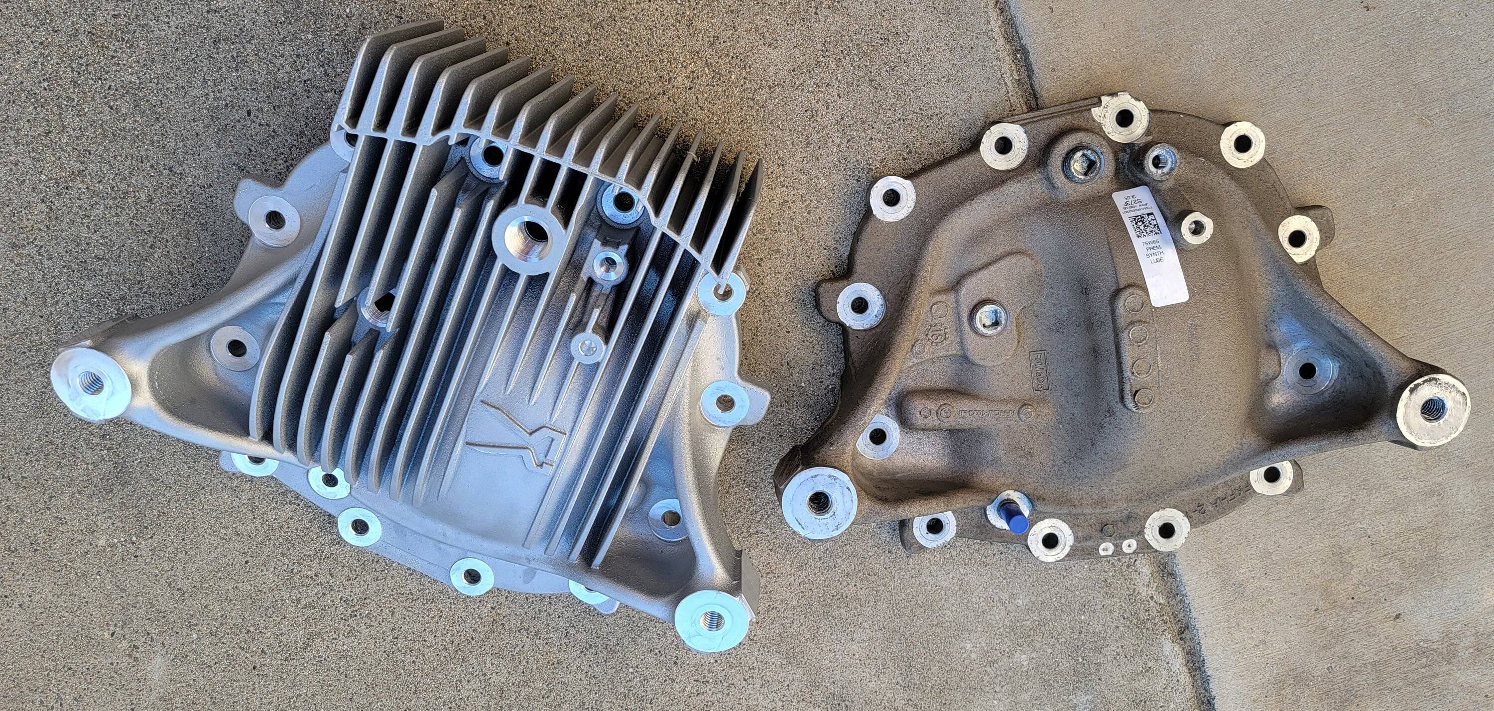

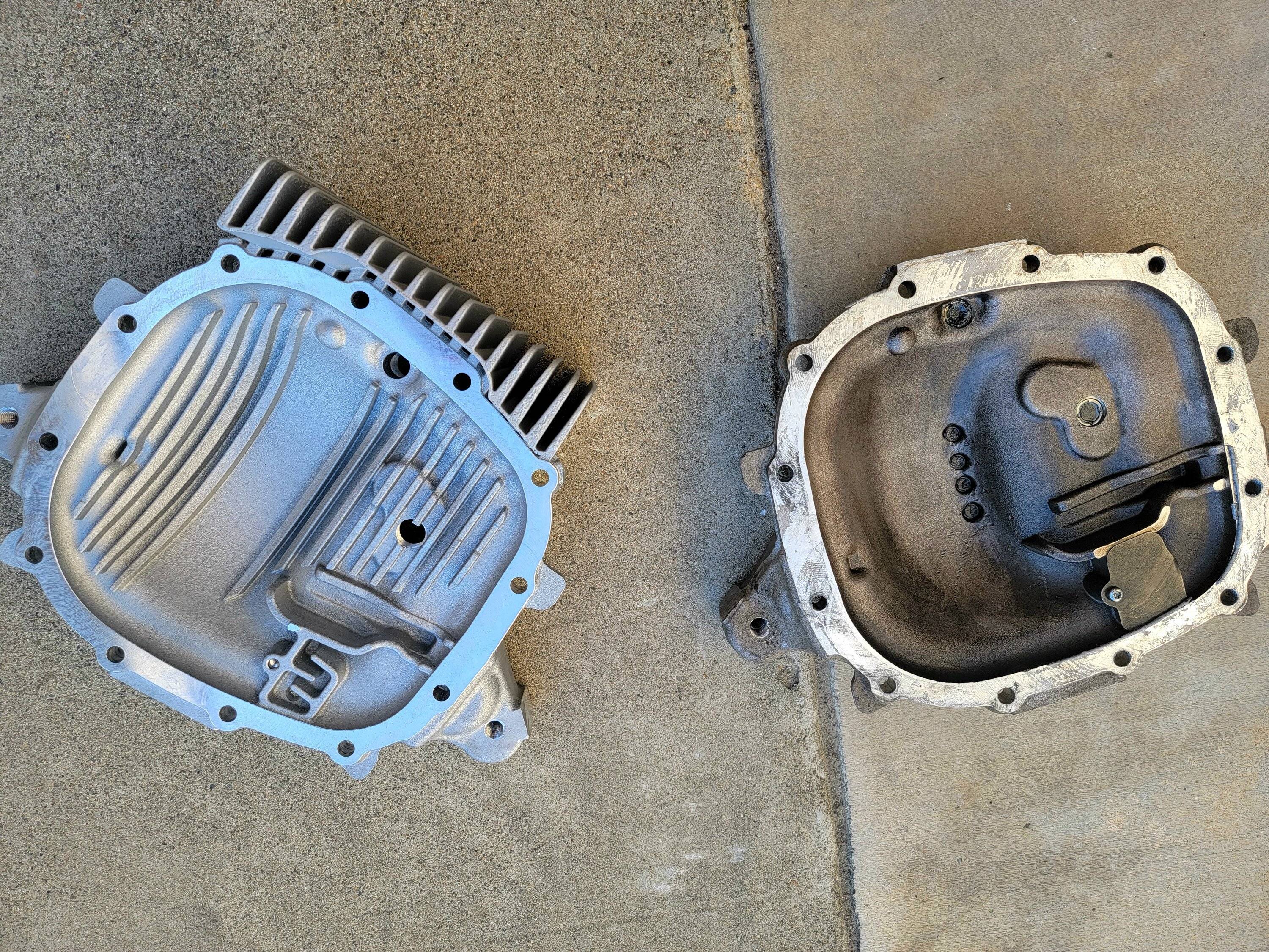

Here is the new, finned rear cover and the stocker. There was some concern about the interior shape, which is similar to the stock with the addition of some interior fins for the oil side of the heat transfer. The exterior has the air fins, of course. The cover is quite a bit heavier than the stock piece, so it adds 7.3 pounds. The housing/differential change was dropping about 23#, if memory serves, so it will be more like 15# net loss. In the end, I'm not sure if it's really all that lighter than a pump/cooler, but it's a simple passive solution to a common issue and any extra weight is in about the best place possible.
