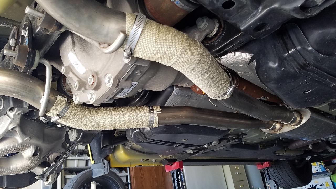

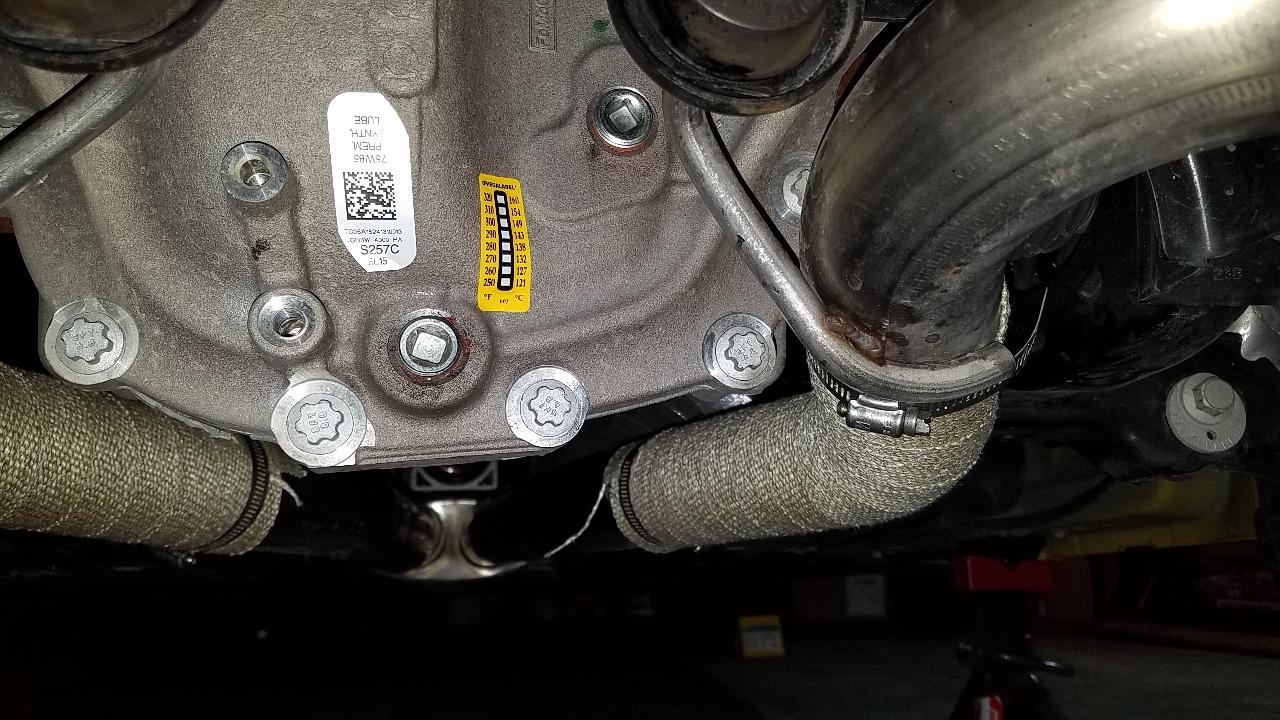

293F seems pretty hot for a diff.
I have a 2016 non-PP GT with auto trans (no diff warning system). I wrapped my exhaust around the diff, put in 140wt, and put on a temp sticker of range 250 - 320F.
Had an all-day track day, of pleasant 75F ambient temp. The temp sticker didn't even register the first dot. :shrug:
The aluminum carrier probably sheds heat a lot more readily than the iron one does. Combine that with the exhaust wrap, and maybe you've found a happy place...
