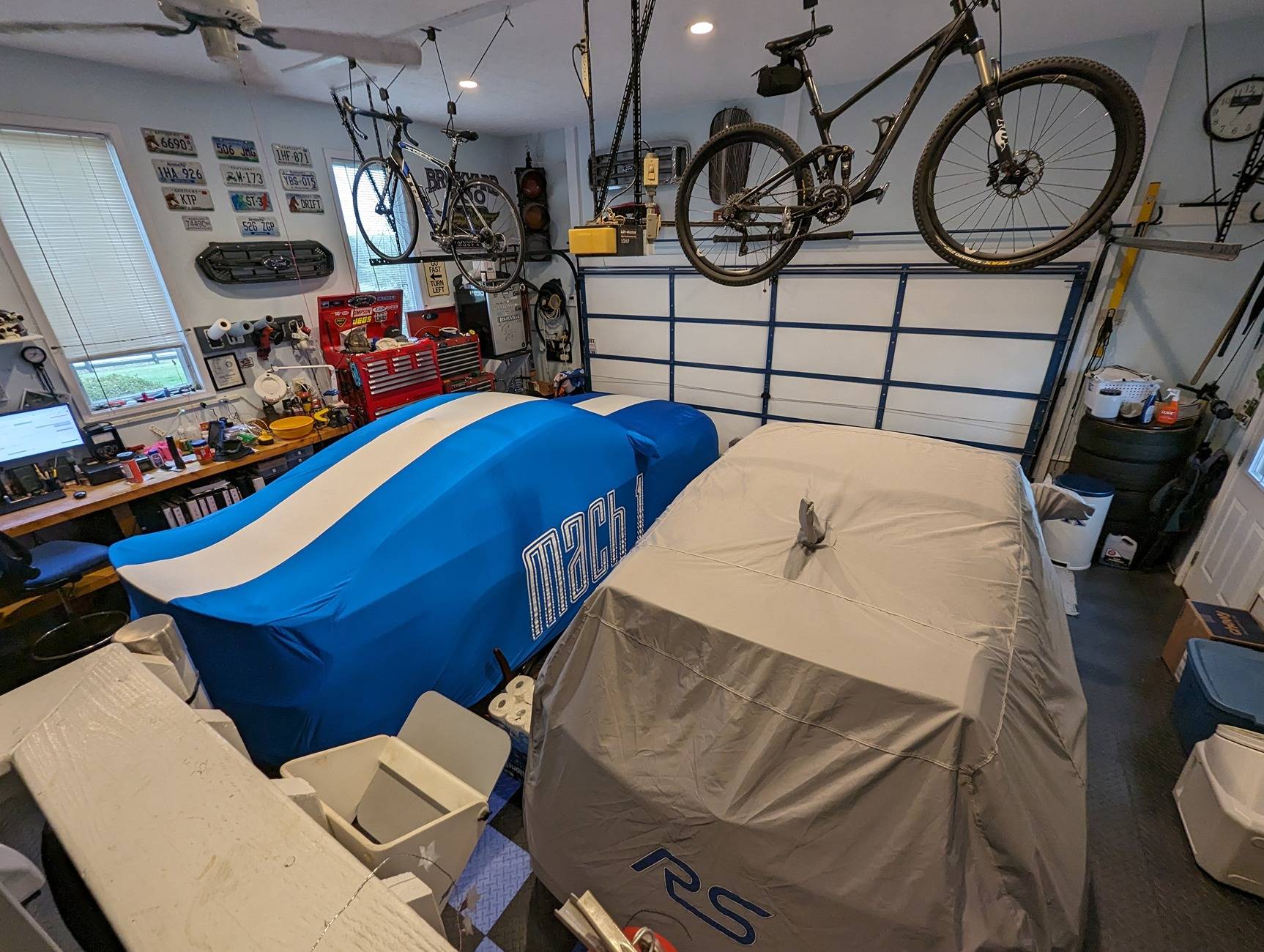

Clean, a full tank of gas, Ford Performance battery maintainer, cover to keep the dust off. Climate controlled garage. Some time during the winter, usually on a snowy or rainy day, I will do a detail, and a good coating of 303 Graphine. Makes for a good winter day, and it is ready to go as soon as the winters salt has been washed off of the roads. :)
