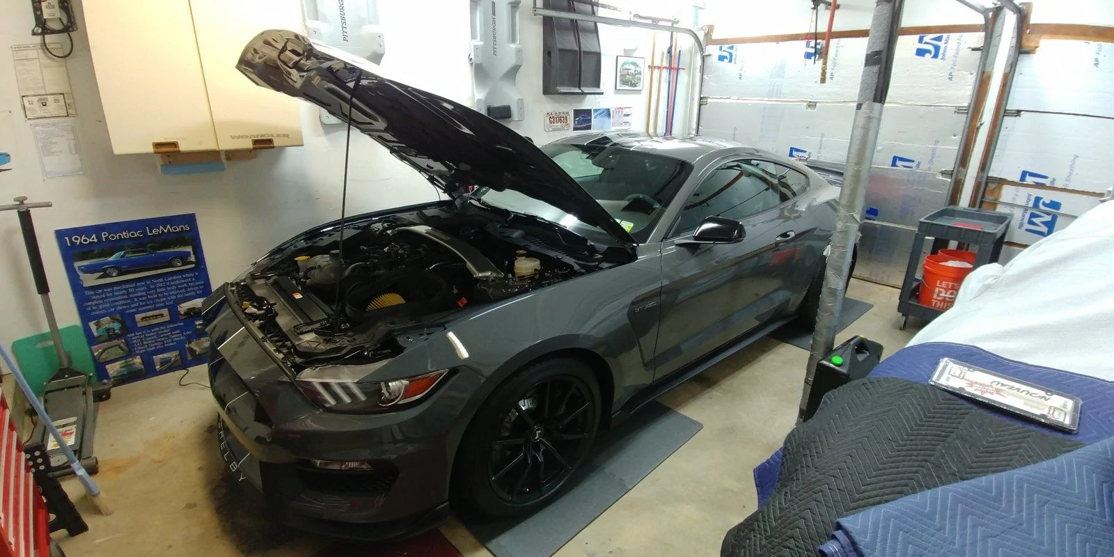

The HF item is cheap, but only available in store. These are the ones I have:
https://www.harborfreight.com/4-piece-anti-fatigue-foam-mat-set-94635.html
Amazon sells similar stuff for a bit more money:
https://www.amazon.com/AmazonBasics...1548351988&sr=8-3-acs&keywords=floor+work+mat
These squares are large enough that you can easily park on them. What I did was to park my car as usual, mark where the tires are with chalk, then back the car out, put the mats down on the chalk marks, then put the car back. Easy.
As for battery tender, look at this one: cheap and works great https://www.amazon.com/Battery-Tend...6&sr=1-16-spons&keywords=battery+tender&psc=1
I hard wire ends to the batteries of all my cars for easy connections
https://www.amazon.com/Battery-Tend...id=1548352216&sr=1-12&keywords=battery+tender
Search around, this has been discussed here a lot.
#muligan Nice setup!
Pic of the mats in the garage under the Shelby

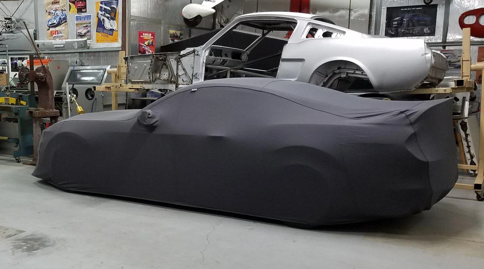

My process is similar to what others have mentioned... clean, dry, battery tender, full of fresh (non-ethanol) fuel, tires up to 50 lbs, and a cover. To that I add that it's stored in a heated shop that is kept at 60+ degrees and is in a CarJacket (with desiccant pouches) to extract moisture out of the air in the bag.

Thank you very much for the reply and the pictures of the gt 350 on the work mats with the hood up ! Thank you, that is a big help !
Do you have anything under the work mats to elevate the gt 350 ? And do you keep the hood up for the entire winter storage ?

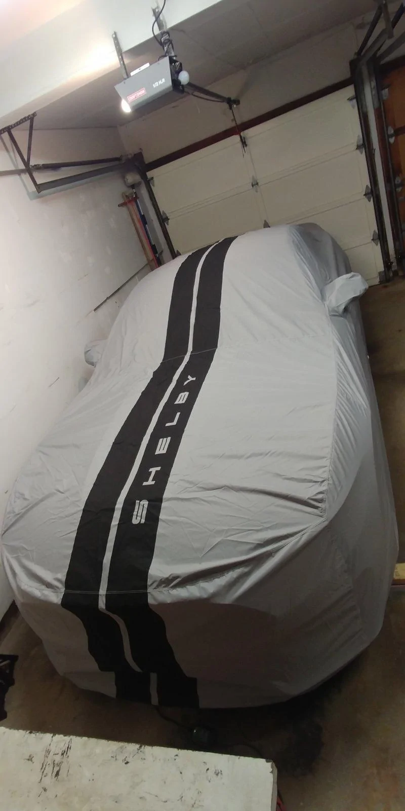

Nothing is under the mats.
I would not leave a hood open long term. Some do if they have bad rodent problems since rodents hate light, but aside from that, it's down and covered, ALWAYS.
(I actually use a softer, thicker cover than the OEM one, I use the Noah, but this looks better in pics)

I use a super soft cover that helps protect the finish from the harsh material of the CarJacket - it's a "Form-Fit" from Covercraft and is actually a bit like spandex for the car. Mrs. Muligan calls it the snuggy.

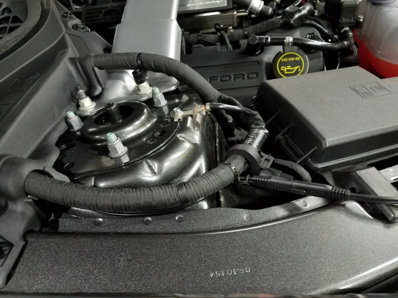

My battery tender harness is connected directly into the batter - though I know that some prefer to do it through the fuse box. Here is where the plug connects to the cord that goes along the inside of the fender and out from under the point at the leading edge of the fender over the passenger headlight. This allows me to completely close the hood. You can see the wire and the connector in the lower right of this picture where it comes out from behind the wrapped wiring harness - note the zip tie holding the battery tender harness....

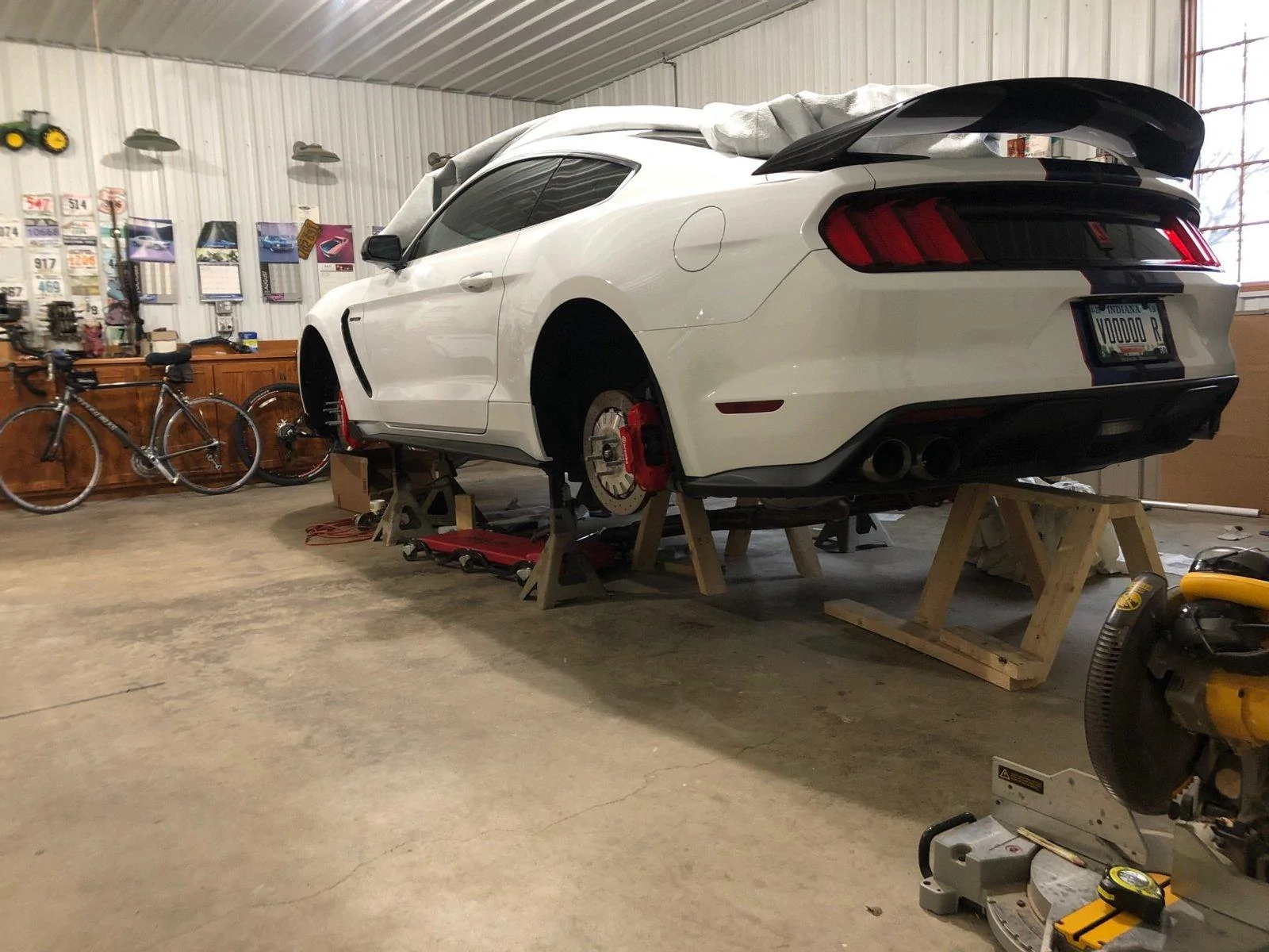

Along with the others, here is ours up on stands to install driveshaft & shifter. Complete now & this is how we will be winterizing the 350 every year. Takes the load off of tires & suspension plus an annual oil change. Might even slow down those darn spiders!LOL
