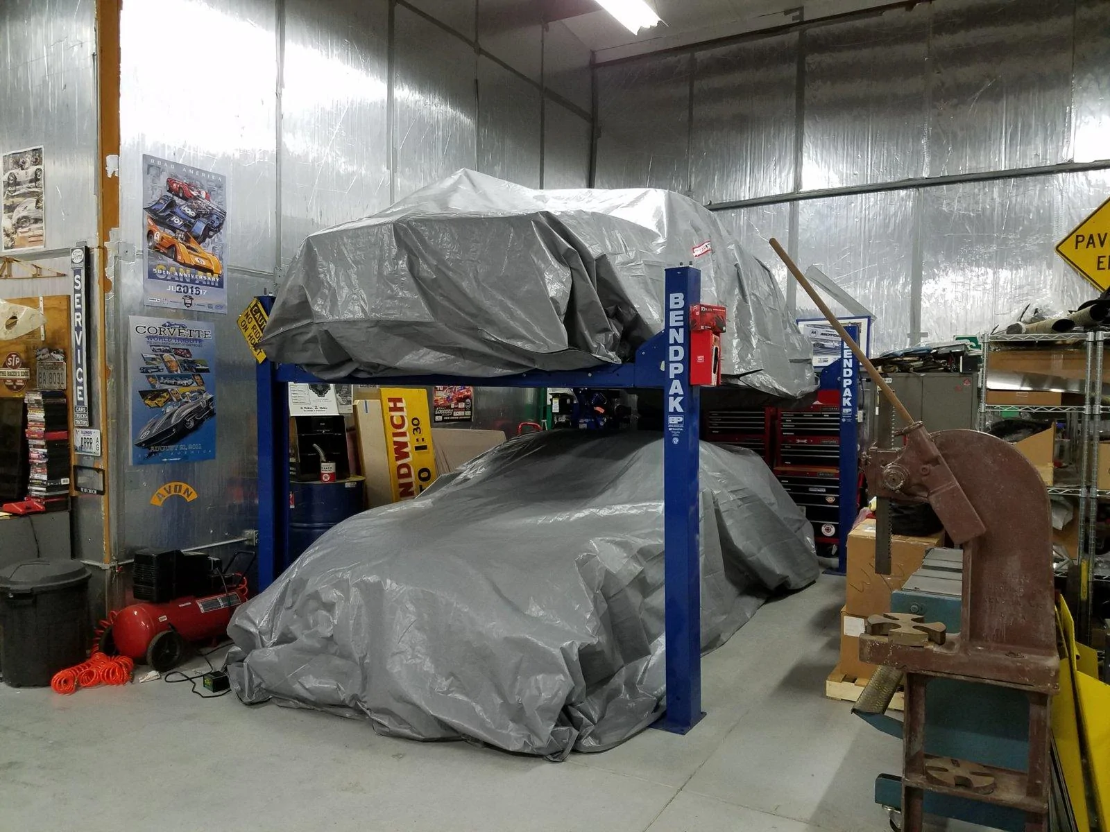

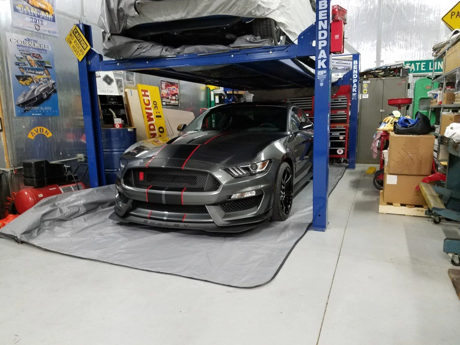

My process is similar to what others have mentioned... clean, dry, battery tender, full of fresh (non-ethanol) fuel, tires up to 50 lbs, and a cover. To that I add that it's stored in a heated shop that is kept at 60+ degrees and is in a CarJacket (with desiccant pouches) to extract moisture out of the air in the bag.
