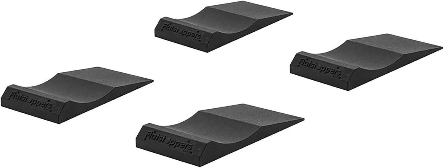

I bought these last year and worked great. Race Ramps 4-Pack FlatStoppers Car Wheel Ramp, Non-Skid Storage Pads & High-Density Foam
Thanks for showing these. I just ordered a set.
I ended up buying these, any issue leaving the parking brake off while on them?
