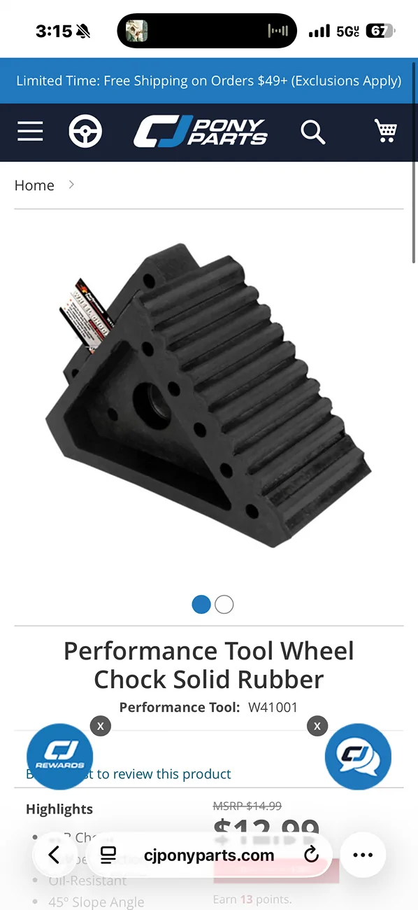

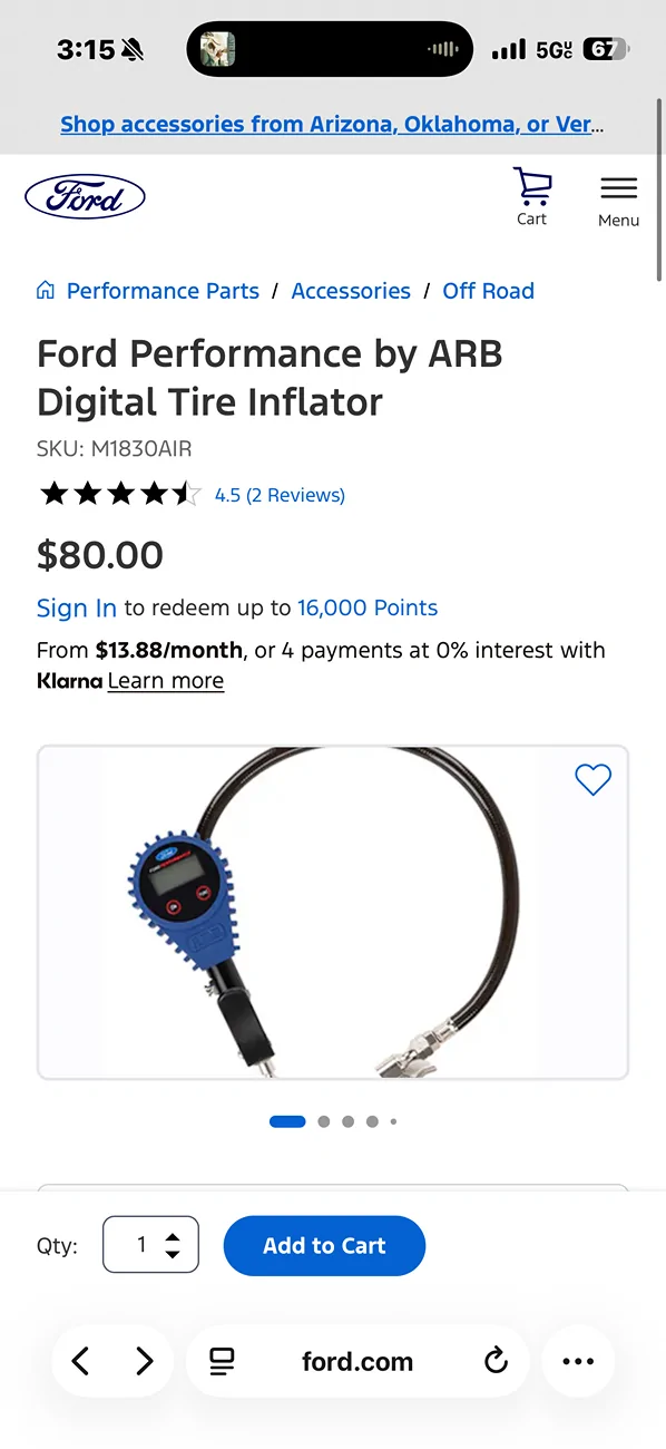

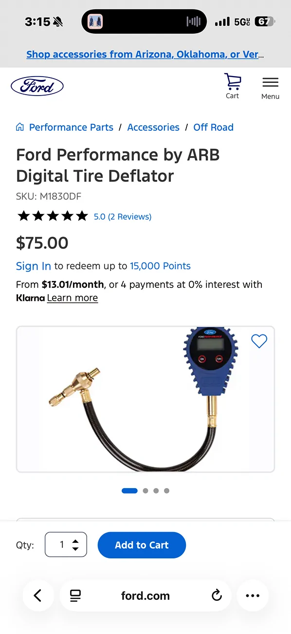

Here’s what I’m planning on buying so far.

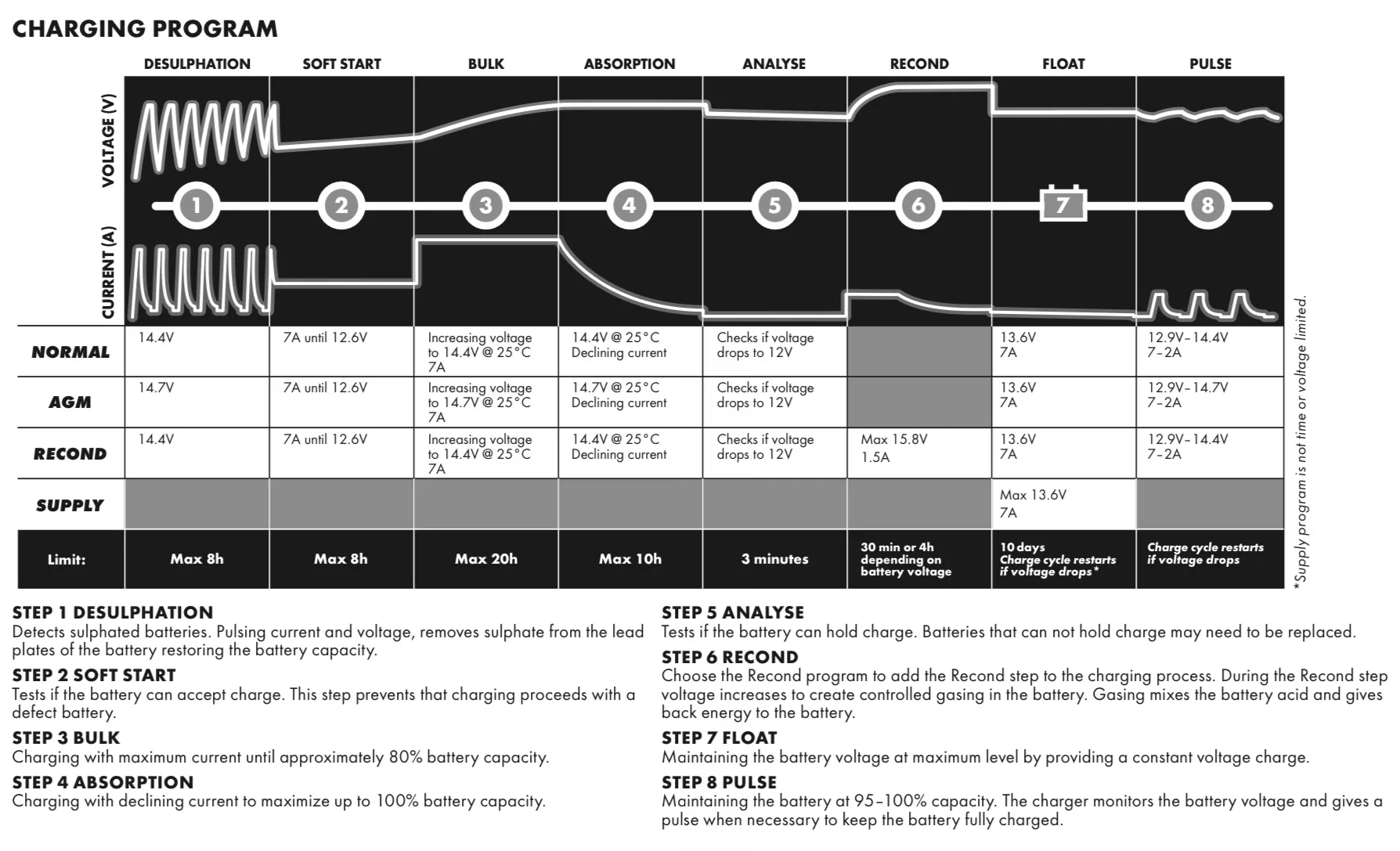

I've been using that smart charger since taking receipt of my car; it works great.
I believe it's a CTEK item, branded Ford Performance.

What wheel chocks do you use? Since we both have the same HP tire size.

No heater. And instead of rubber mats, or chocks, get those Flatstopper ramps shown in a previous post. They help prevent flat spots on the softer, Summer tires. Plus with them, you can leave the car in neutral and the parking brake off.
My car is stored outside all Winter, and I never had a problem following the procedure outlined here along with the Flatstopper ramps.

Race Ramps makes a quality product for the Flatstoppers. No chocks needed either.
https://www.raceramps.com/car-storage/ramps/flatstoppers/p/rr-fs/
Also, FWIW, my garage is attached and not heated (but well insulated). The coldest it’s ever gotten in my garage during those super cold snaps is 40F. No need to add a heater to the garage for storage.

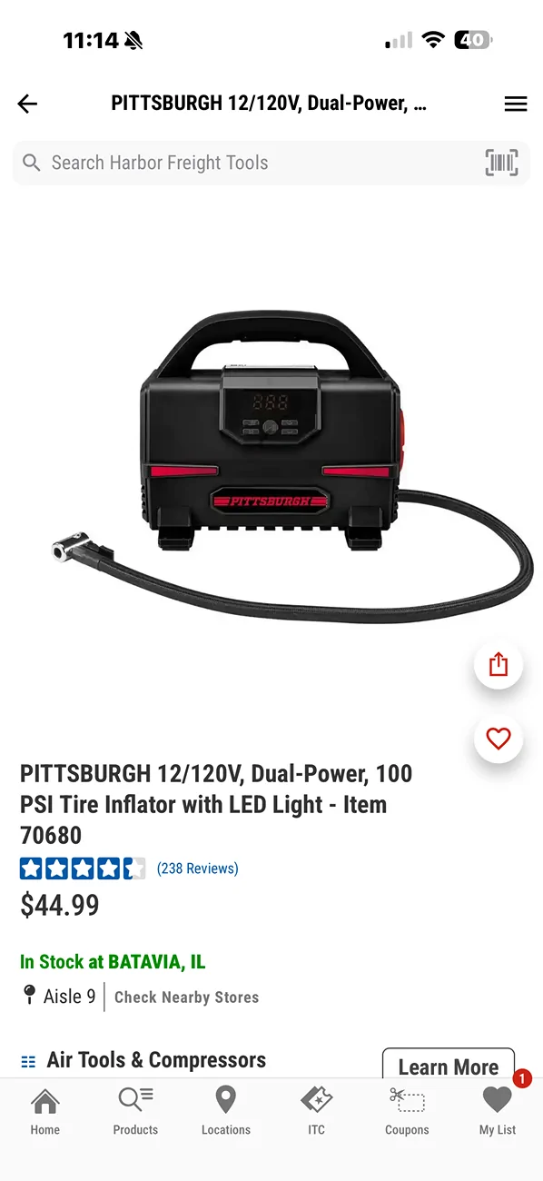

Edit on my previous post, this is what I’ll be getting instead for my tire filling and deflating.
