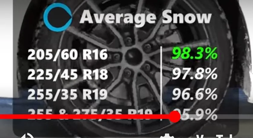

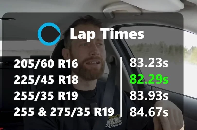

https://www.motor1.com/news/696279/wide-vs-narrow-winter-tires-explained/
These guys have better testing IMO and found the opposite to be true, i'm more inclined to side with this because it aligns with the math
the actual test says otherwise
"The narrowest tire performed the best in acceleration testing, but did the worst when it came to braking. And for lap times, the middle 225 section-width tire performed the best."
so the second narrowest tire did the fastest lap times, and the widest didn't do the best at anything
aaaalso the narrowest tire isn't even the same tread oattern
