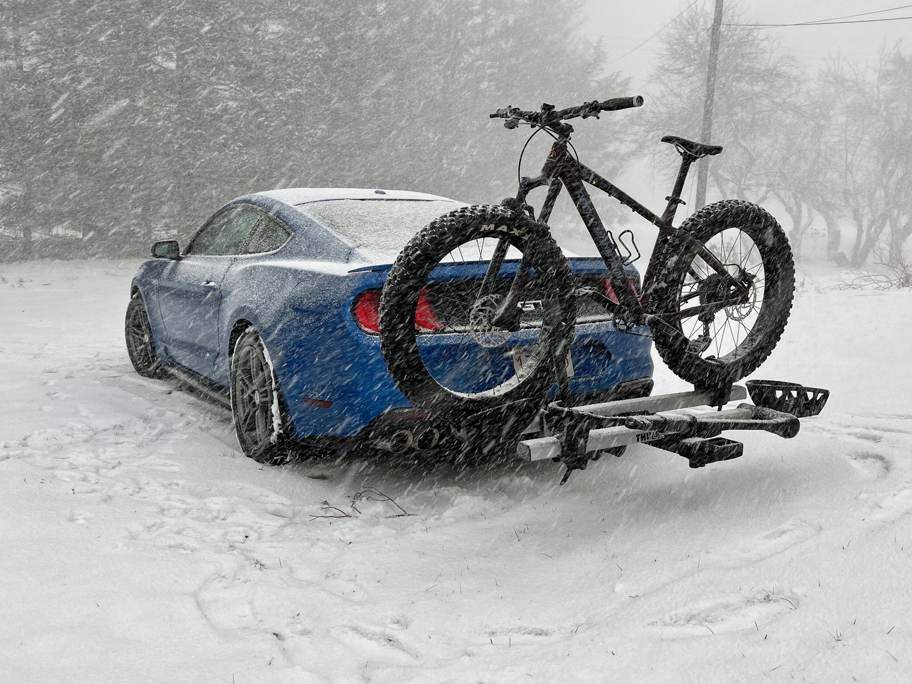

Narrow vs wide snow tire debate - take your hand and try to cut thru water, first time hit like a slap and next like a knife. Which works best?
Weekend ride, I have company vehicle as a daily.
yet your bike doesn't have narrow tires!
(I know it's completely different)
