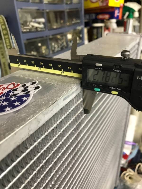

Fluidyne states their radiator is 2.5" thick (29" L x 20.5" H x 2.5" D). The external dimensions of the DeWitts radiator are not published, unfortunately. Once I get the radiator I'll take measurements. Because the cores themselves are 1.25" thick I estimate the radiator, itself, to be over 3" thick.
Oh so core thickness x number of cores =/= overall thickness dimensions?

Correct. As I understand it, the additional thickness comes from the spacing between the cores and the fins and plates.

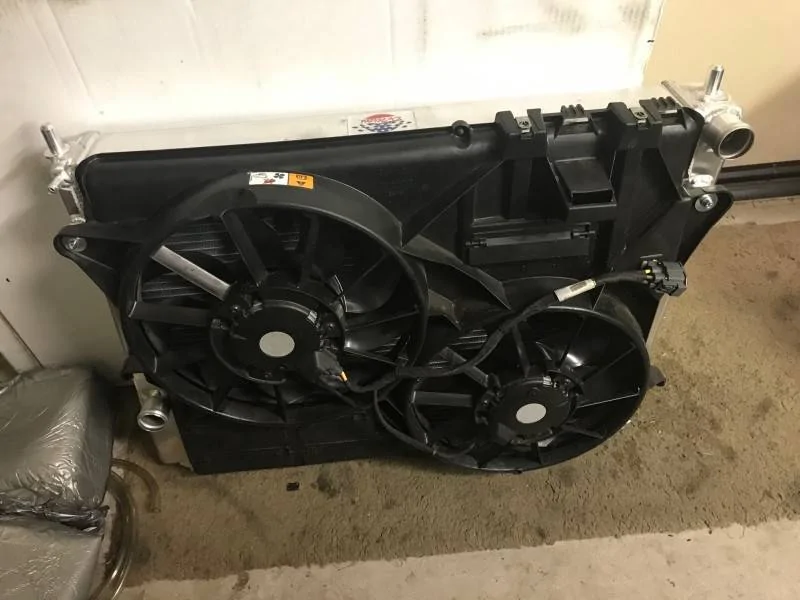

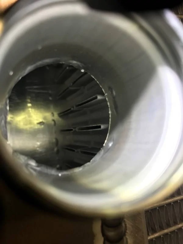

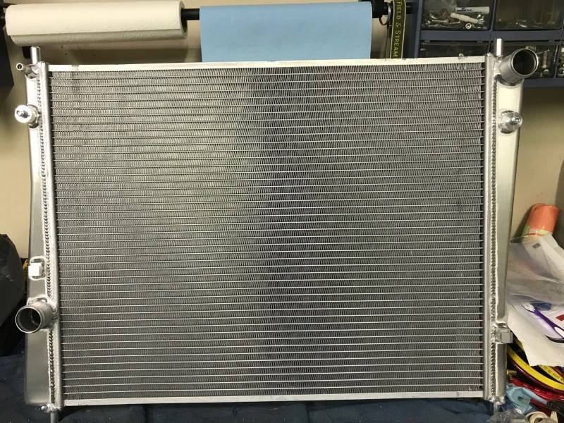

The radiator got here this week and it looks to be very well built.
Large 1.25" tubes:

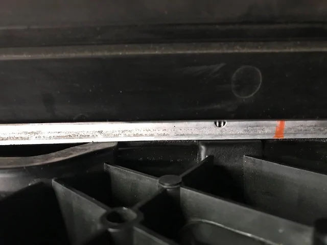

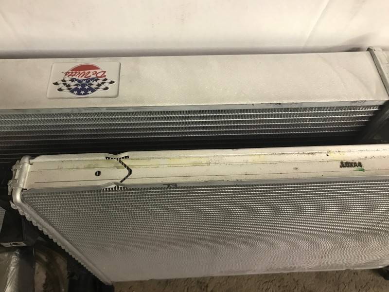

The radiator was thinner than expected because the upper plate was sized to the fins, not the tanks:
Here is the PP radiator compared to the DeWitts:

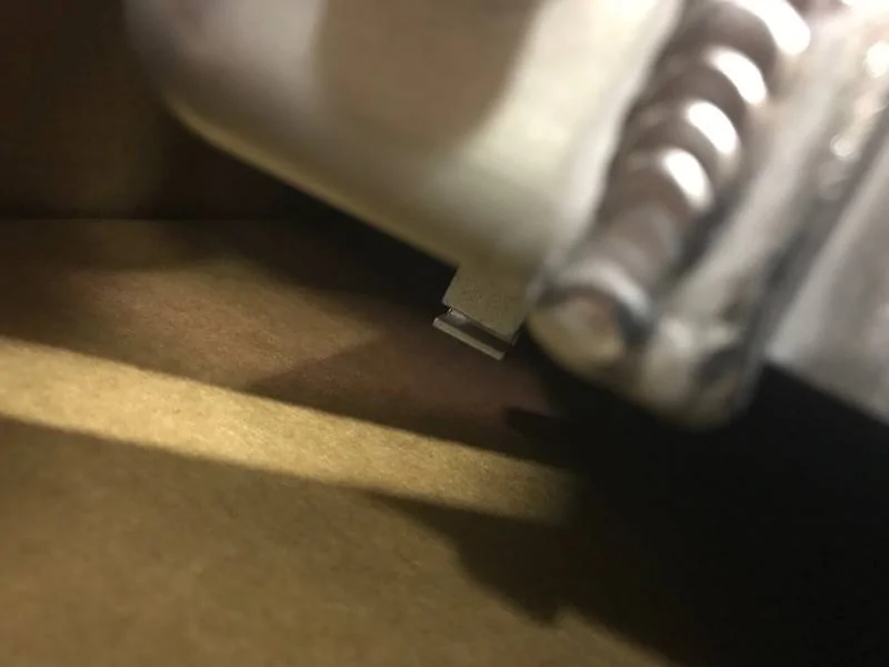

The ac condenser clips are aluminum blocks welded to the tanks with slits cut into them so the condenser needs to be lined up perfectly when the radiator in getting installed. It's a pain in arse to get the clips into the slots. Having a second person would be have made the job much easier.
The fan shroud goes on pretty easily and I would strongly recommend adding fender washers to between the head of the bolt and the fan shroud. I would also recommend adding some thread locker so the bolts don't vibrate loose:

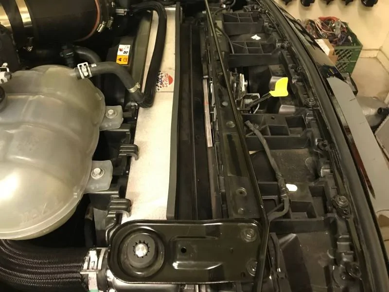

From here installation is pretty straightforward. I pulled the foam strip from the top of the stock radiator and re-installed it on the new radiator. Don't know if it's necessary, but it was easy enough.
The thickness of the radiator has the AC condenser tight up against the plastic core support. It's at the very top edge behind the hood latch. The next time I have the bumper off I'll trim that section of plastic so the condenser has more room. It's no more than .125" that is touching.
Unless you want to drill new holes for the radiator mounts you'll need to pull back on the radiator in order to get the bolts started because of the contract between the AC condense and the plastic core. It's a tight fit but it does fit.

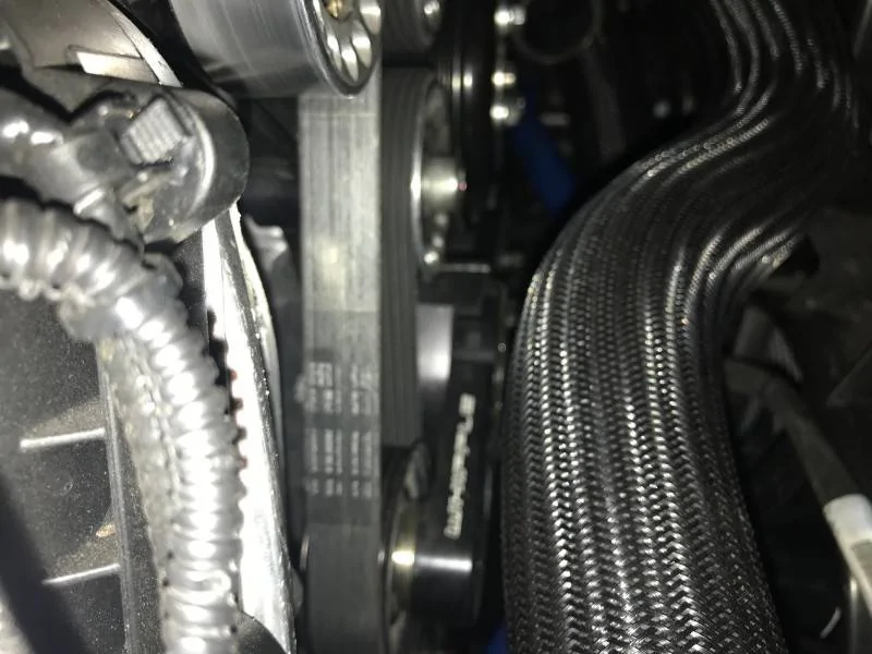

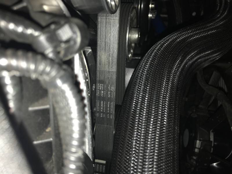

For the people with Whipple superchargers, the clearance between the serpentine belt and the upper radiator hose is now very close due to the added thickness of the radiator:

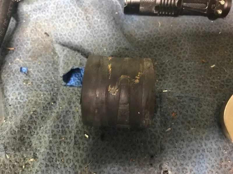

It was too close for my liking so I cut 1.5" off of the upper radiator hose and reinstalled the hose.
The spacing between the belt and the upper hose is now much better. There's plenty of slack in the upper hose so there are no kinks or anything to worry about after removing 1.5" from the radiator end of the hose.
