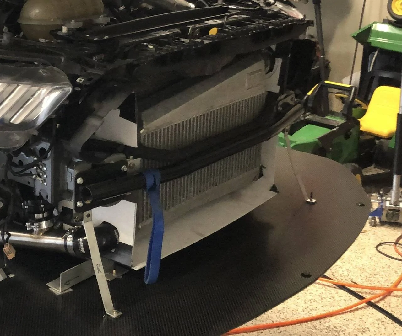

Sealing in all 4 sides of the radiator is most critical to getting cooling under control. I used plastic corrugated sign board from Lowes, its stuck to sides of radiator with double sided tape and sealed everywhere with duct tape. Keeps my TT cool for a 20min session in the Texas heat.

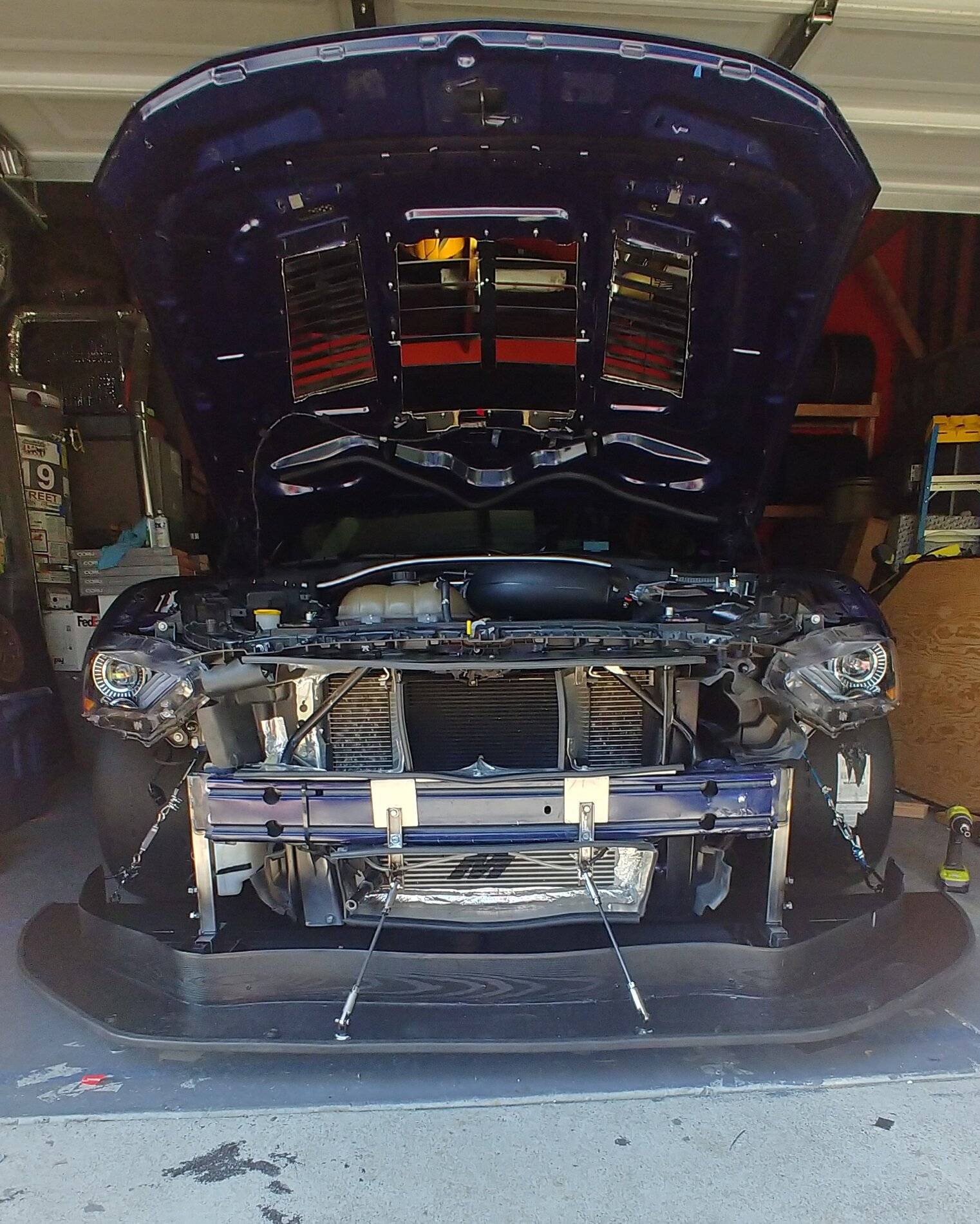

Ducting dramatically increase cooling. Highly suggest venting the hood.

Thanks for posting additional pictures. I'll definitely do this soon. Hopefully the trackspec vents allow for enough air to escape so the there's no buffeting under the hood.

Yeah, the corrugated sign board is easy to work with, cuts with a box knife and is flexible enough to maneuver into the tight spots, but stiff enough to keep its basic shape. I don’t have more pics, but it will take a day to do the job as there is a lot of trial and error before you finally get everything how you like it. Also cutting holes for the AC lines and other lines adds time.
I also have the track spec hood vents, the hood still flutters but it might be a little better.
