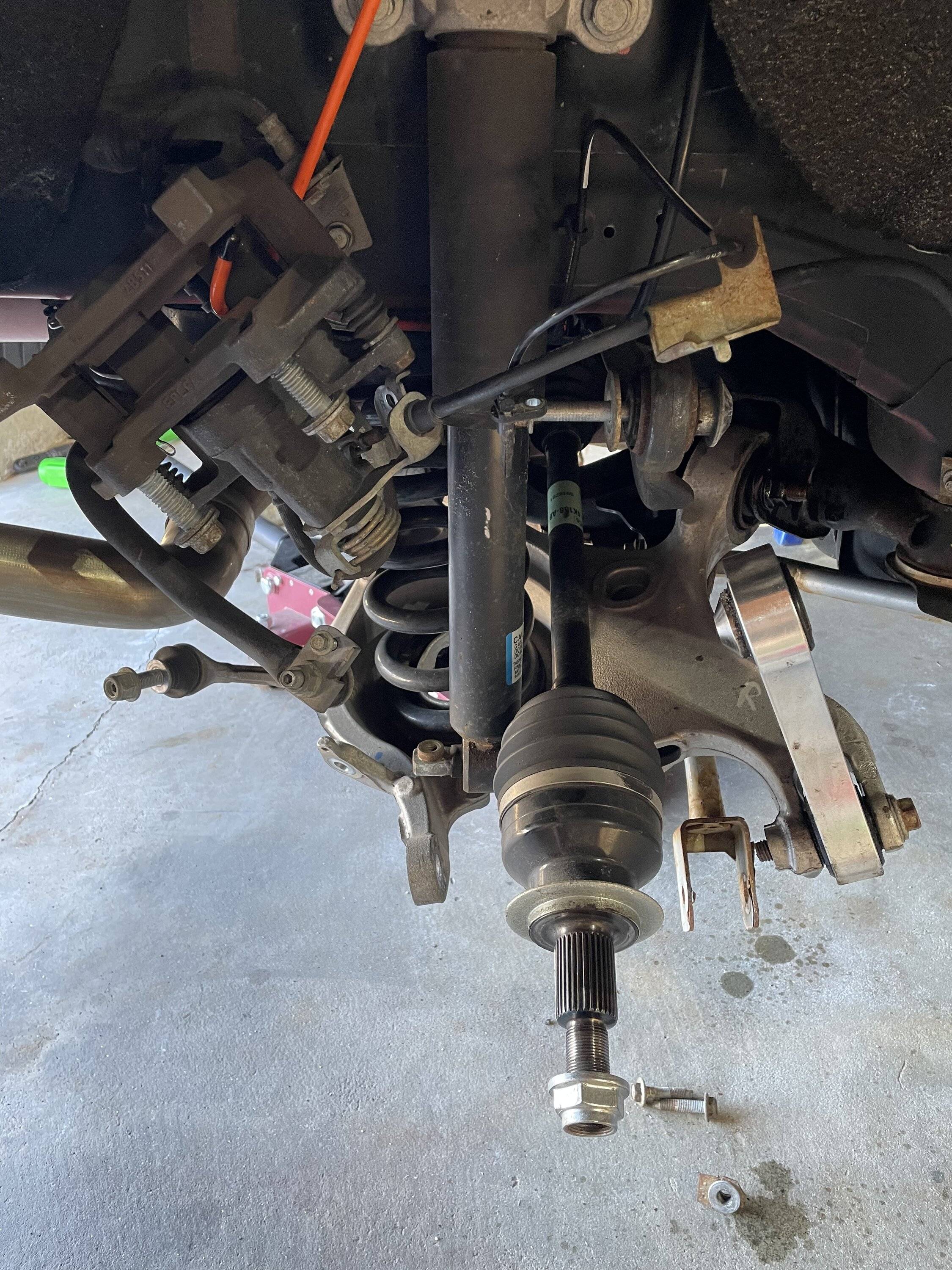

It is one of 3 that Kelly recommends doing first.Watched the video twice, he says the toe link is the most important upgrade? Should be done first? Never would have thought that.

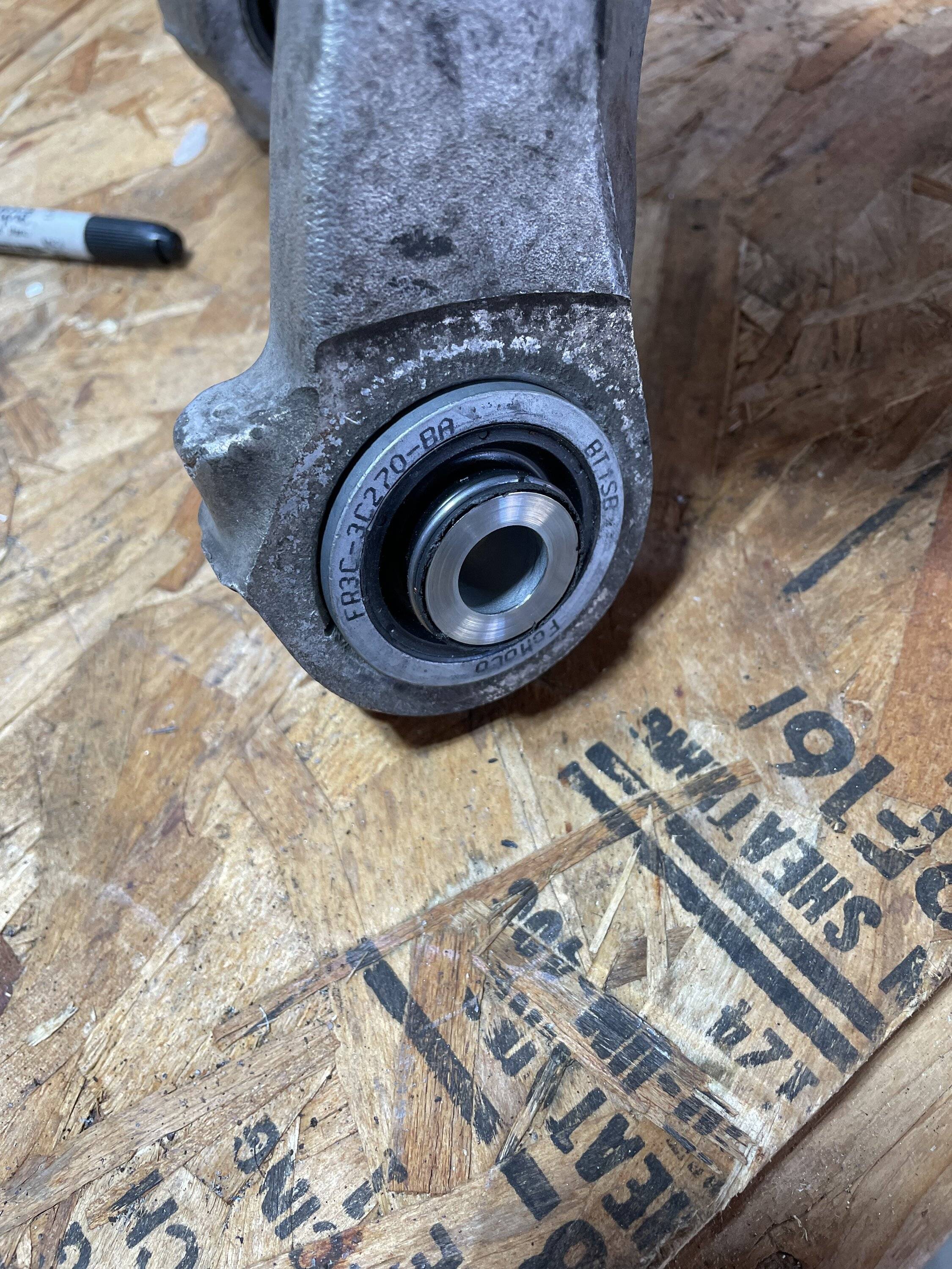

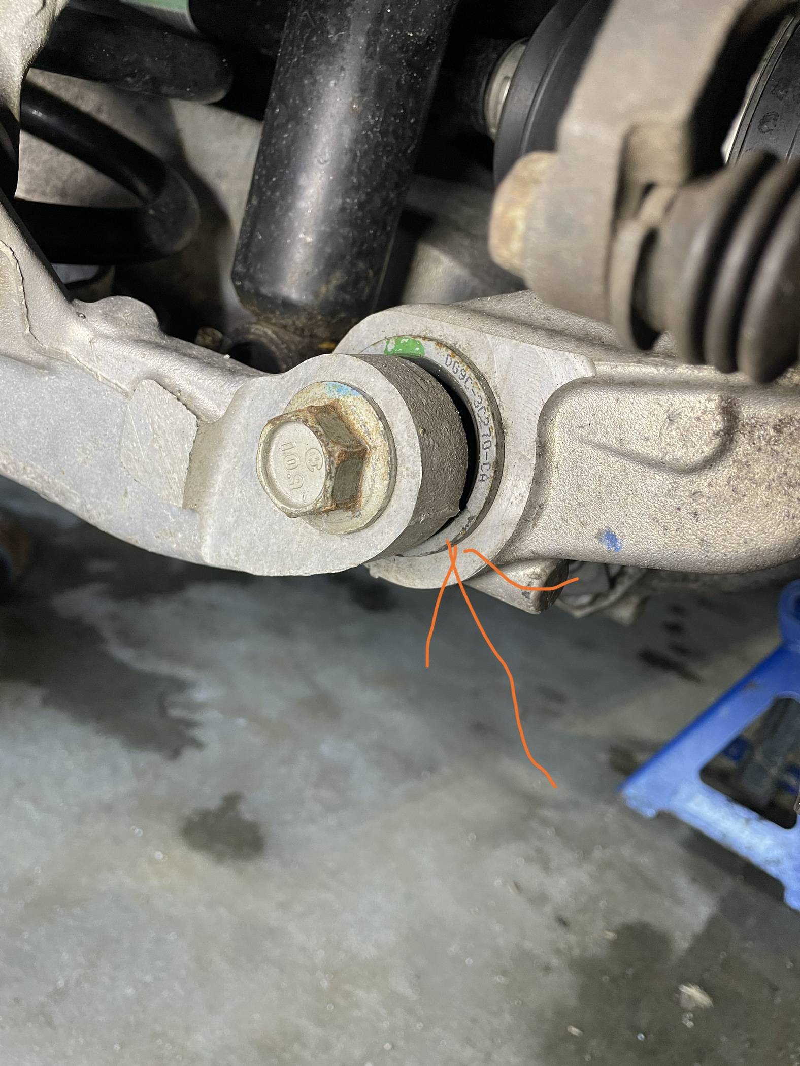

My personal experience was that the FP toe knuckle bearing made the biggest change in the response of the IRS. The stock toe-link has a binding rubber on both sides of the joint. I had both replaced, and that was 2 of the 8.
I replace the vertical link also and that was 4 of the 8. I have replaced 5 of the binding rubber bushings. I would absolutely do it again.
