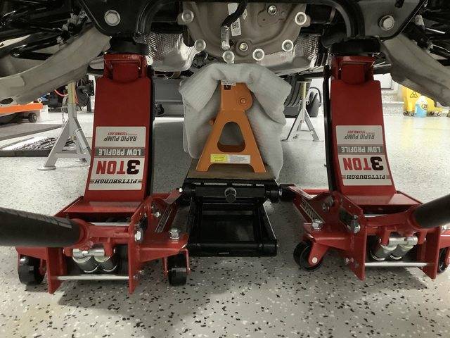

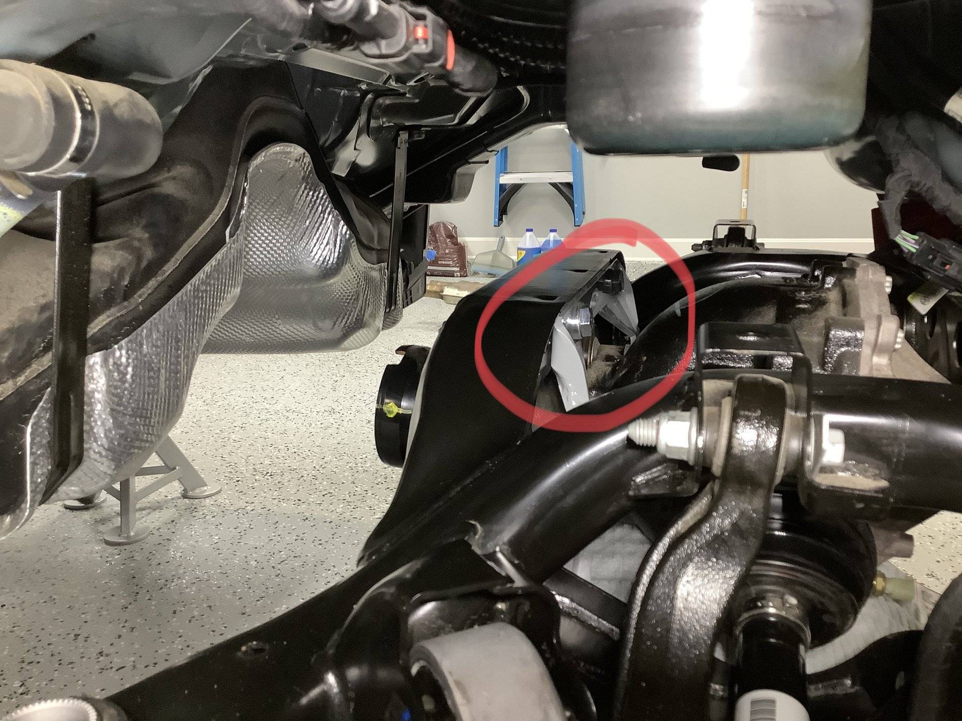

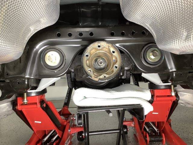

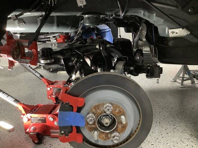

@jmagnus87, K4fxd beat me to it. Thank you @K4fxd! I was going to hunt for my pic, but those are really great pics.
@jmagnus87, it does require dropping the subframe to gain the necessary clearance to do this mod.
Yeah i did them the first time on a lift, gonna be a real PITA to do it without this time. But yeah I've dropped/lowered the subframe many times myself as of this point to do the jobs.
trying to re-align the bolts with the alignment bushings is a real nightmare when you have to pull the cradle all the way down. But I'll likely try the black bushings and the differential plate next, that seems like a good addition to the Steeda line up for my car. I just really hated the spherical bearings in the LCAs so hopefully i can go without those...
Yeah, it takes some jockeying to manage the subframe by yourself. I did mine alone too and on the ground (used four 6 ton jack stands about 21” tall) to support the car along with two floor jacks and a scissor jack (to support the diff.) while evenly lowering the entire assembly. Same thing going back up and I didn’t have any issues.
Best of luck to you in getting everything sorted out the way that you want it.
I dropped mine last year but did not lower it all the way out.
A thought that occurred to me is, buy some threaded rod that you can wind into the 4 or even the 2 diagonally. Run the rod through the cradle up into the bolt holes to guide it back up as you jack it in.
Just a thought for everyone, that need to drop it out alone.
