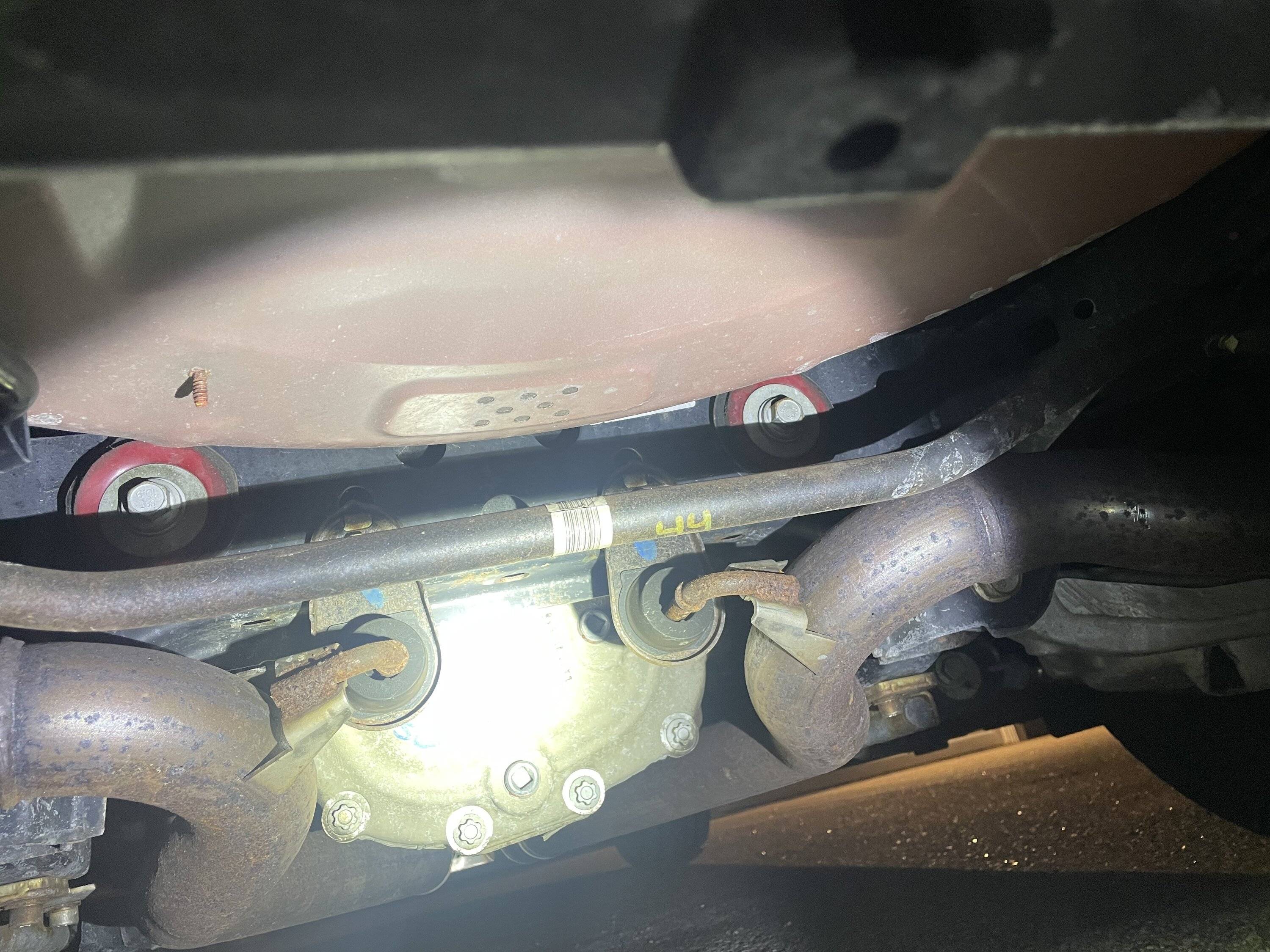

Update: working with Steeda tech help to see what they think.
looks like I'm going to have to spend even more money to fix it, the BMR762 kit looks awfully intriguing.
Just tried a launch this morning on Continental EC DWS in the wet and it still hops. Ideally, i just want them to break free until they grab like my 98 GT did 🤦‍♂️
I have this kit on mine. See signature. Since I installed it and the other items, I have not experienced hop but one time. It was during a 1-2 shift. Granted it was a hard 1-2 but I suspect that it may have been more related to the road surface as all around here are not ideal. I only have the diff bolt upgrade kit with no bushings. Car is going up on jack stands for more mods and inspection next week. Diff bushing inspection is on list of to do's.

I'll bet you have a torn bushing or 2. I have Steeda's stop the hop kit and get no wheel hop. Mine used to hop on take off and 1>2 shift.
Now it either spins or hooks up.

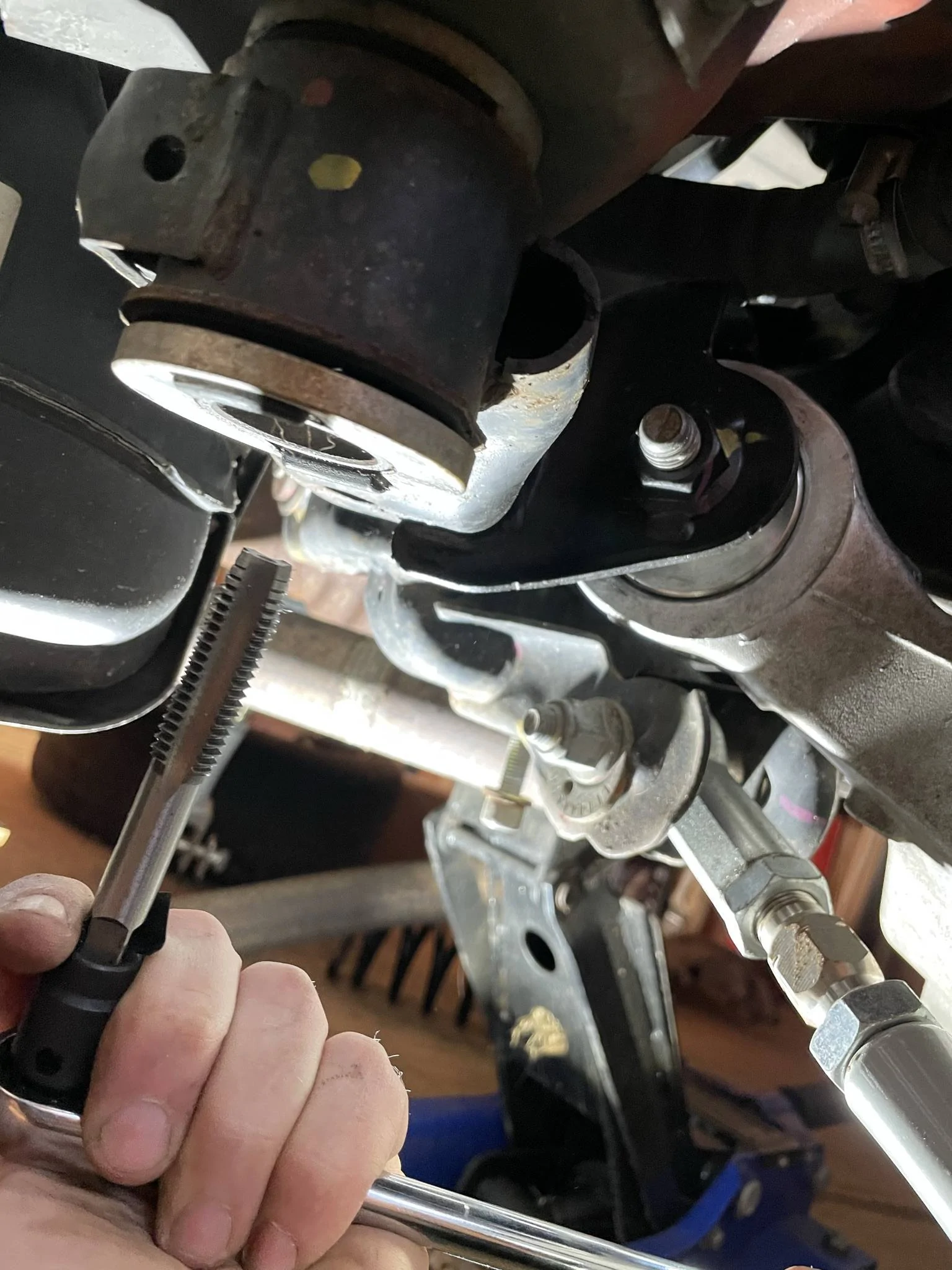

I dropped mine last year but did not lower it all the way out.
A thought that occurred to me is, buy some threaded rod that you can wind into the 4 or even the 2 diagonally. Run the rod through the cradle up into the bolt holes to guide it back up as you jack it in.
Just a thought for everyone, that need to drop it out alone.
This is a good idea for sure. The only thing i will say is trying to find said threaded rod may prove difficult. Might need to buy 4 new blue bolts and cut the heads off them. It took me quite a while to find a tap to rethread my unibody after trying to put the 4th bolt in under the tension of all the bushings and such. Needed a ratchet strap to the front of the frame to get the 4th bolt in last time i did it.

Mine has done this since brand new in '15. I had a bear of a time getting the bushings out of my factory control arms, had to use a sawzall to cut out the factory bushings then hammer and chisel out the metal ring on the outside and it STILL didn't want to peel itself out of there. Had to drive it out with the hammer and press combination the whole time.
then i bought some used factory LCAs because i hated the spherical bearings in my car and those bushings appeared to be fully intact too.
But if you mean that i have a differential bushing torn then the red polyurethane bushings aren't doing their job at all lol
Have you got the cradle bushing inserts installed? IRS braces?

Yes the red bushing inserts are installed and the steeda irs braces. Everything in the ultimate kit and i even had the spherical LCA bearings. The Continental tires i have on it now i can only hear the hop now, can't actually feel anything inside so that parts nice. The Michelins were very violent with the hop
