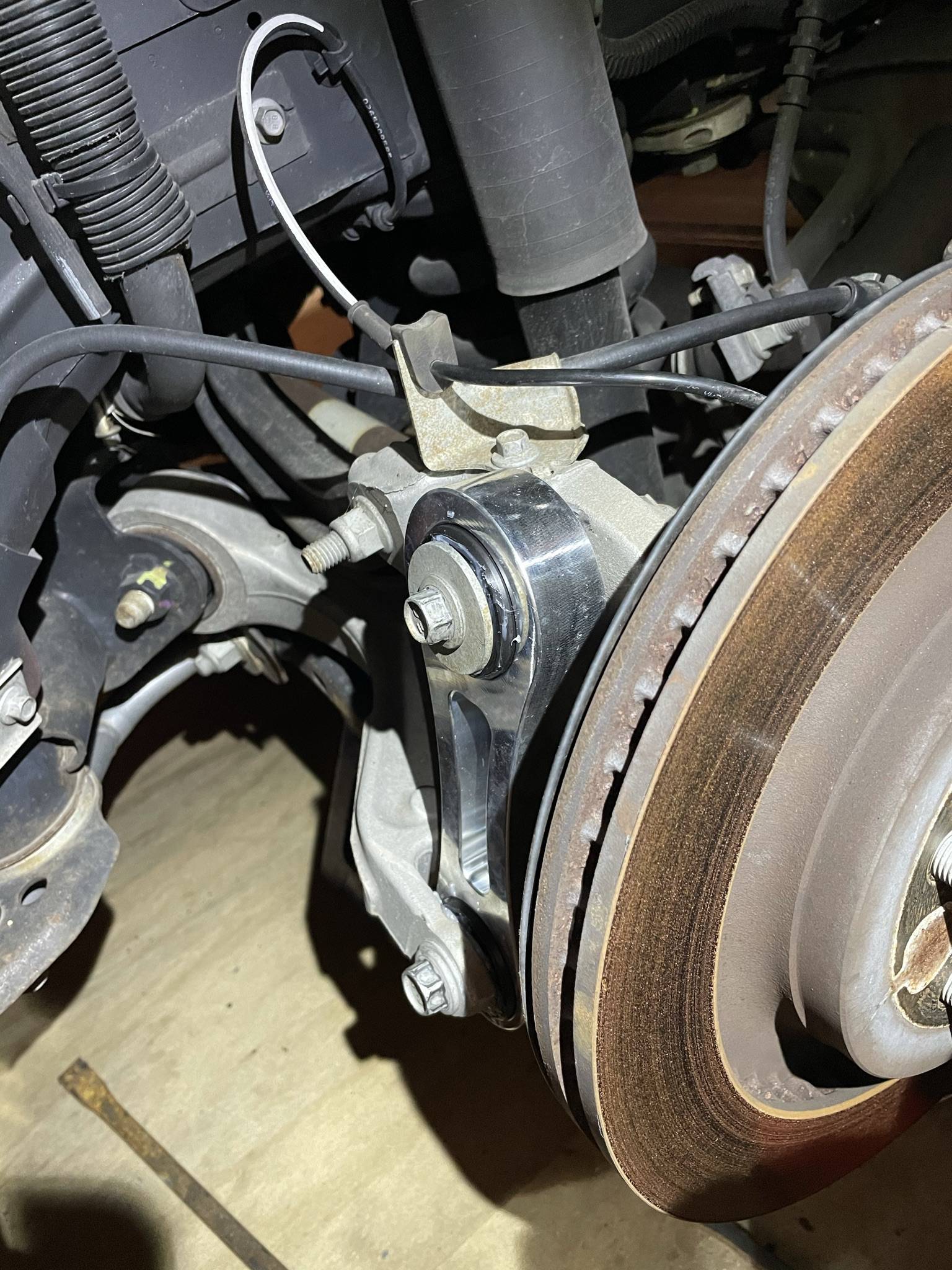

Vertical links.
I have the full on Steeda stop the hop kit and I get no wheel hop. My ride has not changed either.
I did the kit one piece at a time and it hopped until I added the vertical links.

Vertical links.
What size tires do you have? Rubber band? Get some with a sidewall if you want a decent ride on crap streets.
these things here??
I have the stock GTPP tire sizes, 275/40R19 rear and the 255s up front. I wouldn't exactly consider them rubber bands...

vertical links don't do shit for wheel hop and if anyone gives you advice about this with that peppered in disregard them entirely.
I had the entire stop the hop kit installed except for vertical links and it hopped. After I installed them it stopped wheel hopping. Coincidence? I don't know but my car needs them.
