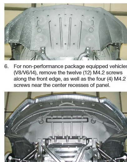

Found a picture from Roush's install guide with the differences in under car aero between PP and none PP.
I guess this is why the lips are not exchangeable. PP's aero is smoothed out and extended way back compare to none PP.

Because the PP pan channels air to the brakes.

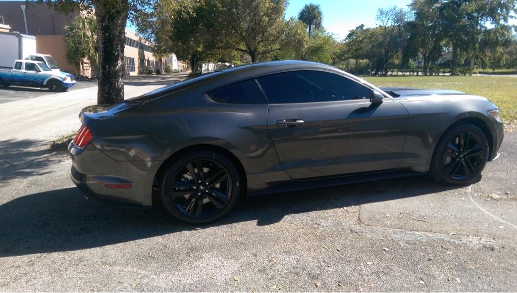

Besides all that the PP wheels are hideous and in black make them look even worse, not to mention they can be used for a boat anchor.
