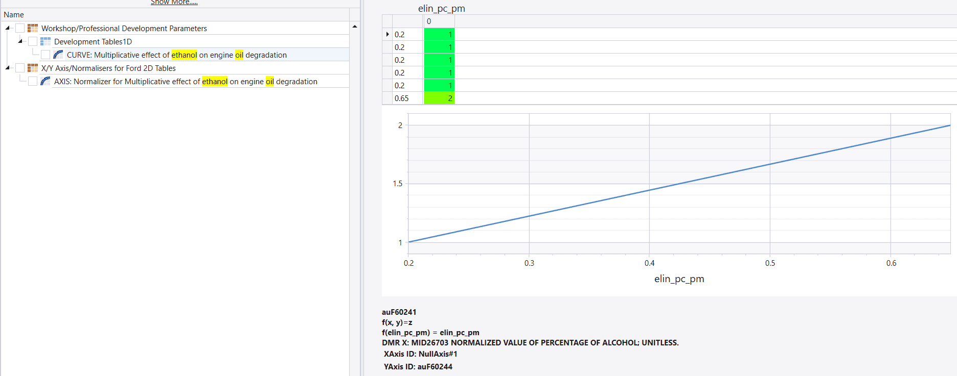

I will tell you that when I run E70 in the summer the oil monitor goes down twice as fast so it must notice the Viscosity change in the oil from E fuel
I mentioned this in post 14. If yours is a flex tune then it accounts for inferred ethanol content in the oil life calculation and it's a 2:1 ratio at anything over E65.

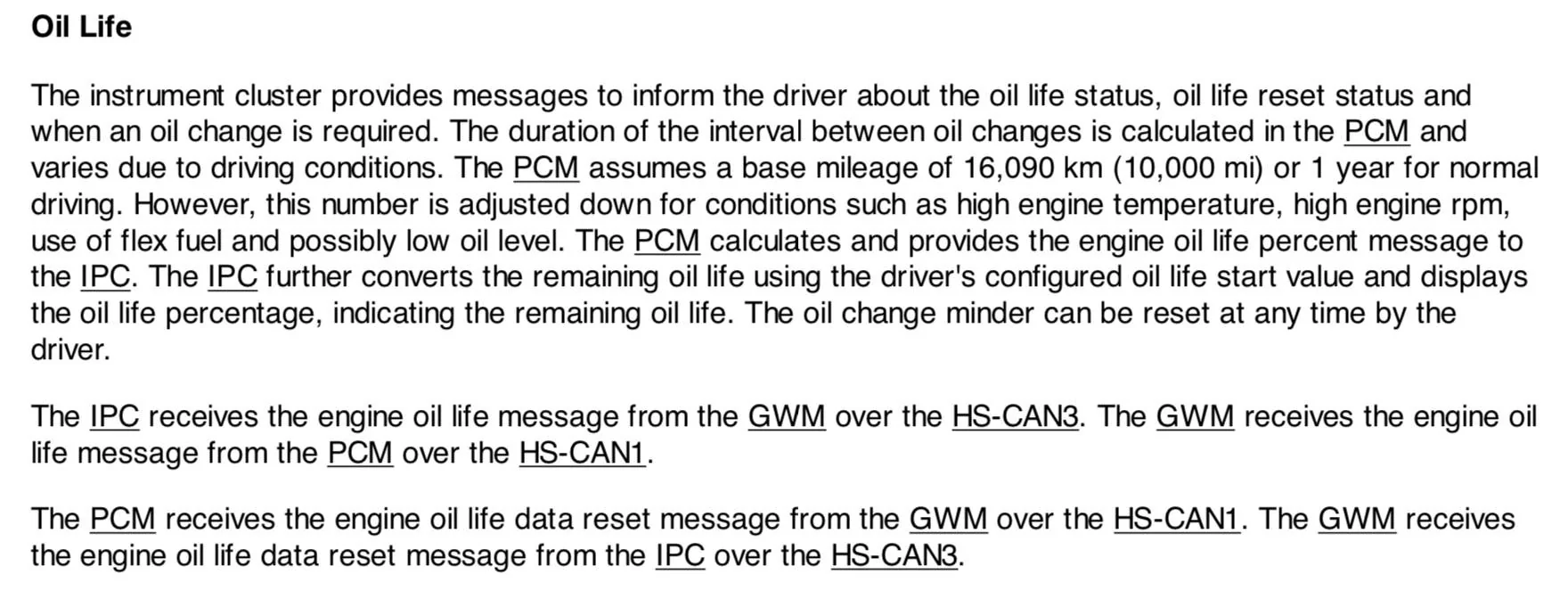

I’ve posted this before, here it is again for those who maybe have never seen it regarding OLM operation and how it functions, per the shop manual:
The timer also counts down as the car sits. So for those wondering why their Oil Life Monitor is saying you need an oil change when you have only driven 500 miles since last oil change BUT the car has been in the garage for 6 months consecutively... The above is your answer.
