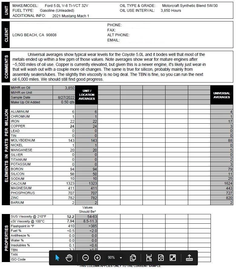

I changed my factory fill oil two weeks ago, it had about 3,800 miles on it. The oil monitor said less than 5% of life left. This factory fill oil had two track sessions on it.
Here is the report with my PII removed. I refilled the car with Pennzoil Ultra Platinum, I'm trying to keep the boron counts as high as I can.

Are you satisfied with the report, it reads well
To be honest interpretation is beyond my expertise. I'm very happy to hear you say it reads well.
I was mostly curious about the factory fill Boron counts, as in previous postings it seemed that the factory fill contained more Boron than off the shelf motorcraft oil, leading us to the suspicions that Ford is putting extra additives in the factory fill (a lot of manufacturers do). A lot of people with engine ticks reported them right after the first change, adding to our suspicion. My Factory fill Boron counts are not nearly as high as another who reported, out of Germany I believe.... So we take that for what it is worth. By posting if this helps the community I'm more than happy to lend a hand....
I have always maintained that I can't empirically prove high borons will prevent the tick, but I had a friend who used Ceratec which is known to have very highs boron counts (among other detergents) on a 5.0 and his tick went away immediately, and stayed away. It was an amazing difference believe me.
An interesting side note, while I was at Ford's Track Attack in Charlotte, some of the cars ticked, others did not. They were all low mileage from talking to others. My car for the day had 1,500 miles and no tick.
For context on my report, I strictly adhered to break in procedures. I even went so far as to leave for my destination early to ensure I was always bringing the car up to temp. During brake in I did exactly zero short trips, all were 20 mins plus on purpose.
After brake in I ran two track sessions at two different tracks, both are high speed and high rev. I also had a pretty aggressive canyon drive of a couple hours. After brake in my longer highway trips 1-2 hours, were at 65-75 mph, mostly low end of that range to see max MPG I could get. I topped off with .5 to 1qt of Motorcraft Syn blend during this interval.

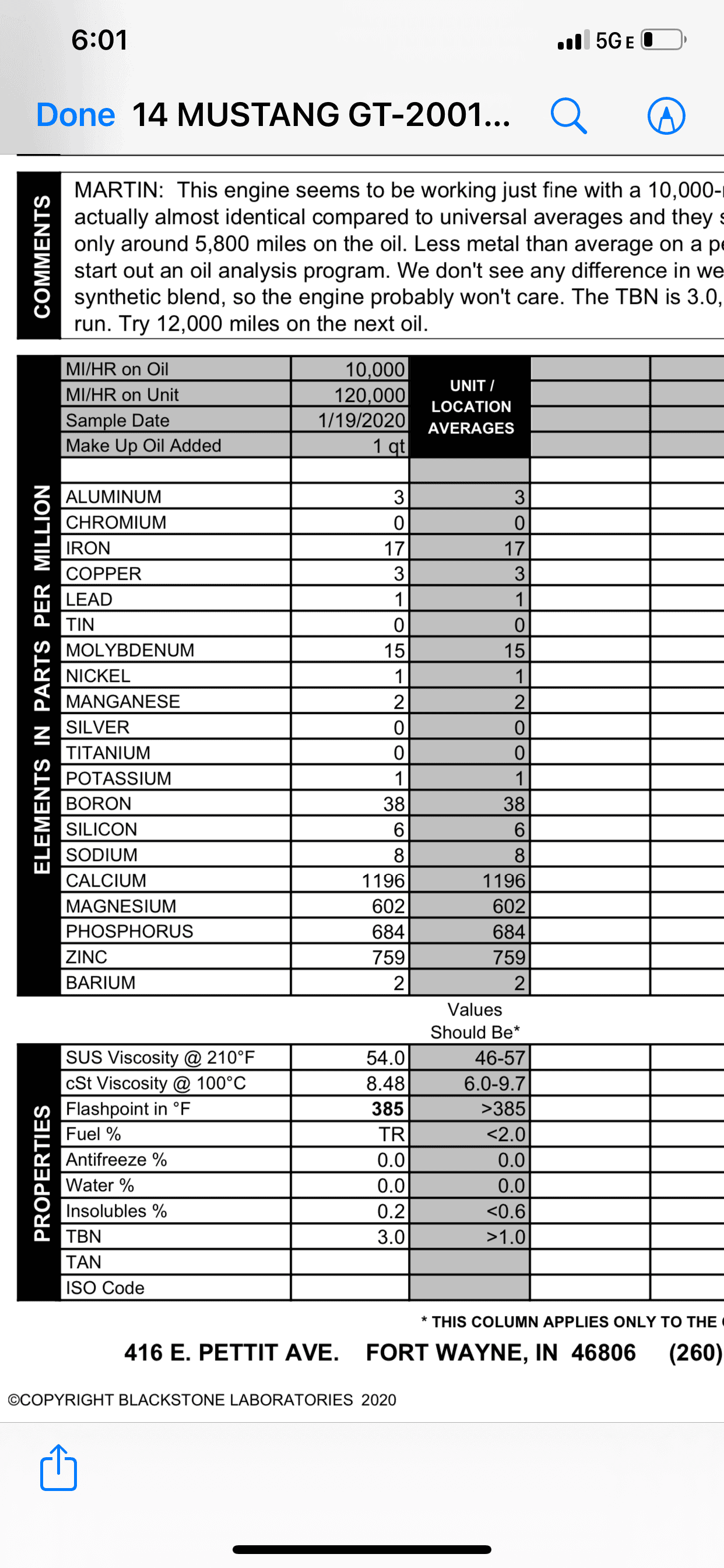

My 14GT had a tick ever since the first oil change. Changed oil every 10k miles each time it ticked for about 1k miles then it would go away. Always used the motor craft synthetic blend. This was my oil analysis at 120k miles below:
