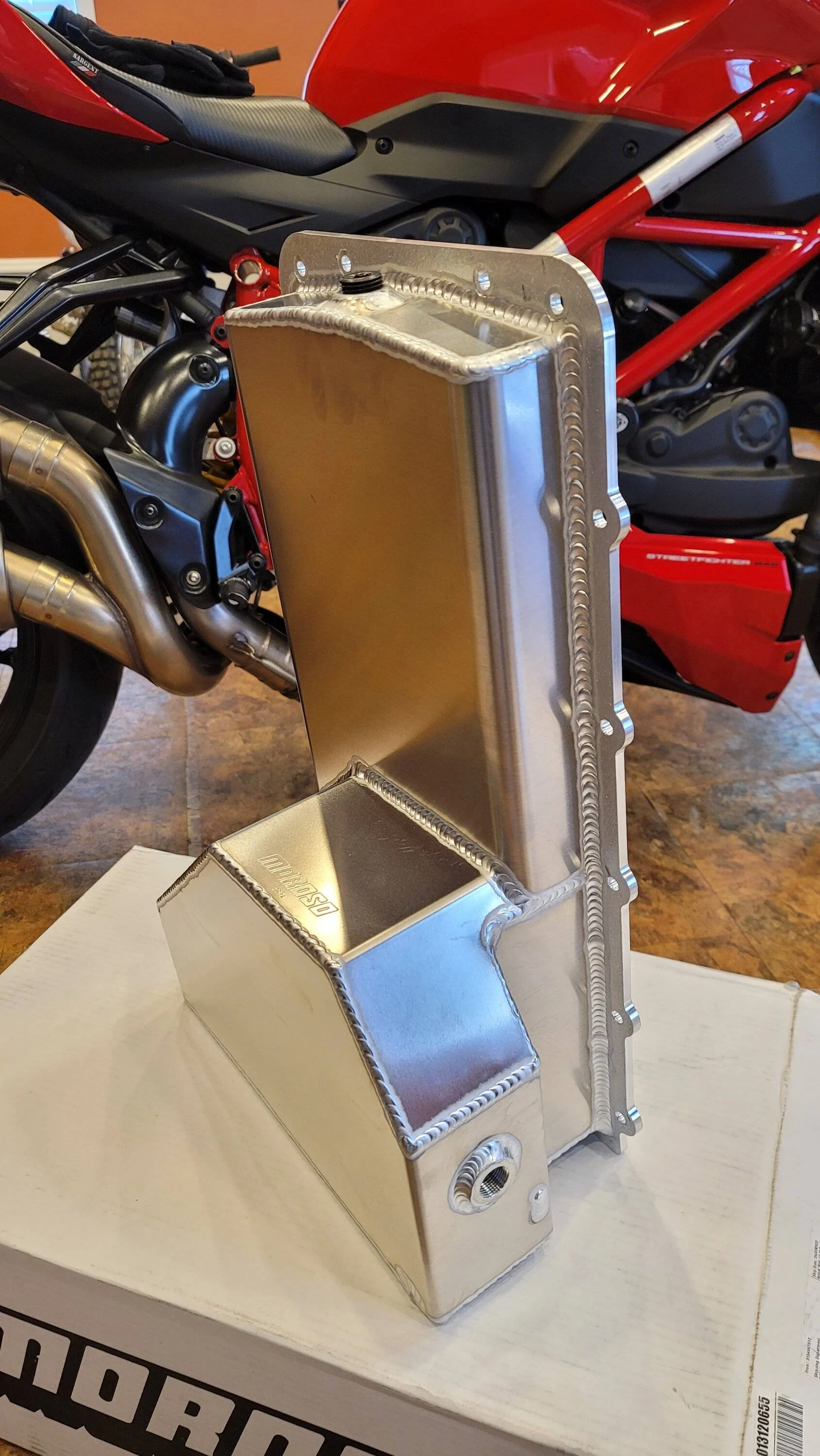

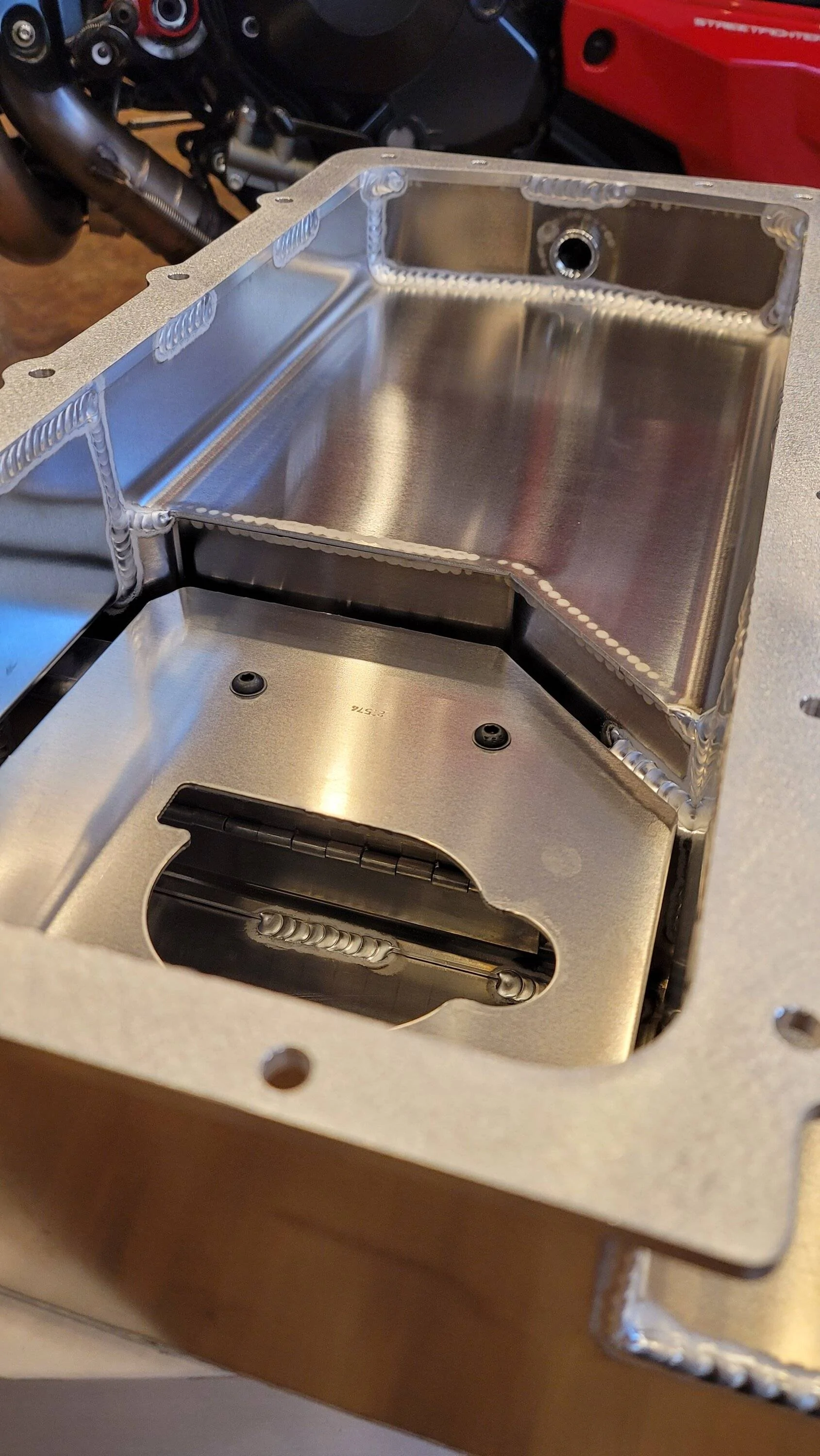

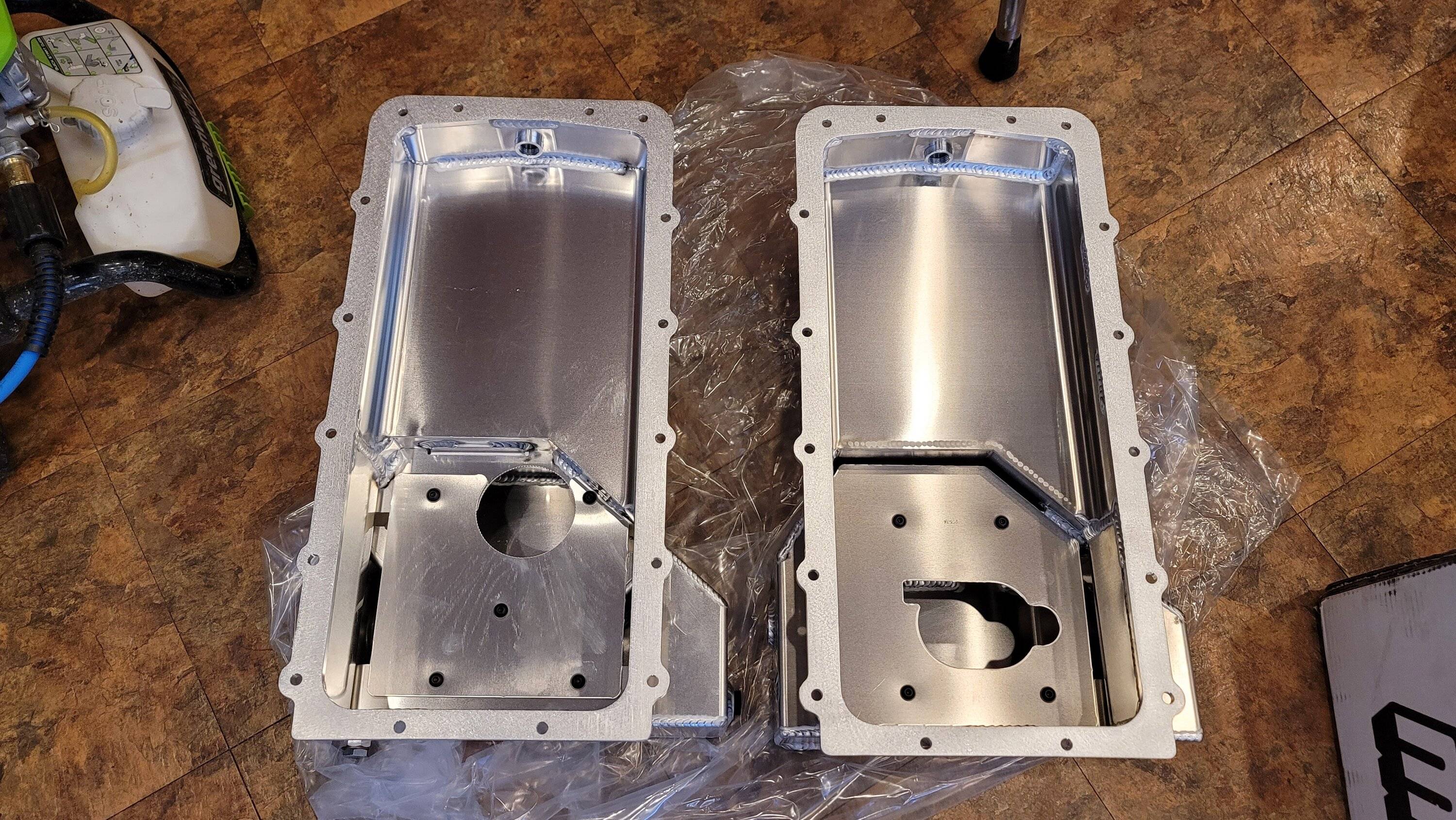

I have limited experience with the pan in question. I currently run the 20574 drag pan. When I ordered it, the 20576 pan was in the box. The 20576 is the aluminum version of the 20571 road race pan you are looking at.
The drag pan and road race are the same externally. The difference is in the pickup location. The drag pan has the pickup and baffling at the rear of the sump, the road race at the front of the sump. The fit and finish is excellent on the aluminum version, not sure on the steel. Pan is same depth as stock, although wider at the sump. Zero clearance issues with larger sump, plenty of room everywhere. RR pan on left, drag on right.

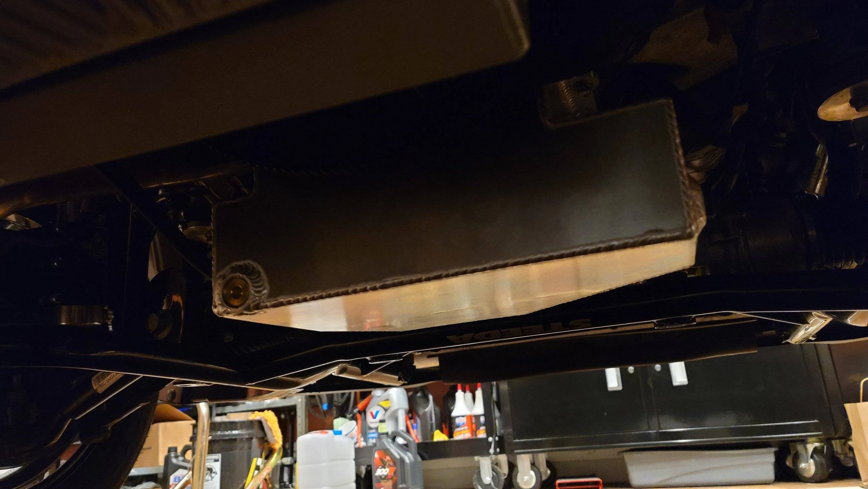

The drain plug appears to be located fairly high…probably won’t make a difference in draining when cars up on ramps.

Drain looks fairly high on the pic I posted? That's the oil level sensor port...
